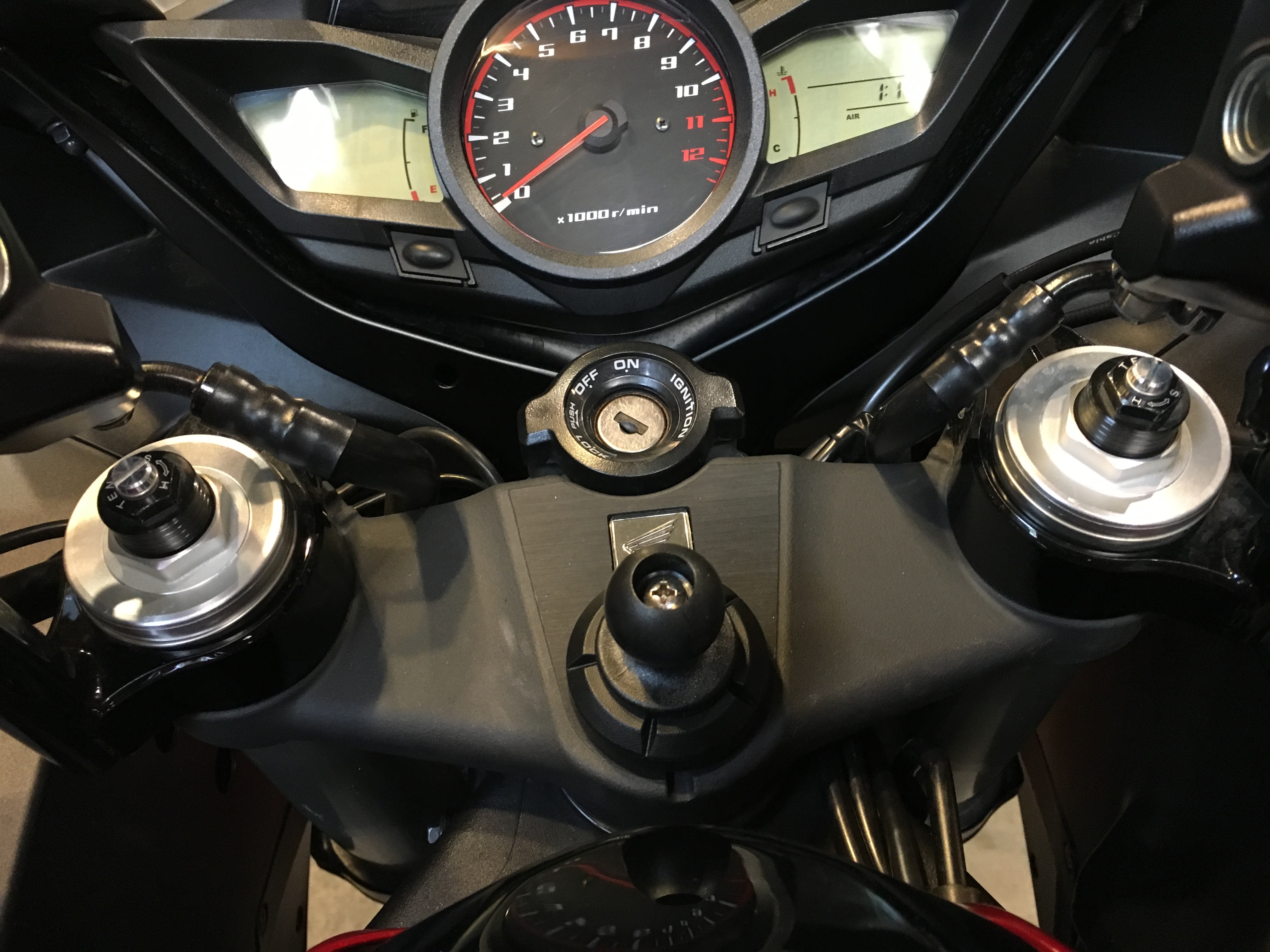

DrSteve, VFRD member Huntinggunns makes a great RAM mount that mounts (rock solid) in the steering stem. See the post a few lines below yours in Equipment and Gear.
I used this on my recently departed 2010 VFR1200, its great!

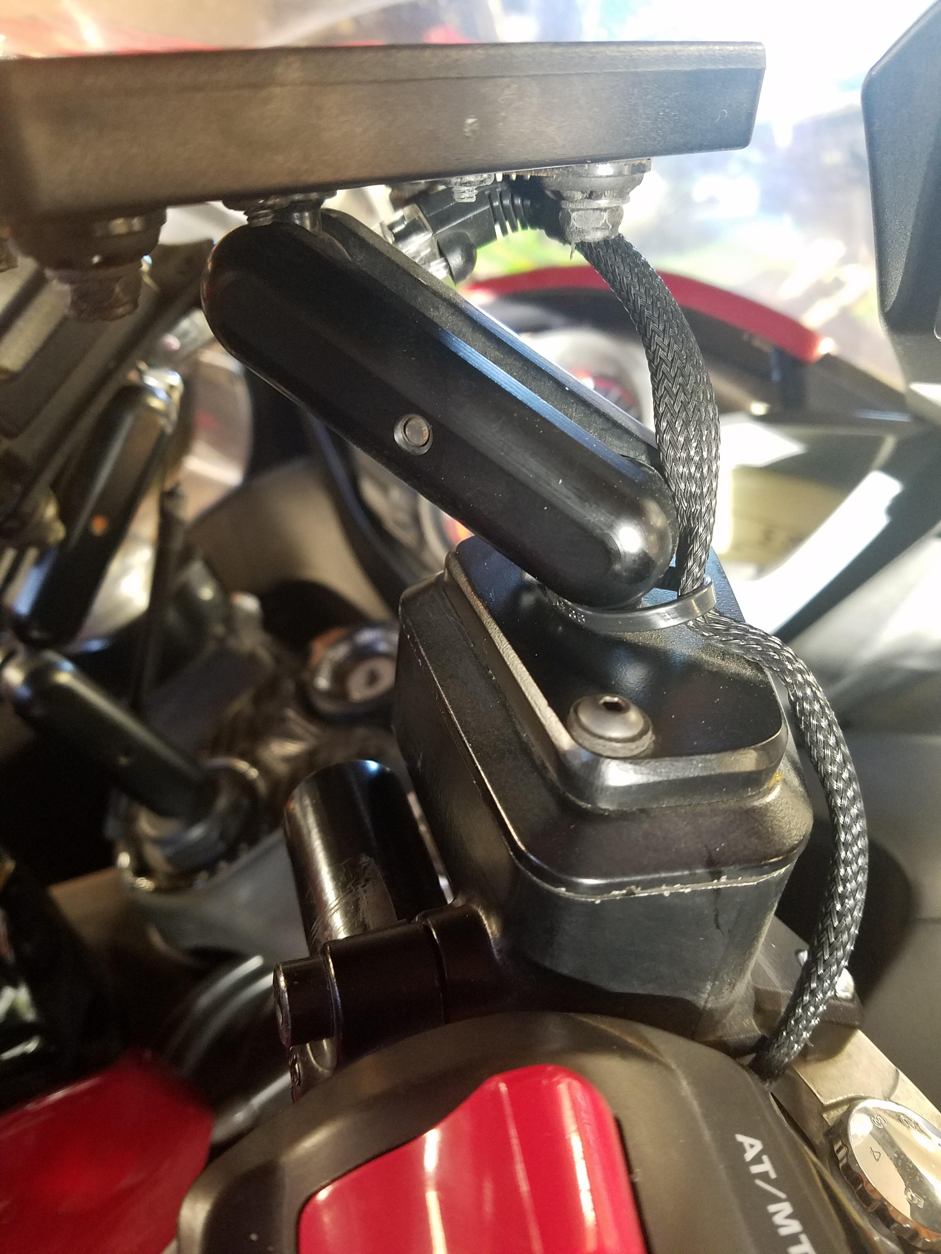

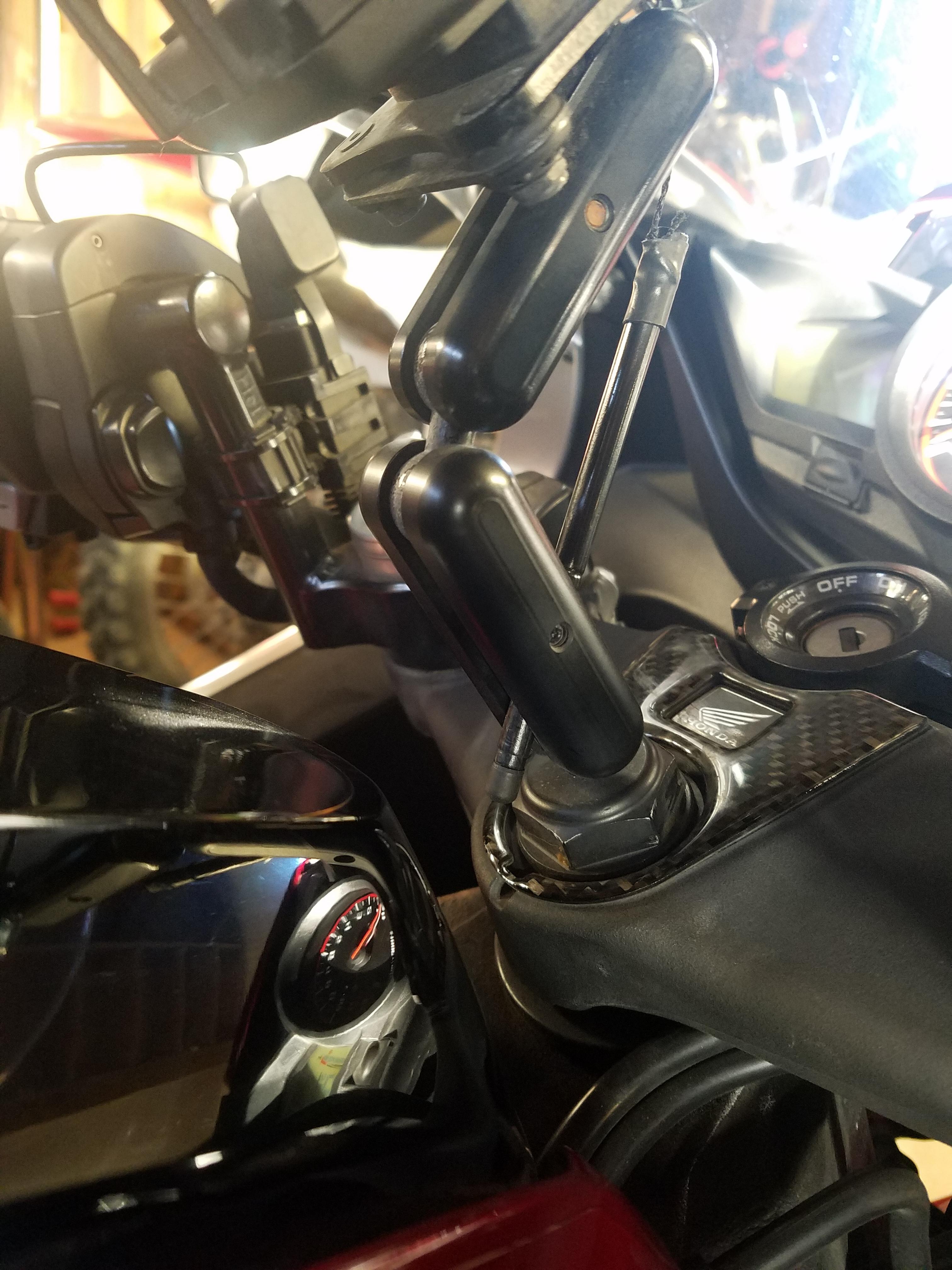

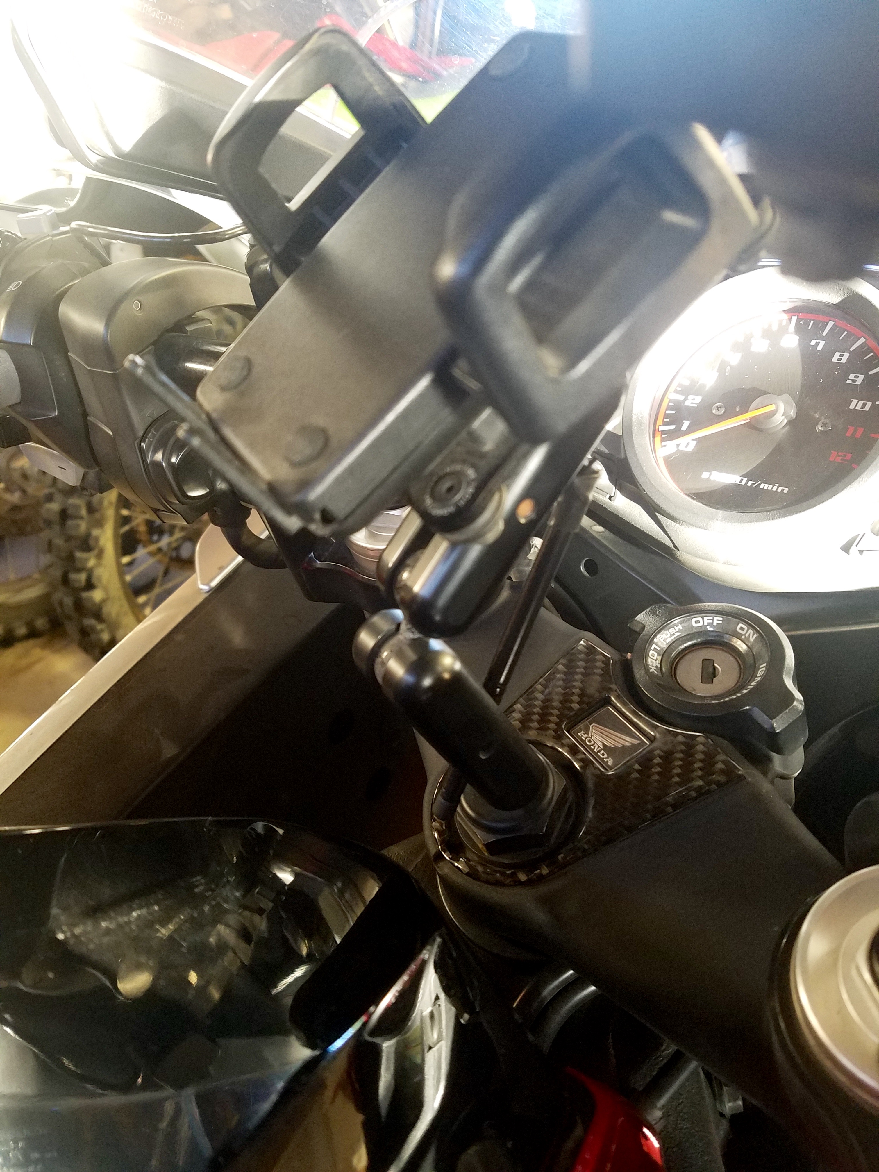

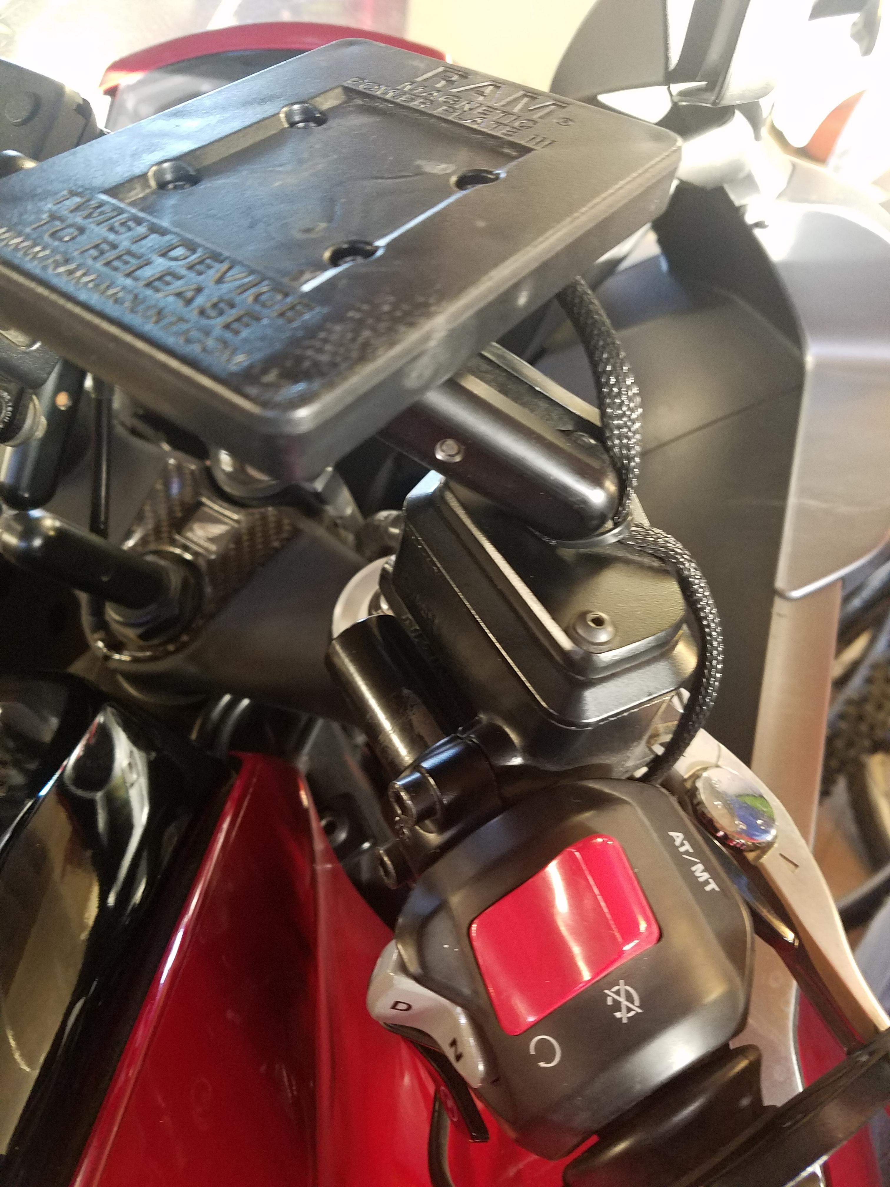

For brands, you can go with RAM, Techmount, or Adaptiv brands.  Personally, I chose the Adaptiv mounts because I thought they looked cleaner without the big thumb screw on the side, and I figured I'd adjust once and forget about it.  A few tips though, disassemble their ball mount and use red Locktite on the mount screw, or you will later.  Also, they use a steel clamp screw...it rusts.  Replace with SS.  Otherwise top notch.  Below is my setup...stem mount for phone (GPS?), reservoir mount for RD.  It's all adjusted to allow sight of the instruments, though the stem mounted phone does obscure the lower portion of the tach.

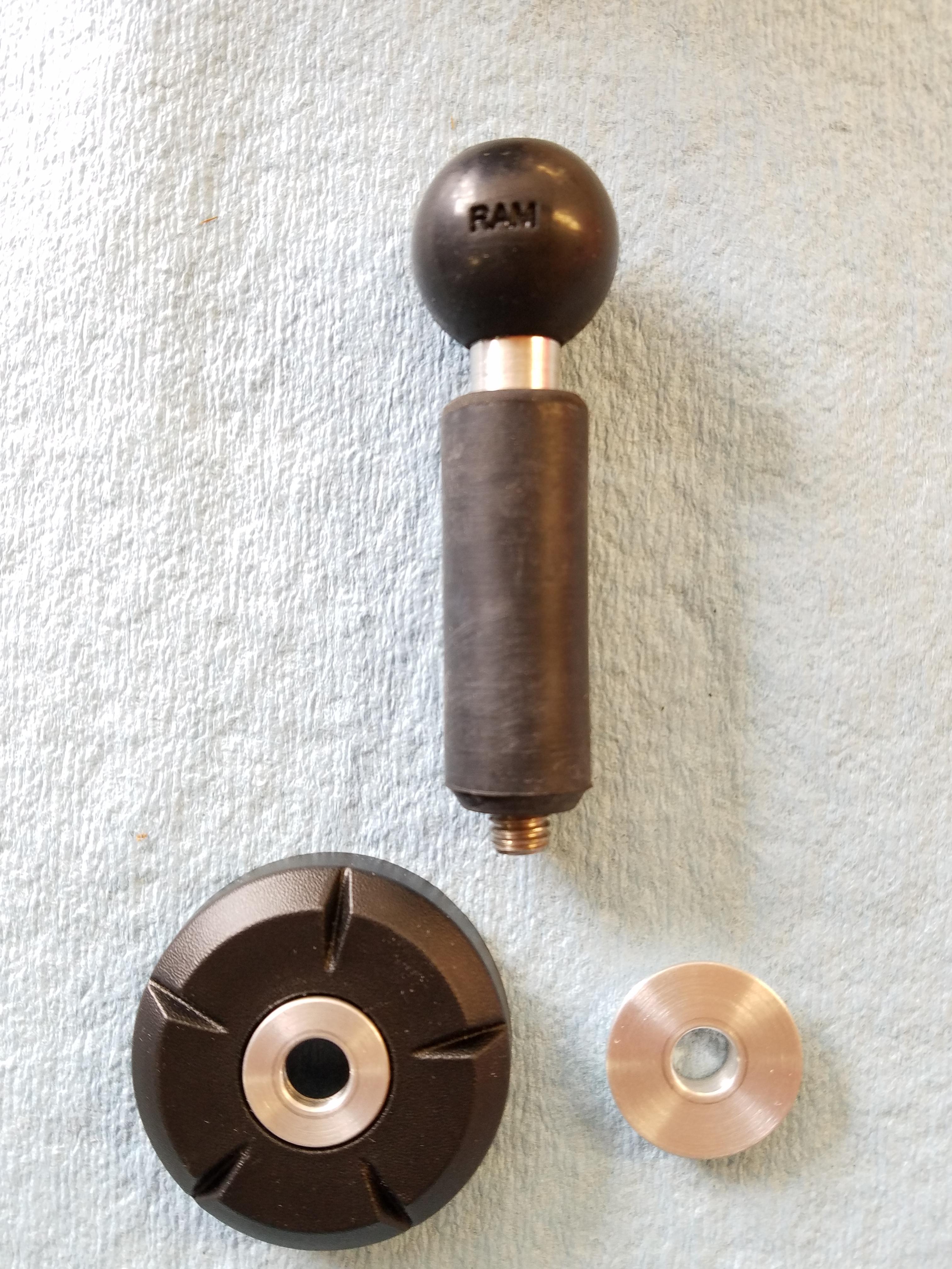

if you prefer the RAM mounts, I can make you a great deal on a custom made stem mount for the 1200.  It's the same unit mentioned by St. Stephen in his post.  Picture below.

Same exact one made by Huntinggunns.  Too bad.  Would have sold it to you for half price, and it has never been used.  I went with the Adaptiv stem mount after our own Luvtoleanit vouched for the brand.
