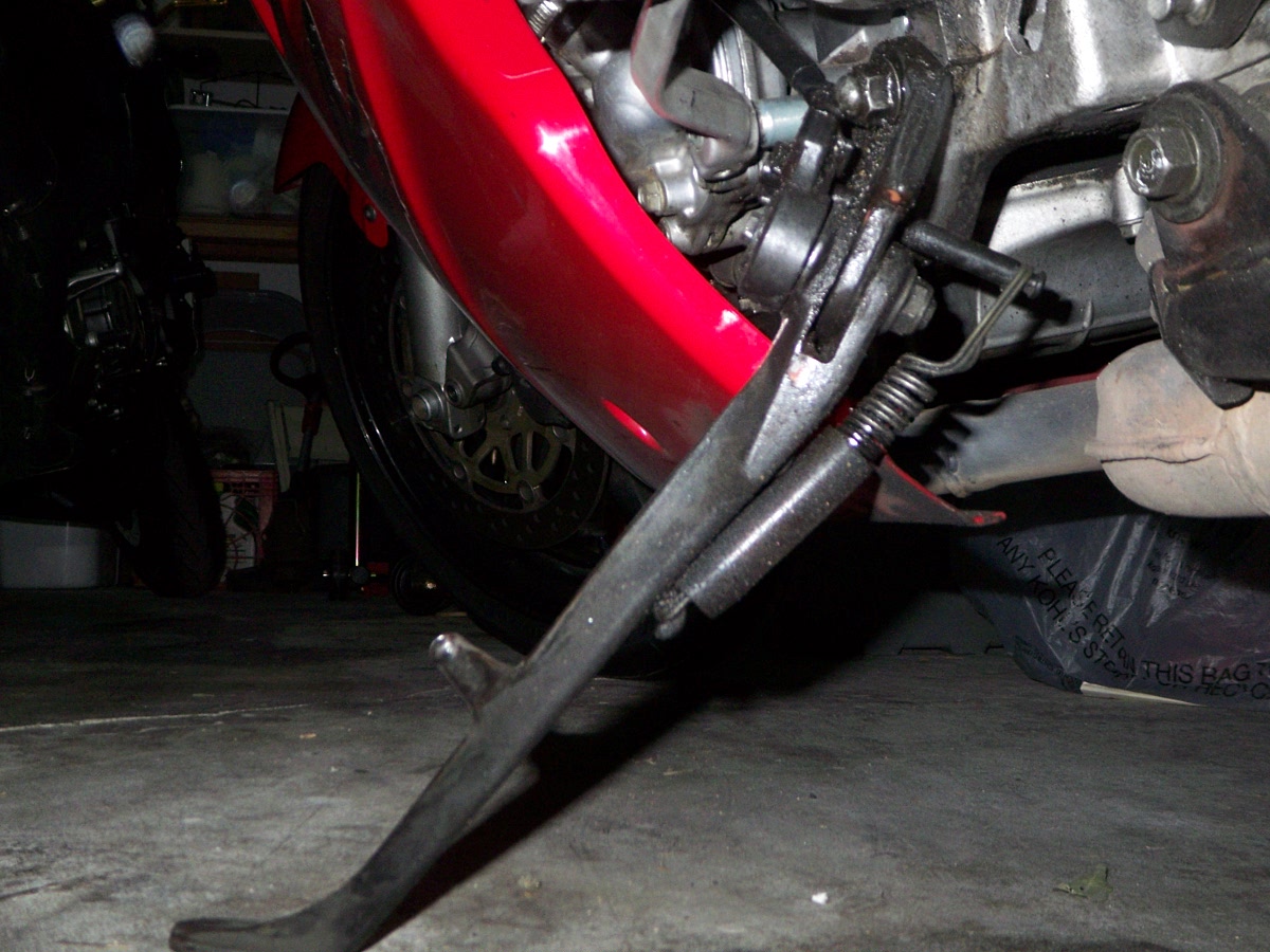

Thanks for the photo! It seems all I need to do is connect the spring, though it is almost as the spring is too long, and or the hooks are not facing the proper direction. Reviewing the service manually, I see this https://cl.ly/440J1r1x3l2z  but man would be rad to see the other side/breakout.
Blargh, I am sure I am just missing something stupid/simple. ?
Hey wesburke, I wonder if your spring might have been messed with, before you got the machine. Yours shows the upper end in the photo of the spring is split. My spring, having never been removed on my current ride, has that end of the spring tightly side-by-side to the end.
Here is a link to the fiche showing the exploded view of the parts. Hope this helps. As I recall it was tough for me to stretch the spring into position. I'm not sure I remember if the sidestand was in the up position when I reinstalled the spring but I think the spring would be more relaxed in the up position allowing for a shorter pull.
