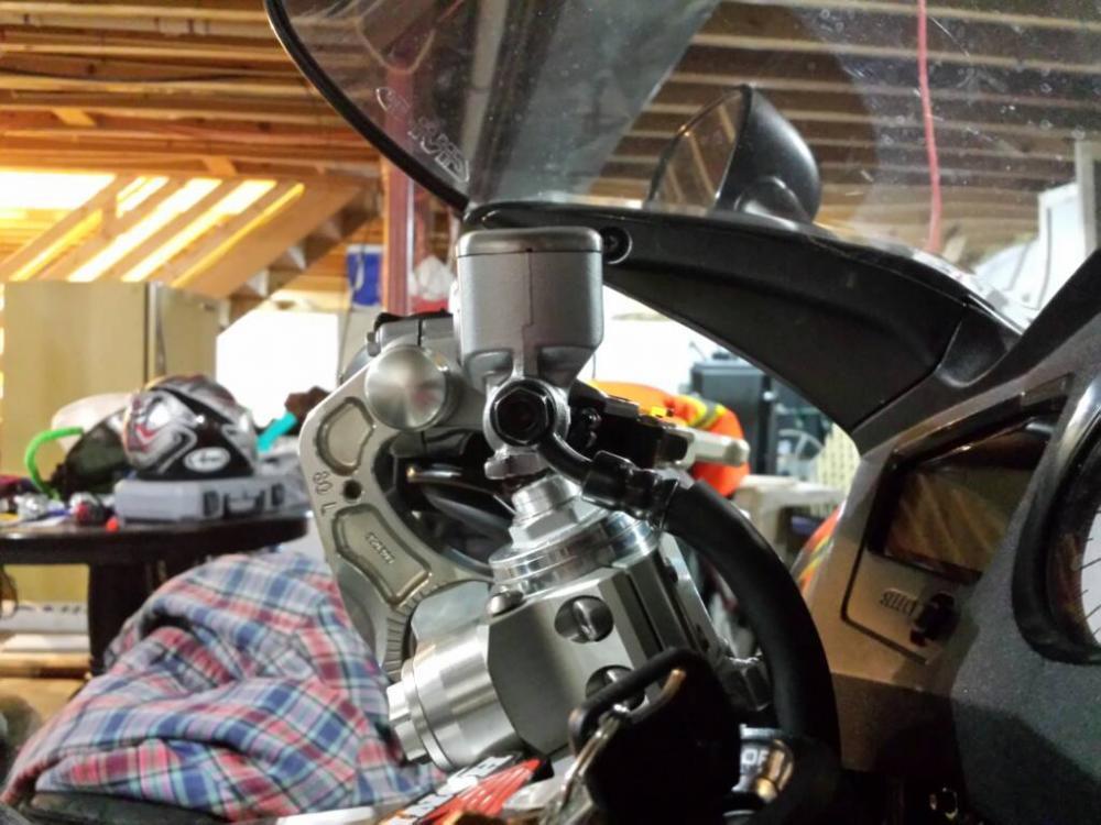

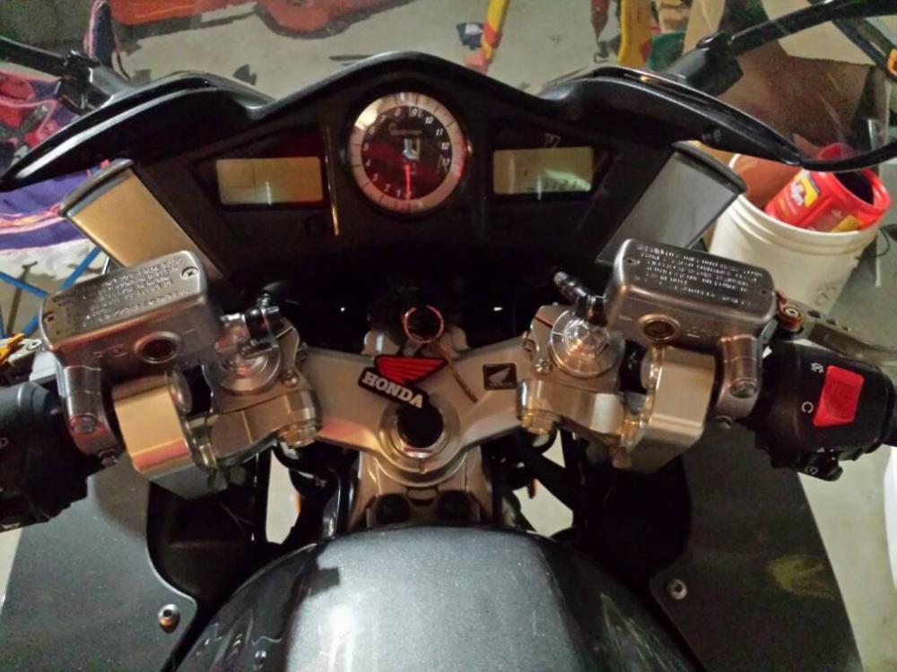

Thanks for the links. Working on it a little tonight. Thinking the po already put longer lines on. I can probably go 120mm with the slack I have. I snapped a few photos. Ill try to put those up soon. Still need to get a second set of hands so I can dremel off the ears and ill be in business.

As you're looking at this picture, is the left stock? And the right Variobar?

Sent from my SCH-I545 using Tapatalk
Yes you are correct. I have put the variobar on the clutch side. There is still adjustments that I can make but this give a good idea of what the 80 mm riser will do for you.

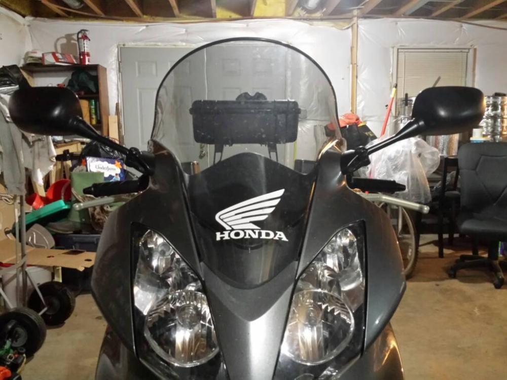

Posted (edited)
Got them done. Still need a good road test. Cut the ears off and then it all went like butter. So far very happy.

They look great and your pics will be a big help for me. Any tips or gotchas you can give on the install would be appreciated.
Judging by the reversed mount they look like you also probably shortened the reach required which is what I'm also after.

Just took her out for a test ride. Now that my hands are in a different position it will take a few rides for my muscles to adjust and that is to be expected. I am definitely more upright and in a more relaxed balanced position, its much nicer. Now for the most suprising plus. The bike feels 100 lbs lighter and is 100 times more flickable. With the bars up more I am not leaning over so far and carrying my weight on the bars and I dont feel like im pushing down on them and making the steering heavy. I cannot wait for some good backroads to really give it a run. I am very glad this topic and post got started. To think I almost sold these things.
