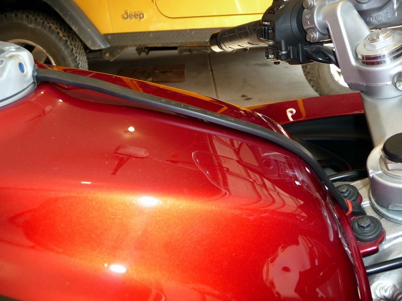

This is the way I ran the power cable, I stressed over the electric option because it would sit on the tank but I went ahead and got it anyway. So far I have no marks from it on my tank.
I ran the wire under the tank this way so I could still raise the tank if I needed to. This will still be a pain if you need to remove the tank completely so keep that in mind.

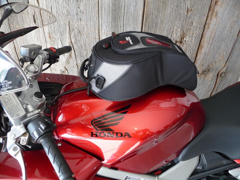

A couple of shots of how it looks.

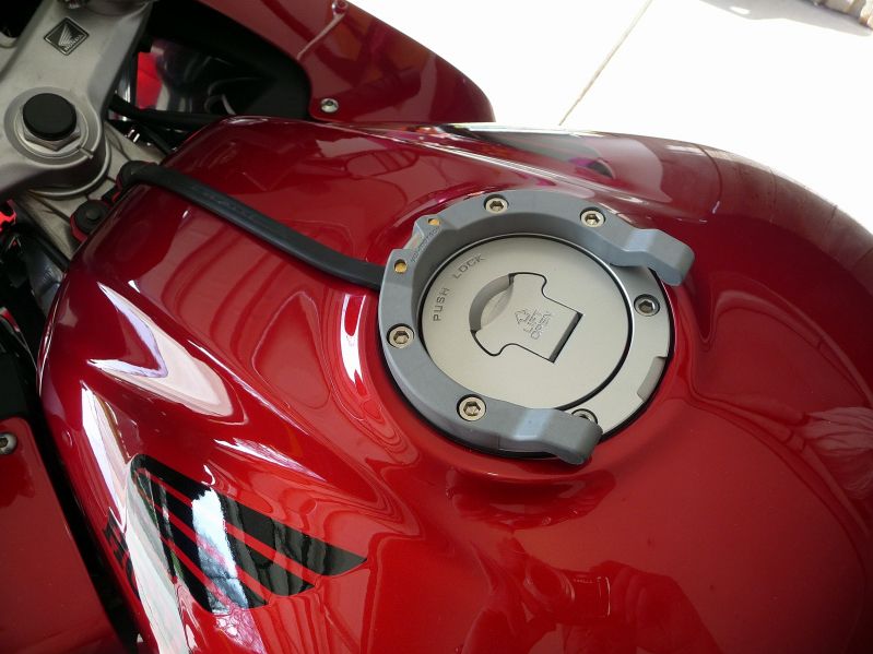

A view from the top with no bag mounted, this is how it will always look so keep that in mind.
This shows that there is indeed no power when the bag is not mounted. There is a switch in the mount that activates when the bag is clipped on.
Bag mounted, we have power.

A few pictures of the bag mounted on my bike, I hope these help as I could find very few pictures of the bag mounted when I was looking for options.

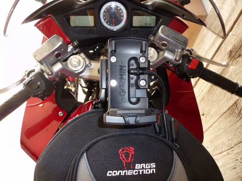

Now, for one of the biggest reasons I went with this setup, the GPS bracket. I had to bend the bracket to get it to sit the way I wanted, it is not perfect but it works. I had tried a stem mounted bracket for my GPS, had nothing but problems, I hated it. I really didn’t want anything, the size of my GPS, mounted to my bars, another reason I went with this.
The bracket mounted to the bag.
My view of the bracket, I ran the power wire through the zipper in the top lid. This is one of my complaints of the bag, no wire pass trough’s. The newer version of this bag has them, I know I can get one from Powerlet if I want to make my own, I may still do this.

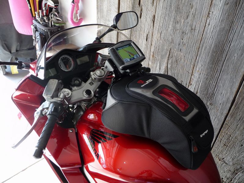

My view with the GPS mounted, it works quite well and doesn’t block my view of the dash. My only complaint is that it puts it a little close to me when I am riding, it works for me so that is all that matters. With the newer, smaller, lighter GPS’s out today this would work even better.

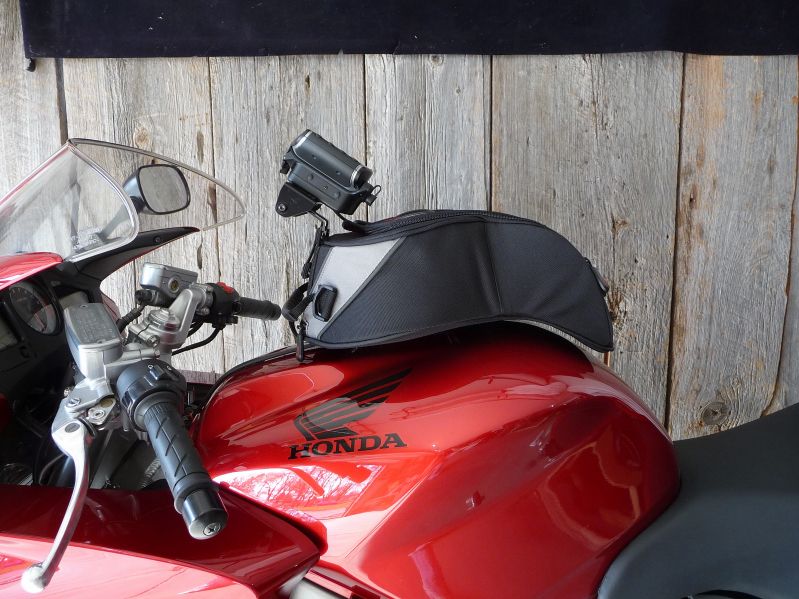

A few more pictures of the whole setup mounted.
One really nice feature, and another reason I went with this, just pull the tab/cord………
……… and the whole thing comes off together. This is simple and clean, great for getting gas and when I am stopped for a break.
