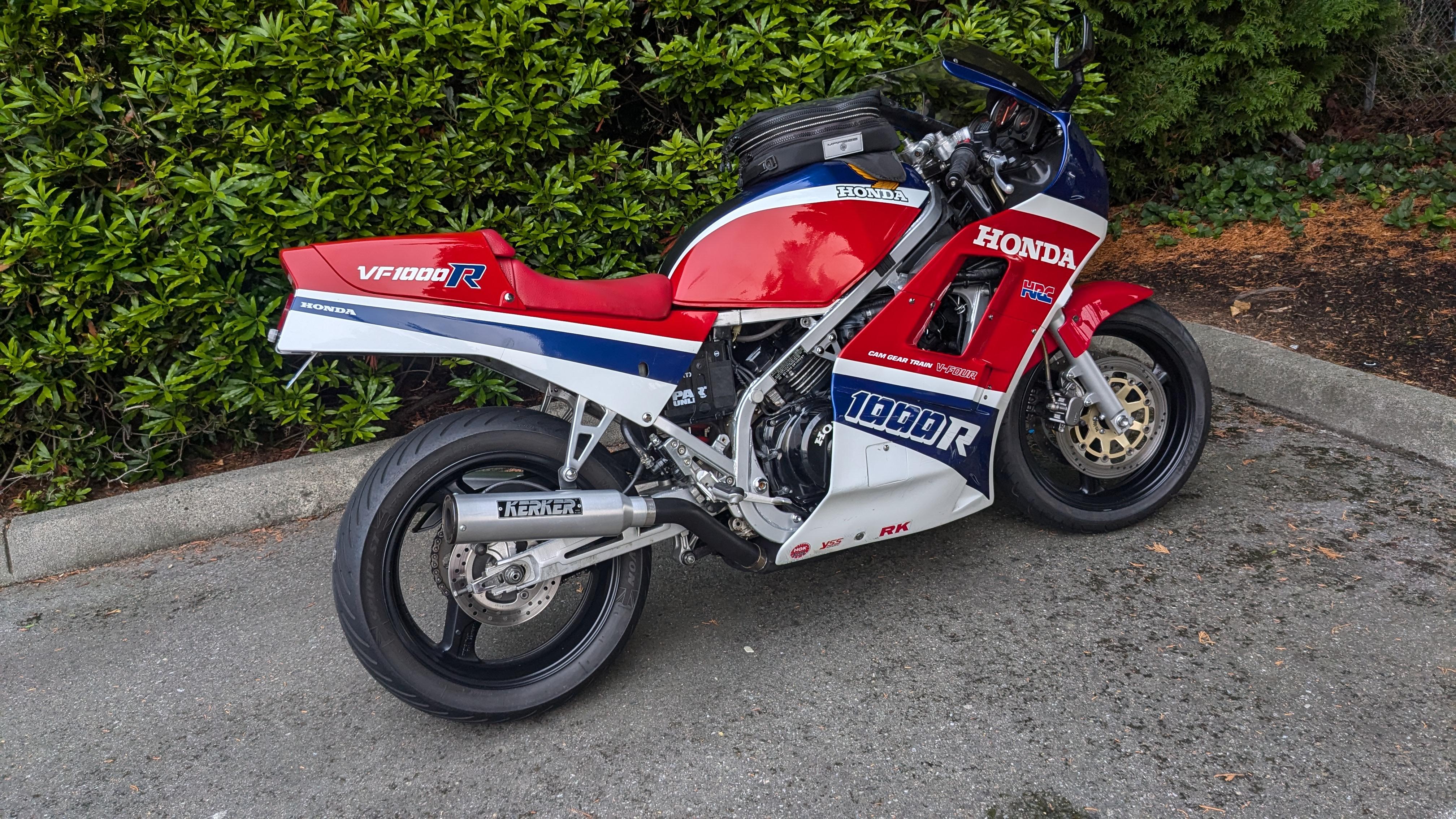

VTR1000F front wheel (to match the rear) with EBC rotors and a fresh tire.
Replaced the valve cover gaskets (they were leaking) and re-set the valve lash, most were pretty loose.  Had been planning to get in there sooner after rebuilding the bike and making sure it ran good and had all the gears.
Fresh coolant since I had to drop the lower rad and did an oil/filter change.
New brakes, wheel and tire feel great and the engine definitely feels crisper.
Oh and I removed and restored the exhaust system collector, it was the last real crusty thing on the bike.
