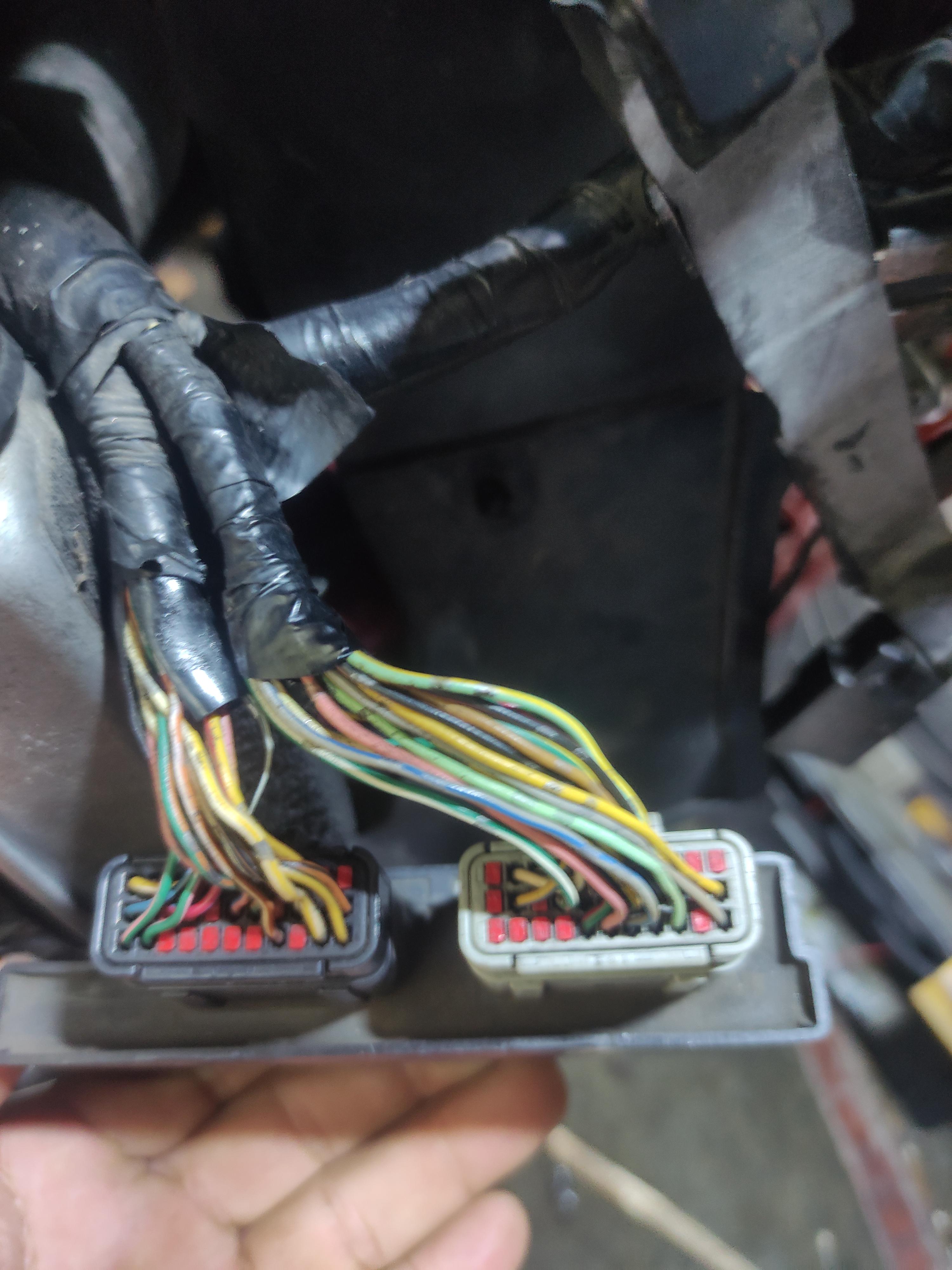

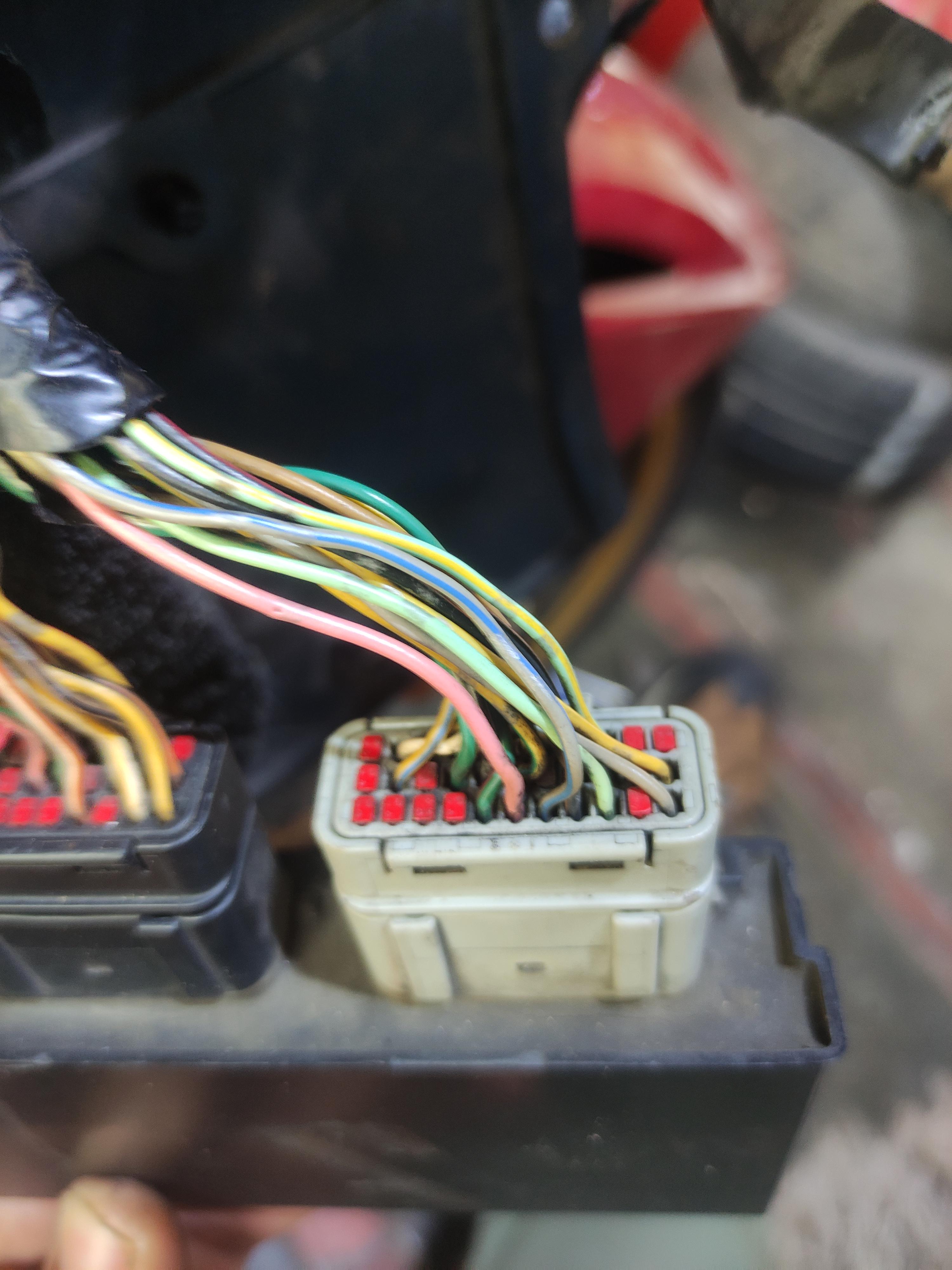

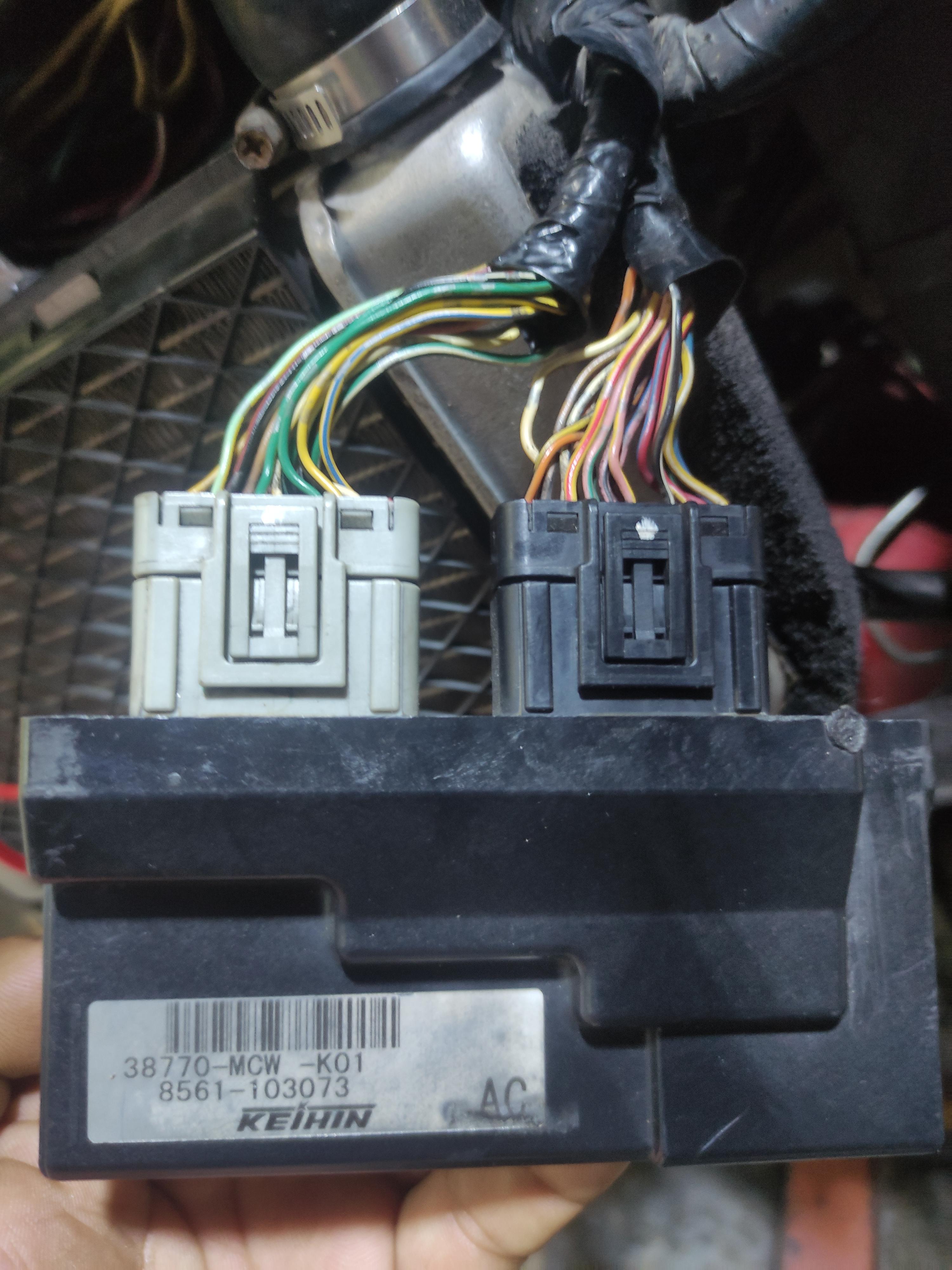

otidum Posted May 22, 2024 Posted May 22, 2024 Hi!! My VFR it's a us version, there's no HISS on the tachometer , I just changed the spark plugs, then my bike won't start , I checked all negative (ground)point, the Fuel pump works the first 2 second, when I started up just crank it up, I tried to put some gas on the injectors zone then the motorcycle star it up, for a moment, so, I think there's not injection of gas, I changed the ECU and nothing , I read that there's a pink cable on the ECU , on the white connector, I checked there's only 4.5 volts, that's correct? Someone can help out? Quote

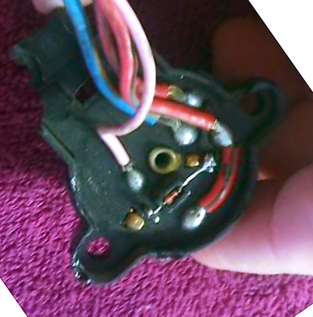

Member Contributer Grum Posted May 22, 2024 Member Contributer Posted May 22, 2024 1. What plugs did you use? Brand and part number. 2. Does the Fi Light go out as you hear the Fuel Pump stop after switch on prime, or does the Fi Light remain On? 3. Do you have any Fi flashing codes? 4. Bike in Neutral raise the Side Stand try a start. Does this make any difference to starting? 5. If the bike was running before changing the plugs, suggest refitting the original ECM. 6. Check your Ignition Switch wiring if you suspect you have the Pink security wire, see attached. If you do you must measure 9v on this wire. Quote

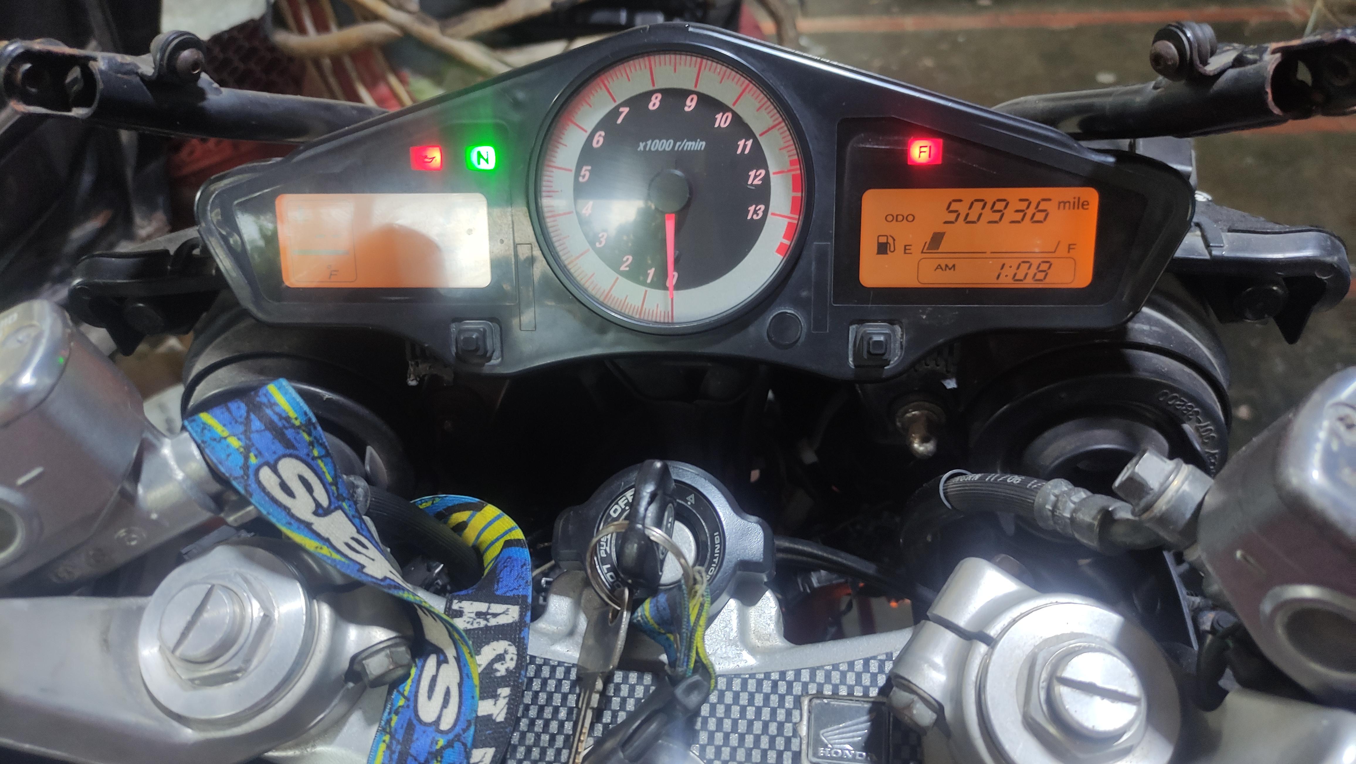

otidum Posted May 22, 2024 Author Posted May 22, 2024 Hi!! Thanks for help me out, 1 - the plug are grey and black with 33 pin each one , 38770-MCW- K01, 8561-103073 KEIHIN 2- the Fi light remaining on never go out 3- only 23 and 24 4- the same 5- I'll to take it out, and only see 4 VID_20240522_172635.mp4 VID_20240522_172635.mp4 wire Quote

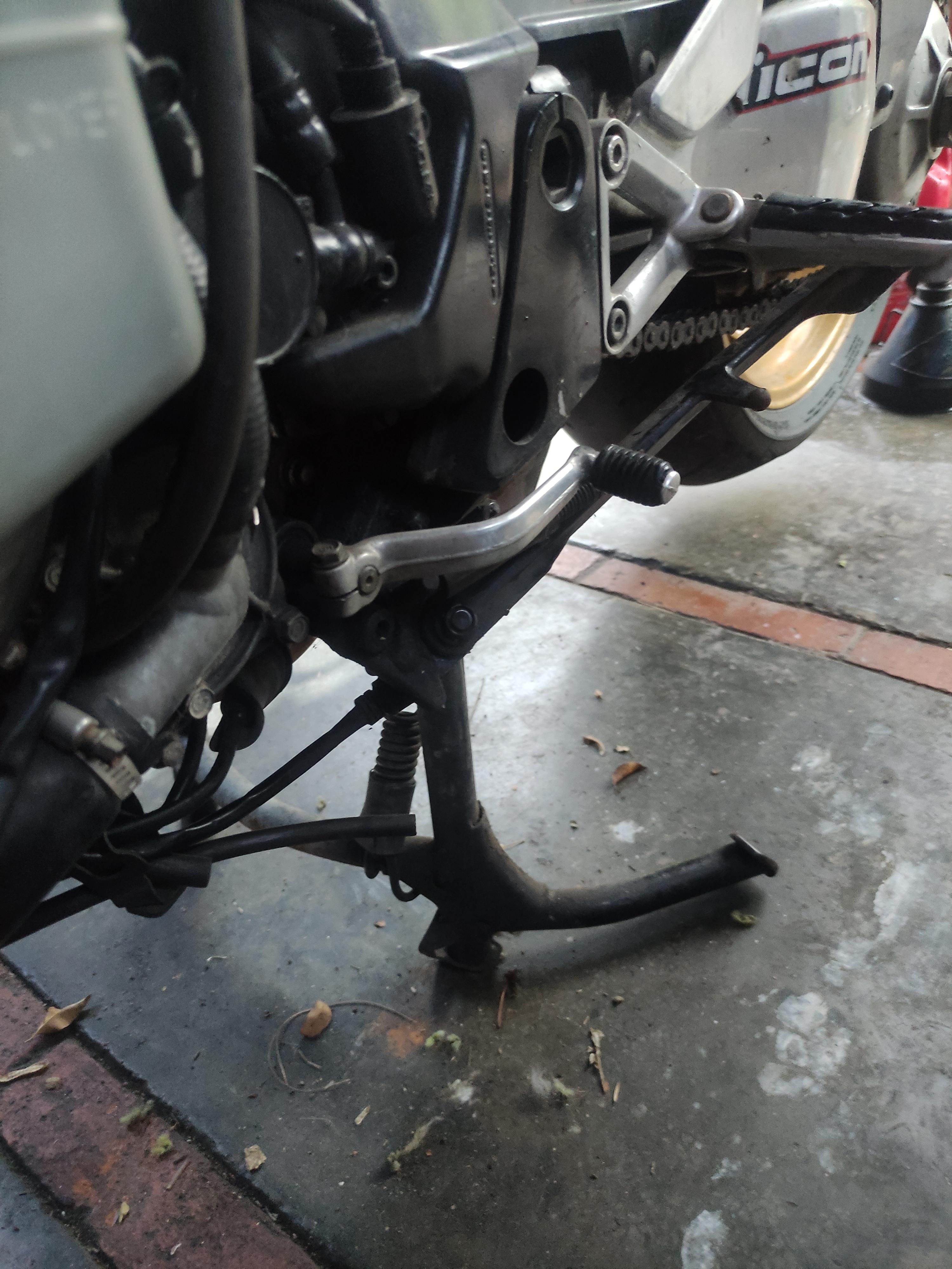

Member Contributer Grum Posted May 22, 2024 Member Contributer Posted May 22, 2024 1. What Spark Plugs, not ECM plugs? 2. Do you have the Sidestand Down? ECM will not flash a code unless Sidestand is Down. 5. Do you have the original ECM fitted? Codes 23 and 24 are for the Oxygen Sensors Quote
otidum Posted May 22, 2024 Author Posted May 22, 2024 1- I don't understand, not ECM plugs? 2- no, I have sidestand up, 5 , yes , it's original, well that's the motorcycle bring with it, Quote
Member Contributer Grum Posted May 22, 2024 Member Contributer Posted May 22, 2024 1. For the third time! You fitted new Spark Plugs, what are they, NGK? What part number are the Spark Plugs fitted? 2. Lower the Sidestand, what codes if any do you read? Are you still getting only 23 and 24? Was the bike running Before you changed the Spark Plugs?? Do you have the Service Manual? You can download it from this forum. Quote

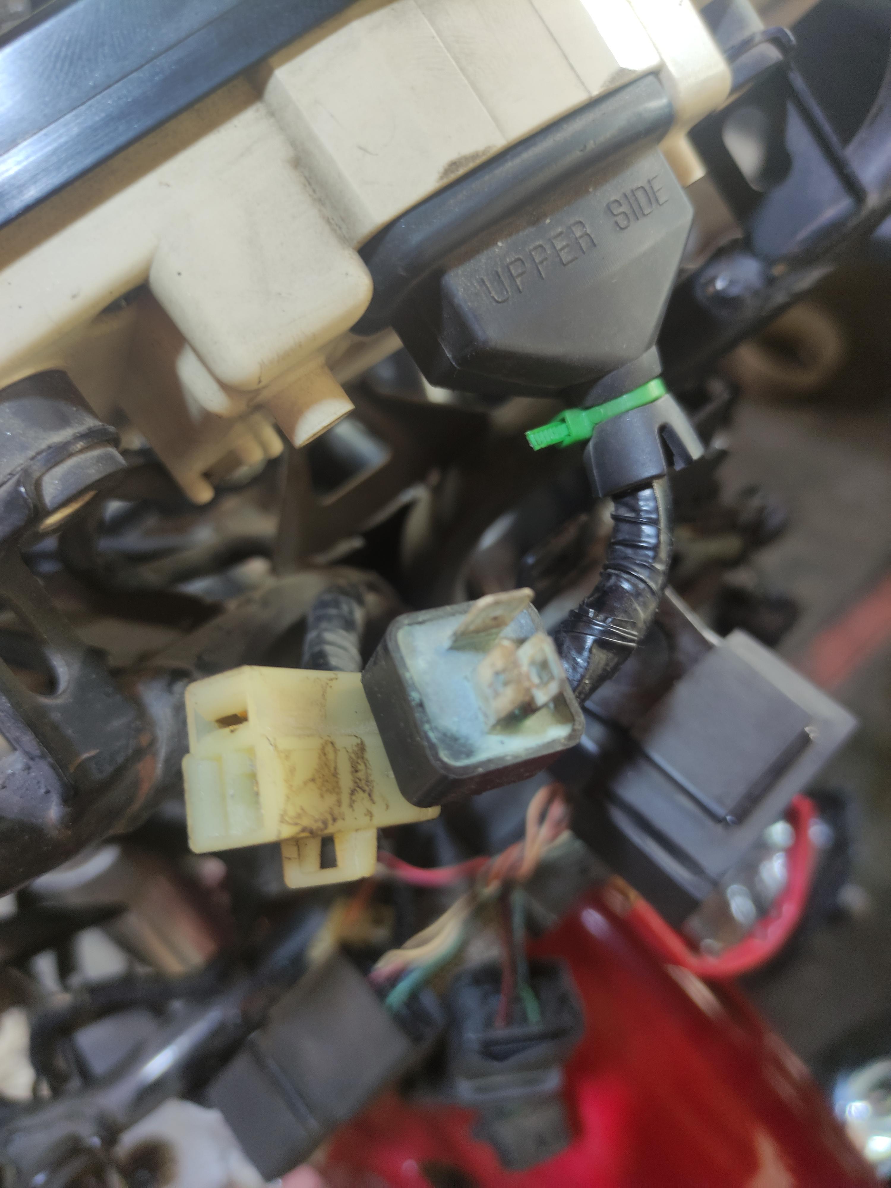

Member Contributer Grum Posted May 23, 2024 Member Contributer Posted May 23, 2024 40 minutes ago, otidum said: Someone knows what it's the 3 pin? Clutch and Neutral Diode. Quote
Member Contributer Grum Posted May 23, 2024 Member Contributer Posted May 23, 2024 42 minutes ago, otidum said: Or this little block of 3 pin, Possibly Turn Relay, what color wires go to it? Quote

otidum Posted May 27, 2024 Author Posted May 27, 2024 Thank for your help, I was working, I got a question, how the bike put down 12 v to 9 v to de the Pink wire into the ECM? The bike t Quote
Member Contributer Grum Posted May 27, 2024 Member Contributer Posted May 27, 2024 4 hours ago, otidum said: The Pink wire on the ECM got only 4.5v, BUT.....Does that Pink Wire at the ECM go to the Ignition Switch? Or to some other device? YOU NEED TO CONFIRM THIS. Do you have the Pink wire at the Ignition Switch AND the small Zener Diode As per the picture I posted for you? Quote
otidum Posted May 27, 2024 Author Posted May 27, 2024 In the Pink wire I got 4.5v , and I don't see the Pink wire get to ignition switch, Quote
