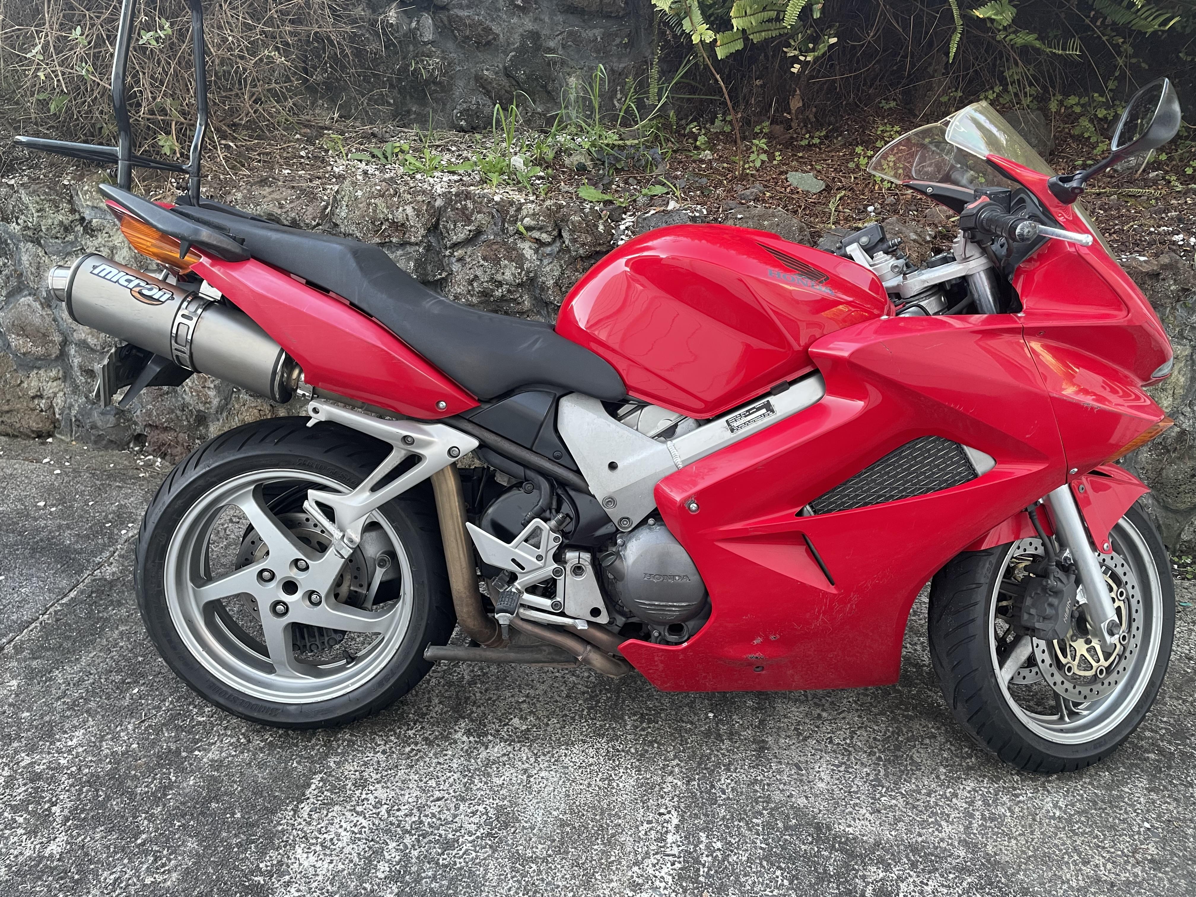

i am the new to me owner of a 2003 6th gen VFR800. I’ve previously owned an RC36 but now living in NZ I thought I would add the VFR to my collection to use as a commuter and sometime tourer.
I brought it as a bit of a neglected machine, hadn’t been cleaned or properly looked after in years. Anyhow, 4 days of mechanical bits like CCTs, full servicing, bit of wiring and a damn good clean and polish she is on the road and riding lovely. A couple of little niggles that seem normal for this gen VFR for me to work through but what an awesome machine. It’s up there with mileage being at 163000 kms but seems sweet as a nut. Pic attached, all original panels with a few battle scars and micron end cans.
Great to be in the forum and I’m sure I will be asking a few questions.
cheers
