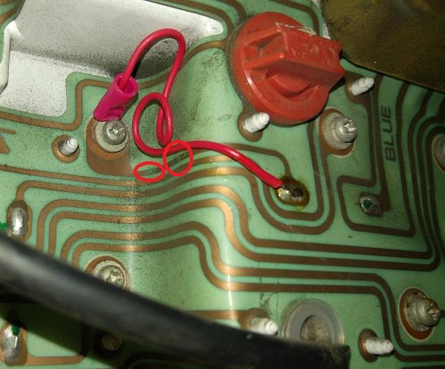

Hi Mike.
Assume you mean the LCD.
Before replacing this. Have you confirmed that all the mounting screws for the LCD are clean and making good contact with the PCB copper track pads?
Have you gone over each copper pad with a multimeter on low ohms or buzzer mode to confirm each copper pad for the LCD has continuity back to either of the two main incoming connectors?
Corrosion and broken copper tracks at the back of the Instrument Panel are a common cause of LCD and indicator light issues. The tracks can easily be repaired by soldering shorting wires.
Attached is a repair example, the red wire is bypassing the open circuit copper track shown with the two red circles.
I think the LCD screen component stores the odometer reading, FYI, so that would change with a new/old unit.
