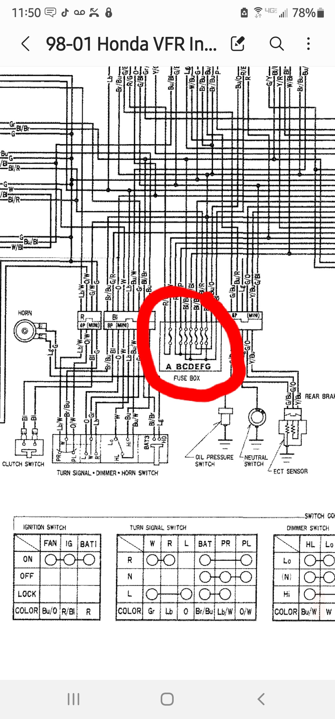

VFR800RYDER4LIFE Posted January 20, 2021 Posted January 20, 2021 1998 Honda VFR800FI, WHERE IN THE F IS THAT DAMN FUSE BOX? It's not under the seat nor around the battery I looked there and not on the right side of the bike either. I'm looking for the fuse box because none of my blinker lights work and I just ordered a signel relay and wanting to find the fuse box to check if it's just a fuse. This is how it happened I cut one of the back turn signal wires and I splice the wire to run wire to the front for my review led mirros. One I connected the wires together and not knowing the wires where touching eachother I turn the key and hit the turn signal switch and I hard a pop and now the signal lights don't work. My heads light work just fine but not the signal lights. Please help to find that fuse box or a picture on how it looks. TIA... Quote
Member Contributer Cogswell Posted January 20, 2021 Member Contributer Posted January 20, 2021 Don't know about any other 5G's, on mine it's right in front of the battery under the rubber flap that protrudes out from under the tank. Has a white label on the cover. Quote
VFR800RYDER4LIFE Posted January 20, 2021 Author Posted January 20, 2021 I'll check that out thank you Quote
VFR800RYDER4LIFE Posted January 20, 2021 Author Posted January 20, 2021 Yup I found it thank you for your help man it was hard to see it because it's fully Wrapped Around a bunch of wireswires Quote
