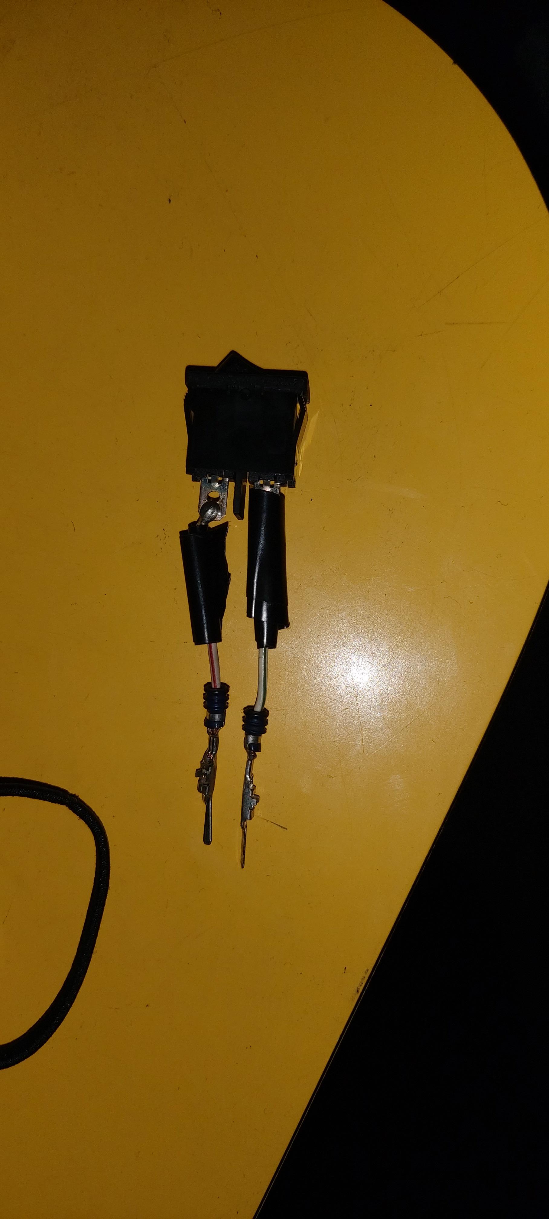

M0T0RIDER3737 Posted July 24, 2020 Author Posted July 24, 2020 Update for everyone, the MAP sensor has been replaced (along with all the vacuum lines as a precaution) and she is now running as normal, which I'm glad about since if that didn't work the next step according to the workshop manual was to test with a known good ECU, but I would like to thank Grum again for giving me a hand with this one, his help in giving me a starting point was definitely appreciated. AAlsoincase anyone else needs to clear DTCs for any other type of problem I have included a picture of a little "tool" I rigged up, normally I would use this for old school cars at work that used flash codes, but proved to be just as handy on the bike too, it's just some old male wiring terminals connected to a switch but trust me, makes clearing DTCs with out a computer so much easier/quicker 1 Quote
Member Contributer Grum Posted July 24, 2020 Member Contributer Posted July 24, 2020 Good to hear you're up and running again. Like your switched shorting link, good idea. Now you can properly set your warm engine idle to 1200rpm. Adjuster is just above and forward of the clutch slave cylinder, although with a new MAP sensor it might be back to normal idle. Enjoy your ride, it's a great bike. Cheers. Quote
