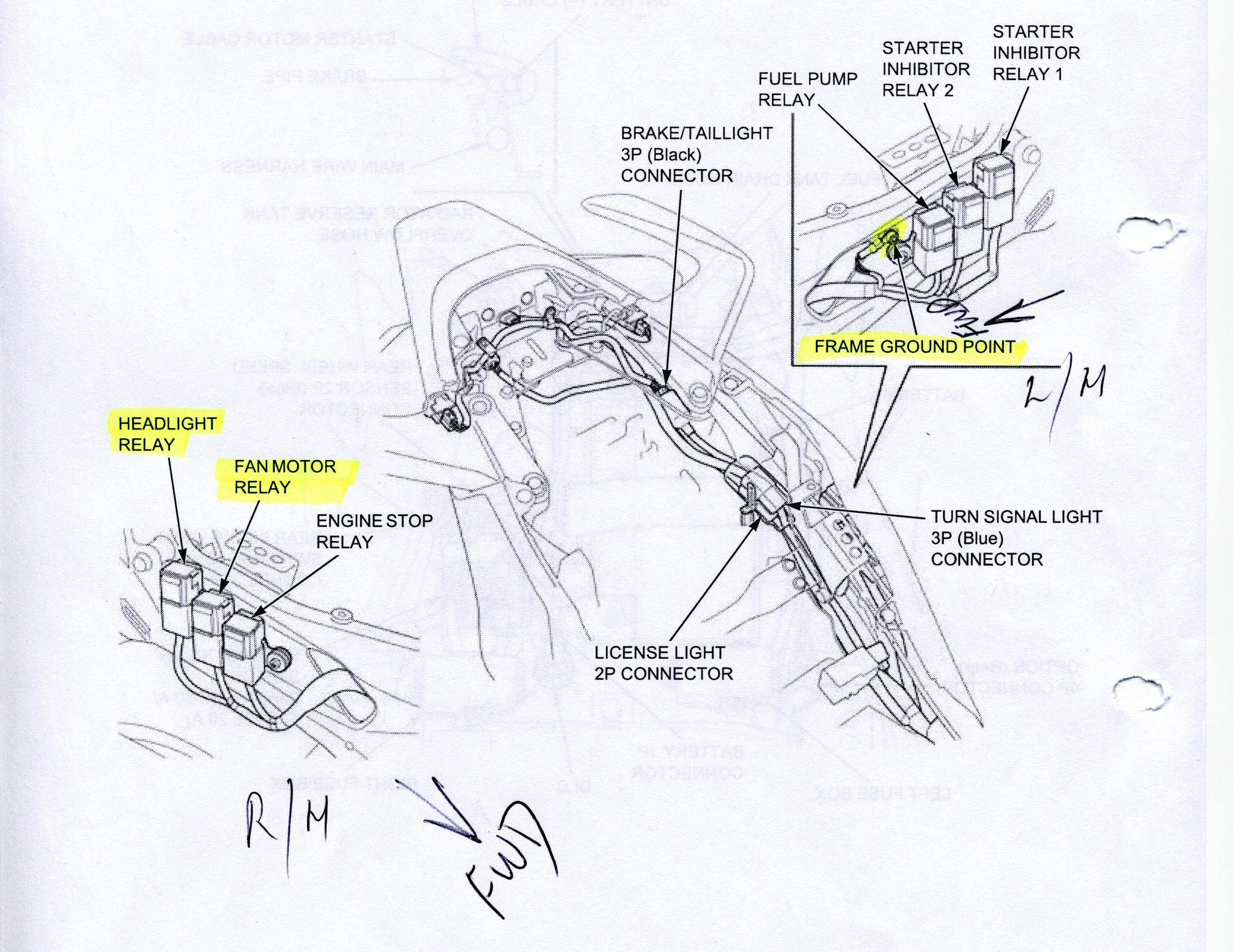

Also if you have any suspicion regarding the Fan Relay you can easily swap it with the Headlight Relay (Hi beam ops only) they are next to each other and are the same type, see attached drawing.
Let's know how you go with the above checks.
