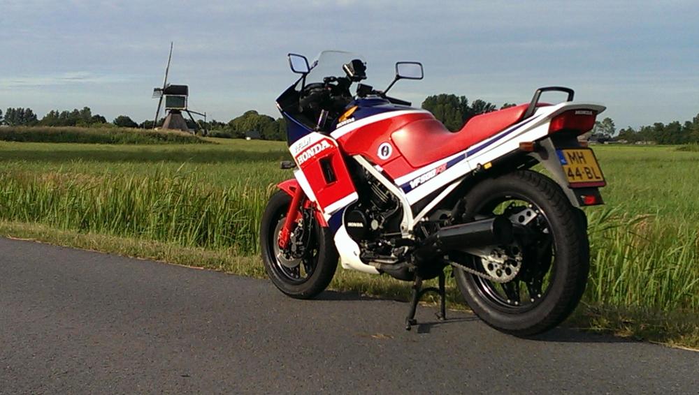

Not the 5th gen but happy with one on my VF500F2...
2 hours ago, windunderhawk said:
Thank You, Question, how may miles on shock? Hows it feel when pushed? Ever have customer issues?
By now I reckon some 15,000 miles
Euh feel when pushed?  It is compliant as expected. In my view it is as good as Wilbers (I had one on my VFR750) or Ohlins (I have on my RC51). Superior to OEM in any case.
No customer issues.
