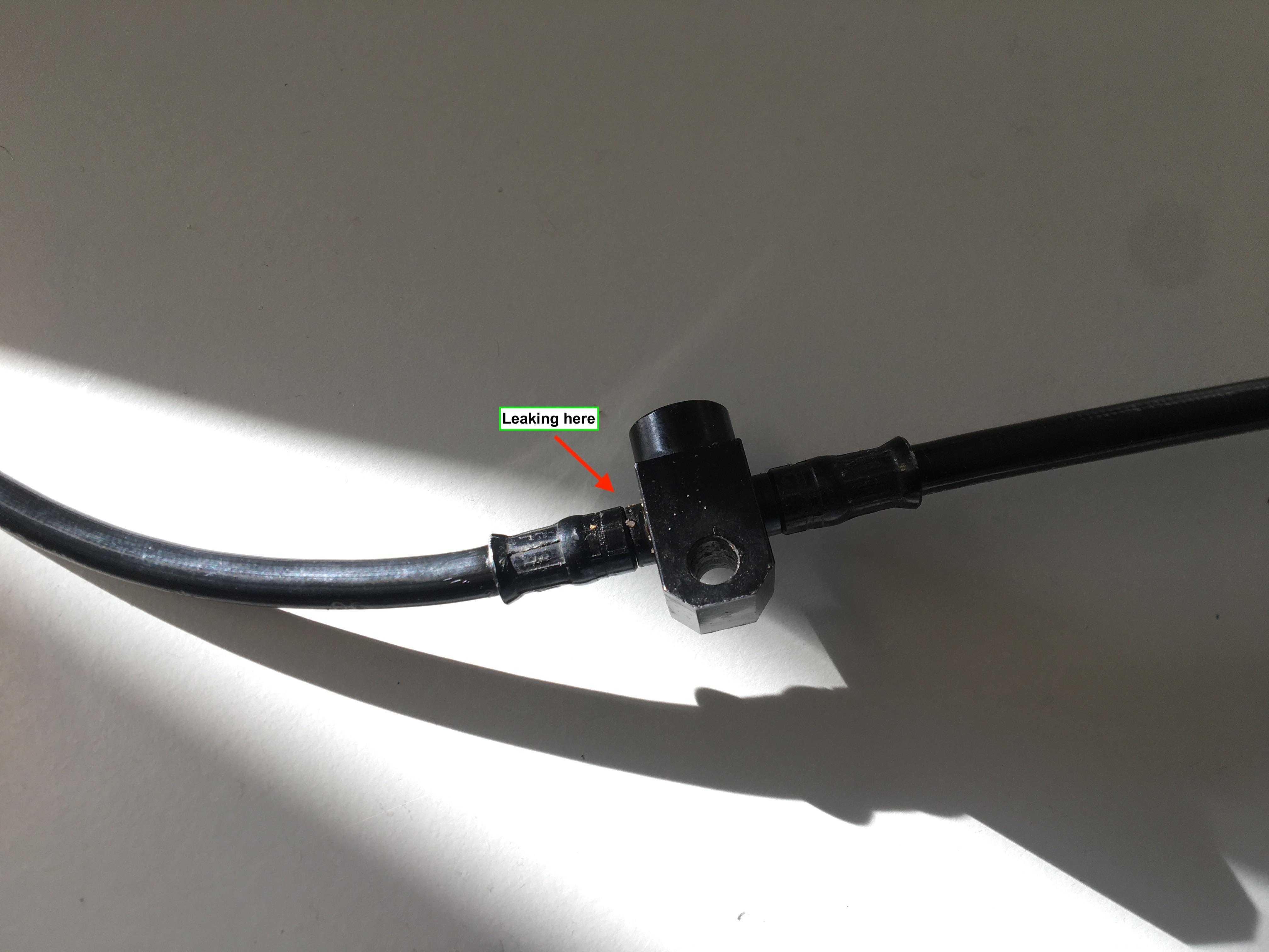

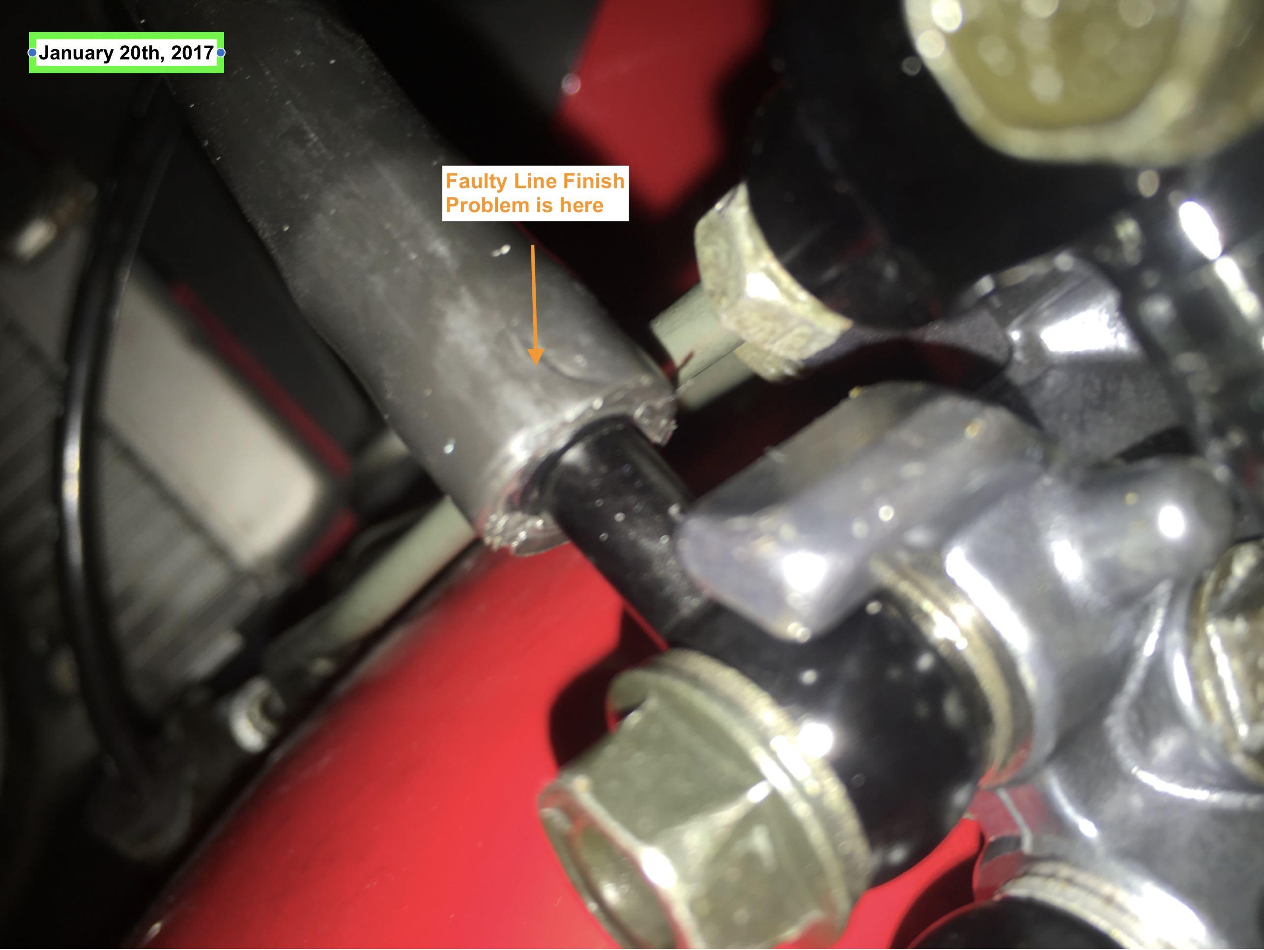

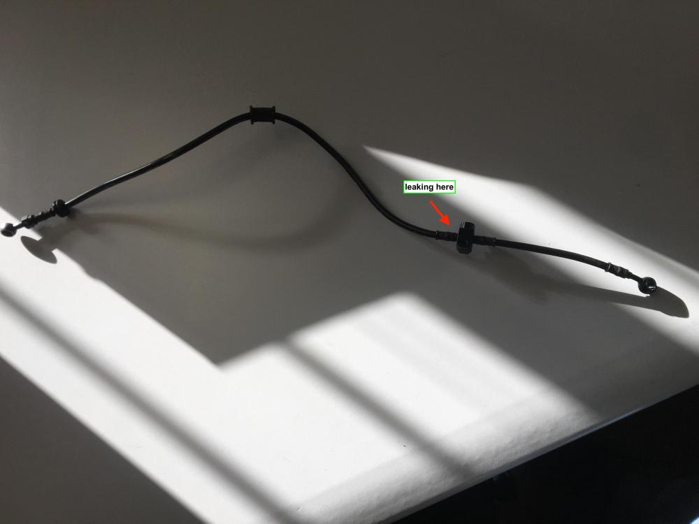

I have bought and installed the kit back in 2016, and have had two  brake lines leaking so far as per attached:
-1st by end of January 2017
-2nd just days ago, October 2019 (didn't took the effort to take a pic of actual faulty brake line, but I can easily do so)
I have no intention at all of denigrate Fren Tube in anyway, however I do believe everyone who has myself has bought this kit, should strongly think about either replacing it, or keep checking for leaks on front brake line connectors, as it looks like with suspension work, the braided brake line movement up and down ends up causing to much stress on the connector, which eventually starts leaking.

1012023062_ScreenShot2019-10-31at10_12.41copy.thumb.jpg.2ee2e293479af26ba1f07fe9973db283.jpg1168150634_ScreenShot2019-10-31at10_13.00copy.thumb.jpg.8370333c8babcb3b30ac4523d67db2bf.jpg

Hi All
I would like to share Fren Tube will be sending me a replacing brake line for the Faulty one (pics attached)

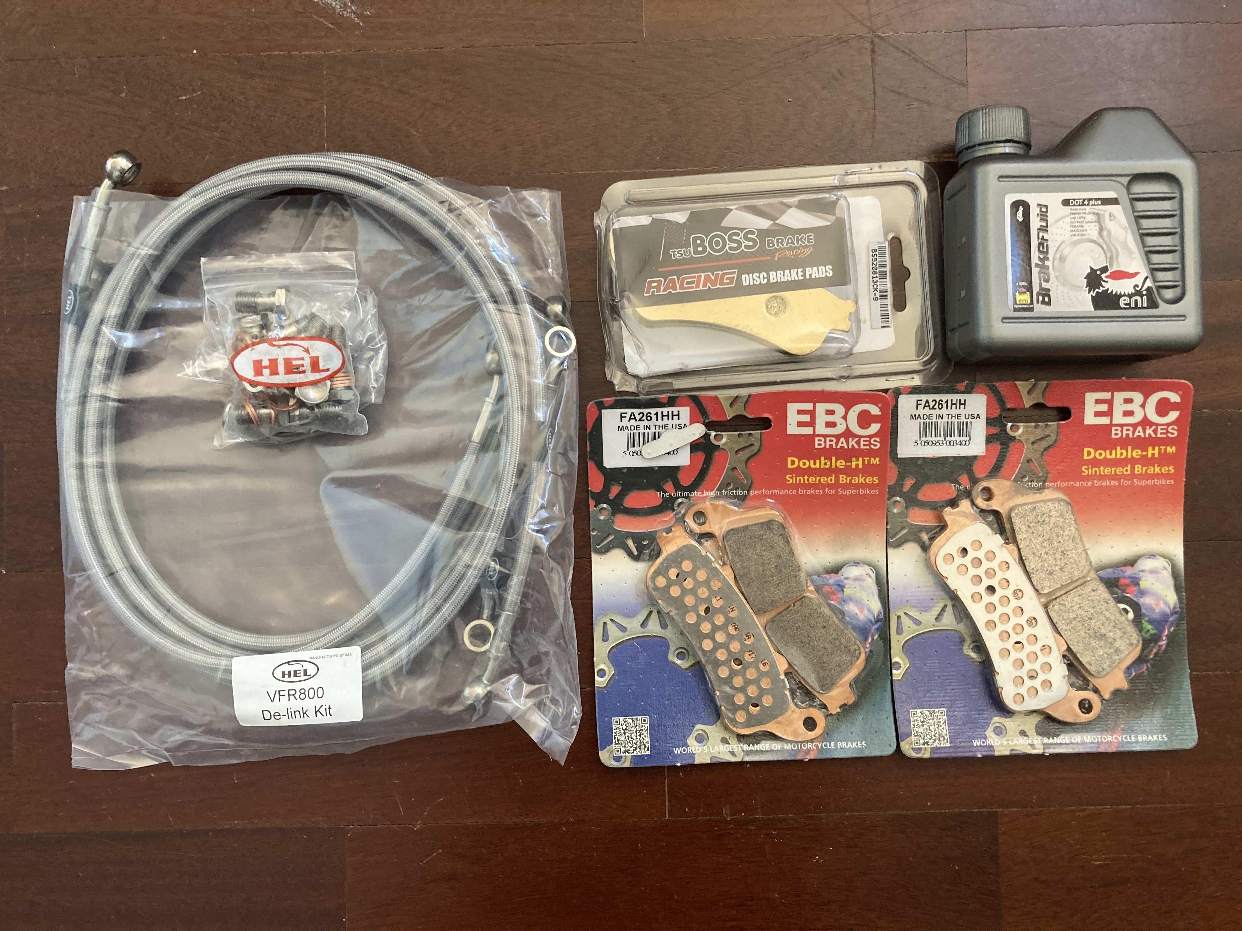

Just got my Hel kit yesterday 😃 I was finally able to buy one 😃 plus all new pads brake fluid etc etc
going to replace the Fren Tube, as I fear I might run out of luck, and life, if this happened a third time 😅779649046_IMG_0231copy.thumb.jpg.87f70f95443e26a6b913cbad169c699e.jpg
