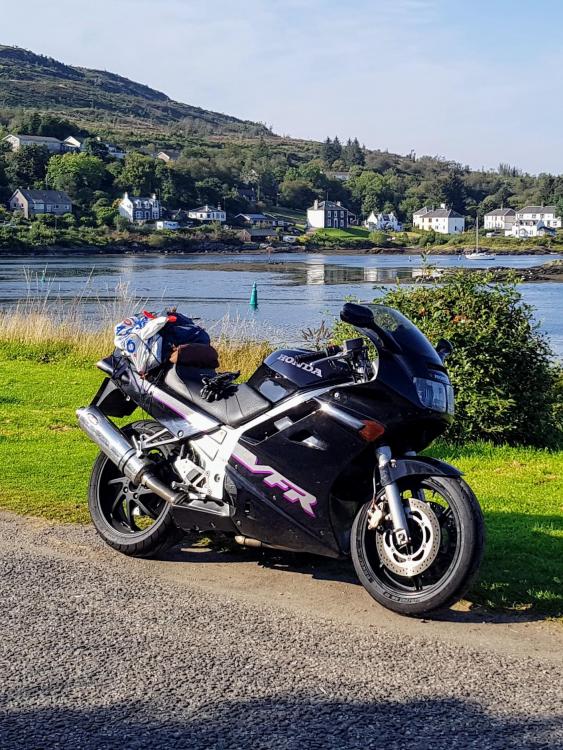

I've included a picture of my bike too on a recent weekender.
