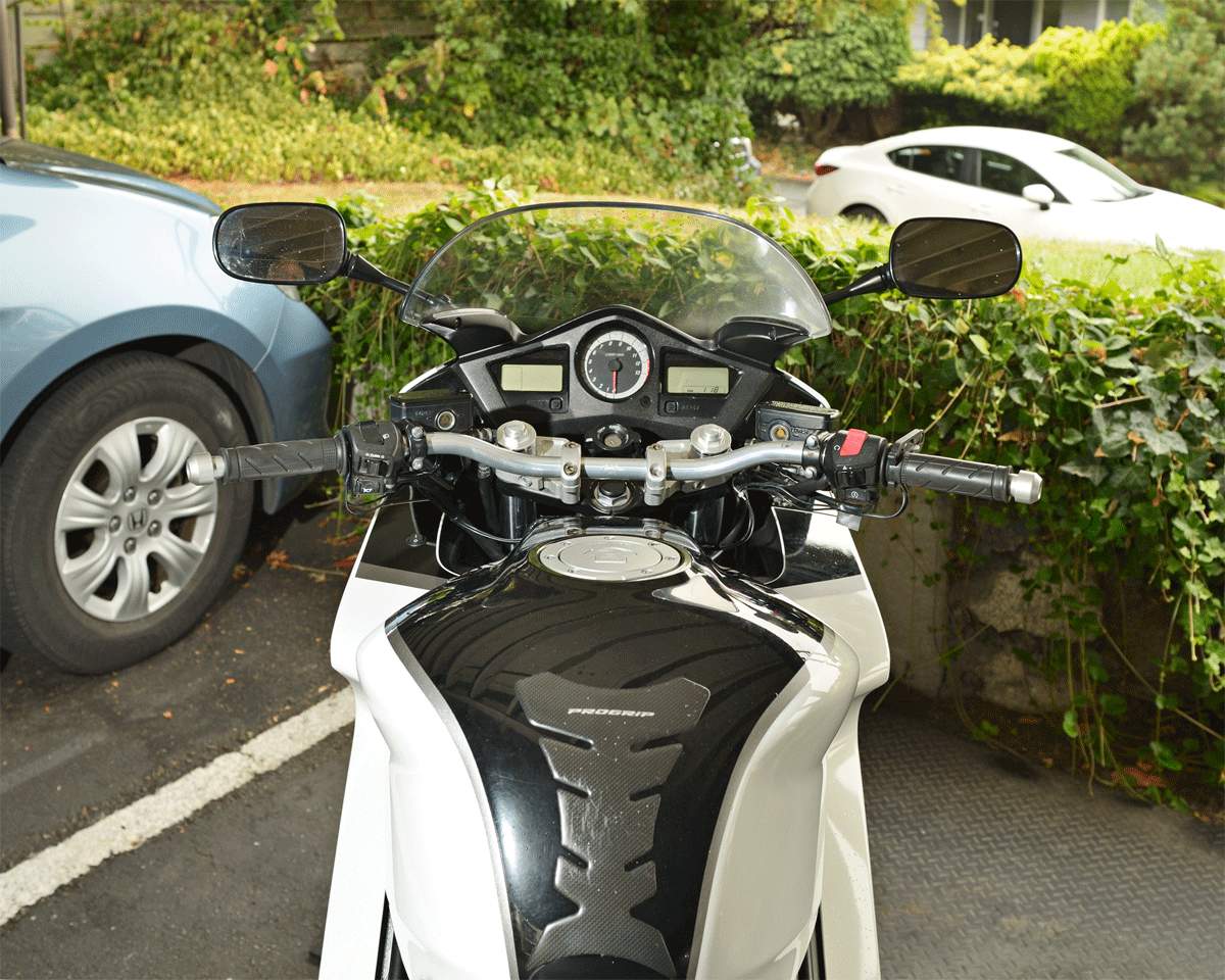

From new my VTec’s handlebars have vibrated noticeable more than either of my 5G VFR800s. In 2016 I installed an LSL Superbike handlebar conversion. In addition to the more relaxed riding position the vibration was dampened somewhat.

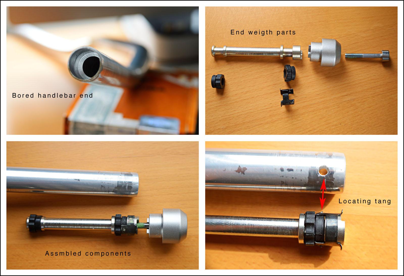

But the aluminum ‘bars which cannot accept Honda’s bar end-weights because the wall thickness is much thicker than the steel oe bars. None of the aftermarket end-weights I looked at were any good.
At my dealer a couple weeks ago I noticed that the CB1000R uses an aluminum handlebar. It won’t fit the LSL brackets as the centre section swells to more than 7/8”. But I reckoned that the end-weights might just fit, and ordered a set.
When they arrived a test fit showed that I needed to bore the outer inch of my handlebars. I wasn’t keen to try it myself with just a hand held drill, but a local machine shop solved that issue.
Assembling the bits was pretty straighforward, though a little silicone grease on the inner rubber o-rings helped.
The first photo shows the various bits, and the two gifs show a comparison between stock and LSL.

To answer your question, yes. The bar end weights reduced vibration almost as much again as changing to tubular bars. Plus, they added a finished look to the conversion.
