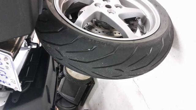

Tires.... Now that I have had a chance to put a few more miles on the Angels GT's, I do have to say that I really like them a lot! Such a big improvement on the bike overall feel.

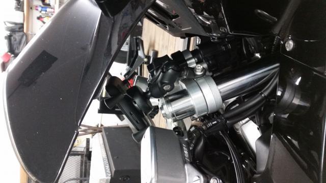

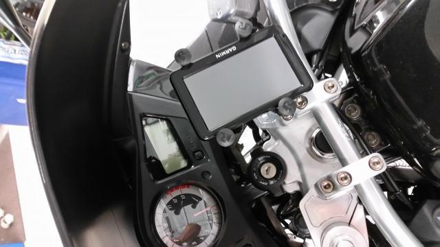

I had someone else ask me about how I mounted my GPS. All I use is a mirror mount and I used the fork pinch bolt as a mounting point for it. It has worked out great for the VFR. I have also switched over to using a RAM X mount for the GPS. It also works great for my cell too so one mount works on both devices. Only thing that I dont like about the RAM X is that your device can still twist in the cradle after you have it in there. Its not a big deal and it really does not move much at all. Guess I am just a little picky.

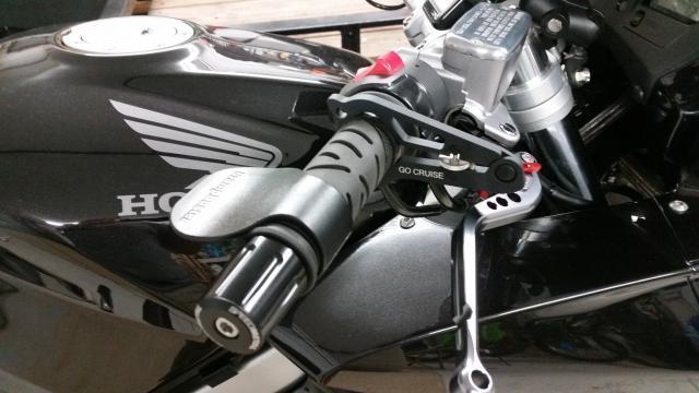

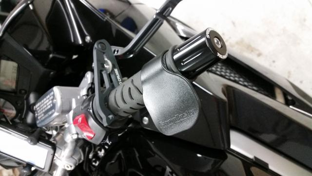

I added a Go-Cruise and a Crampbuster to help out my right hand and wrist. I was not sure if I was going to like the Crampbuster but it does seem to have helped out my hand issues. I dont really like the size of it but it seems to work pretty well. The Go-Cruise, I have only used it a couple of times just for a few minutes at a time so I dont have a really good impression of it yet but so far, but I like it.
