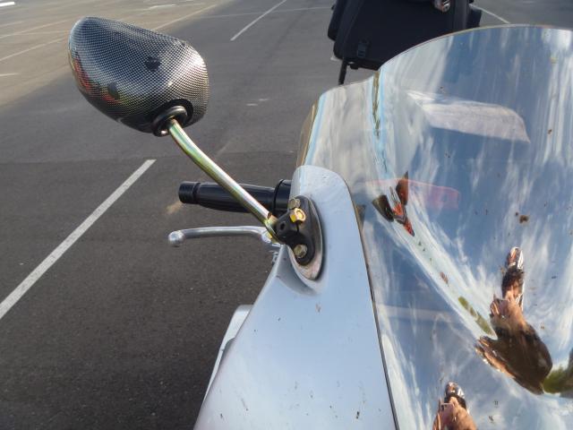

Let me just describe the set up.
There is a mounting pin that hold the arm of the mirror to a bracket that is bolted onto the bike.
It was this pin that snapped.
In respect to the design.
I believe it is in fact a deliberate designed weak point. In the event of the bike going down, the pin will break and the mirror falls away rather than pushing on it and that pressure cracking the top faring. (headlight surround) On reflection, if this happened, even if you then had to buy the original Honda mirrors, that would be cheaper than repairing this faring. So the design its self gets a thumbs up.
Back to the trip.
In Armidale (235km later) a quick visit to the hardware store and a few dollars spent the mirror was back in place. The original design of that pin has its flaws in that at high speed on bumpy country roads the mirrors soon start to move around. Yet with the bolt in place, a side of the road repair, the mirror did not move for the rest of the remaining 2,300km.

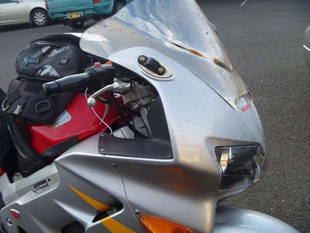

Following are some pics,
1) the mount and
2) the repaired mirror.
