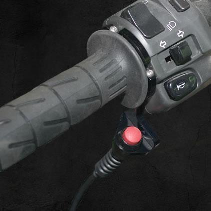

I'm in the process of installing my new PCV and I became interested in the Quick Shifter ability of the unit. DynoJet sells their handlebar mounted button for aprox. $140, so it's not exactly cheap. Here is a pic of the DynoJet switch. I don't like how the wire just sticks straight out the back...

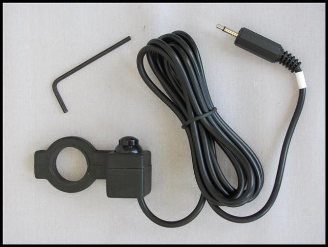

Reading through the instructions I found that ANY momentary switch can be used, so I went searching the web. What I found was this -
http://www.sierra-mc...?prod=AR-HM-PTT

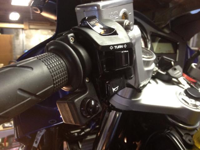

Price including shipping was only $32.68 so I figured why not try it. It mounts easily, although I did drill a new locating hole in my handlbar for the stock switch assy to make a little room for this. The wire bends easily where it exits the switch and I routed it with the other switch wiring. I just cut off the connector that came with it and connected the wires to the PCV

OK, I got my Power Commander V installed and everything set up. I installed the handlebar switch and it works great! If you have a PCV and want a cheap way to play with the Quick Shift feature this switch is a good way to go.
