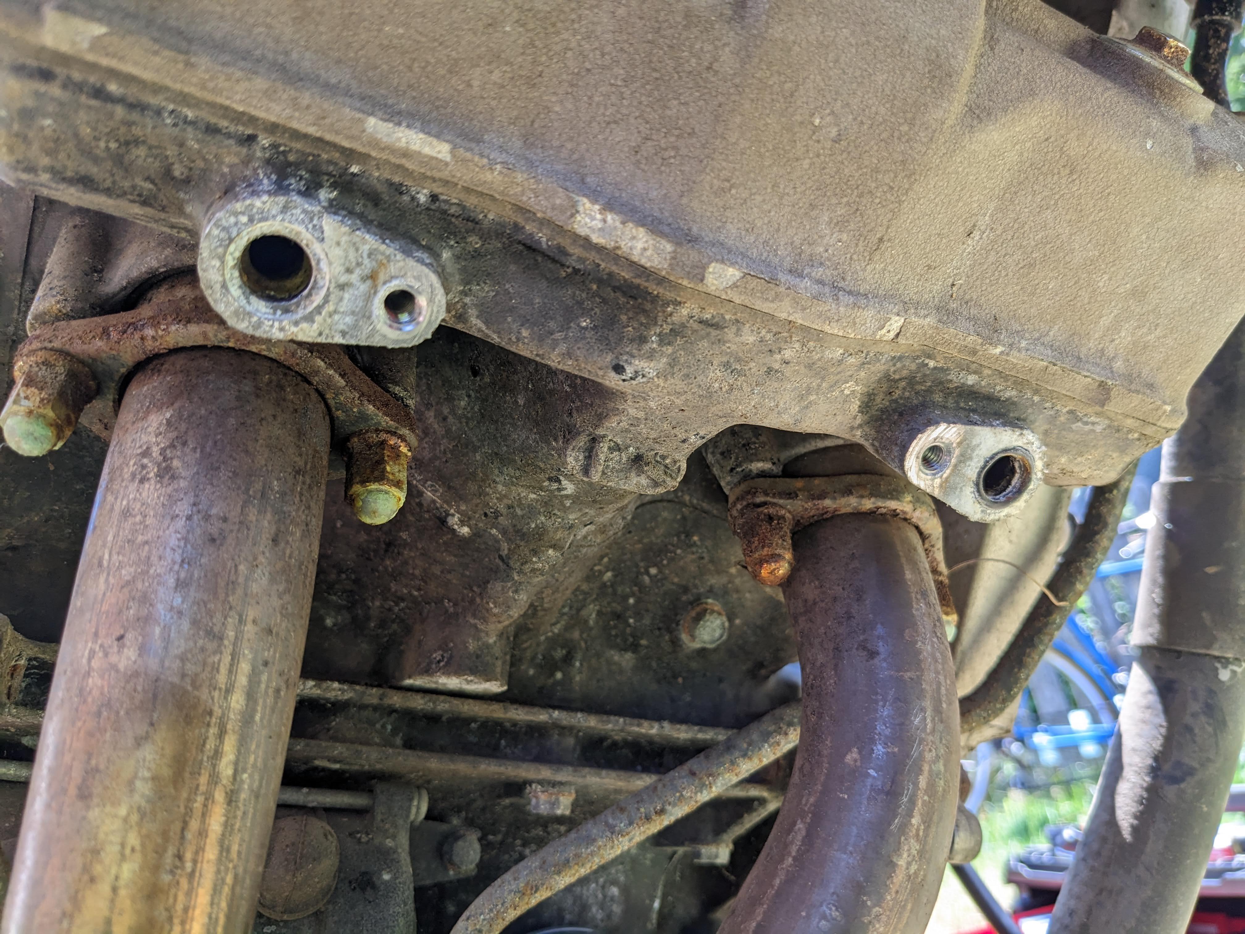

  2. Hard lines from engine under the radiator that appear designed to route crankcase gasses into the airbox. Just plug at the transition to soft lines? Maybe pull the hard lines and plug at the case?

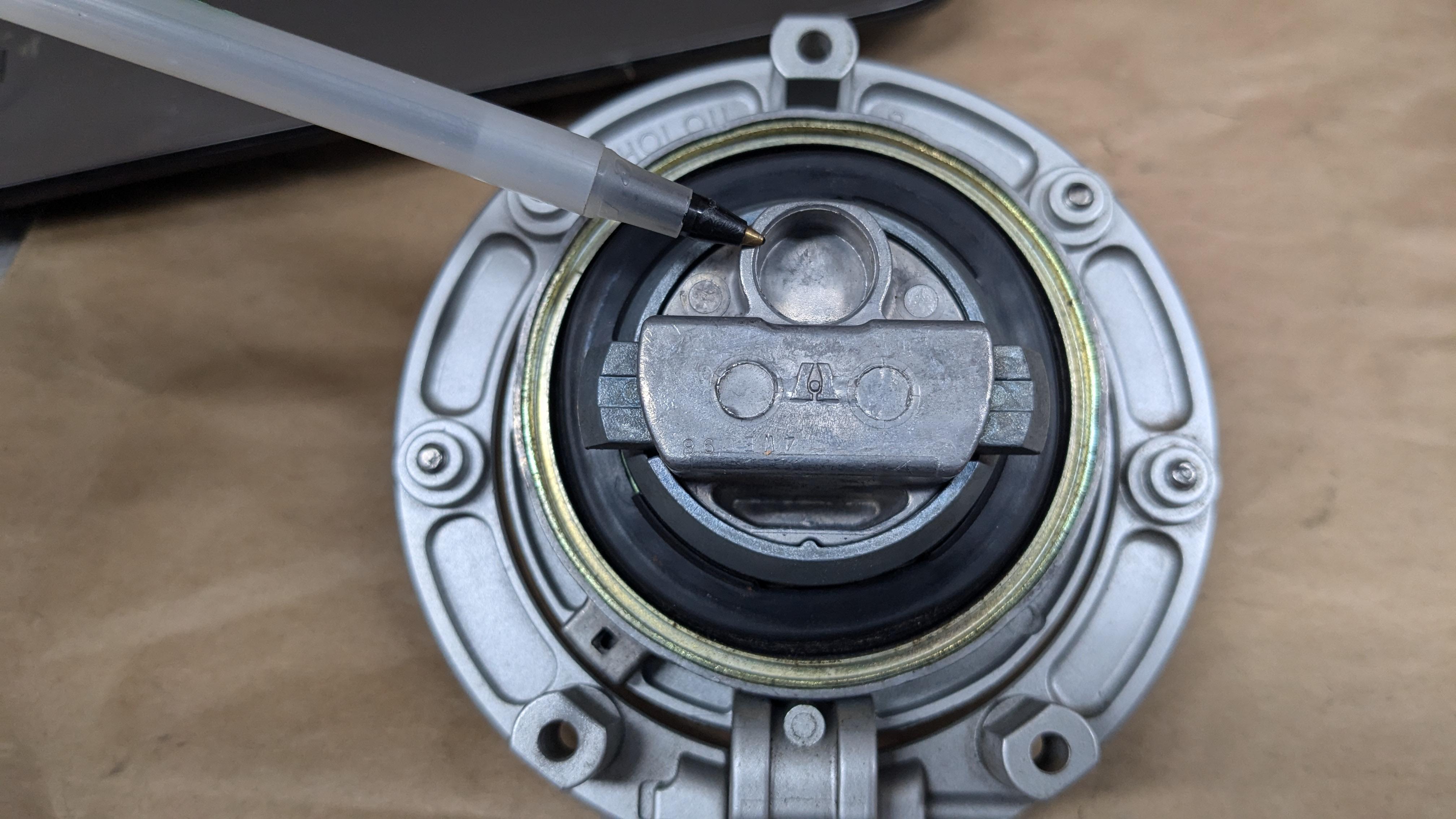

Need to verify cap type.  If it does not have the plastic vent insert on the underside, the tank needs to stay vented.  I have also read that you can drill a small hole in that area for venting and it does not introduce issues with fuel coming up thru.
CA cap:
Use the hard line fitting to make block off plates.  Much cleaner than having plugged hard lines still on the bike.

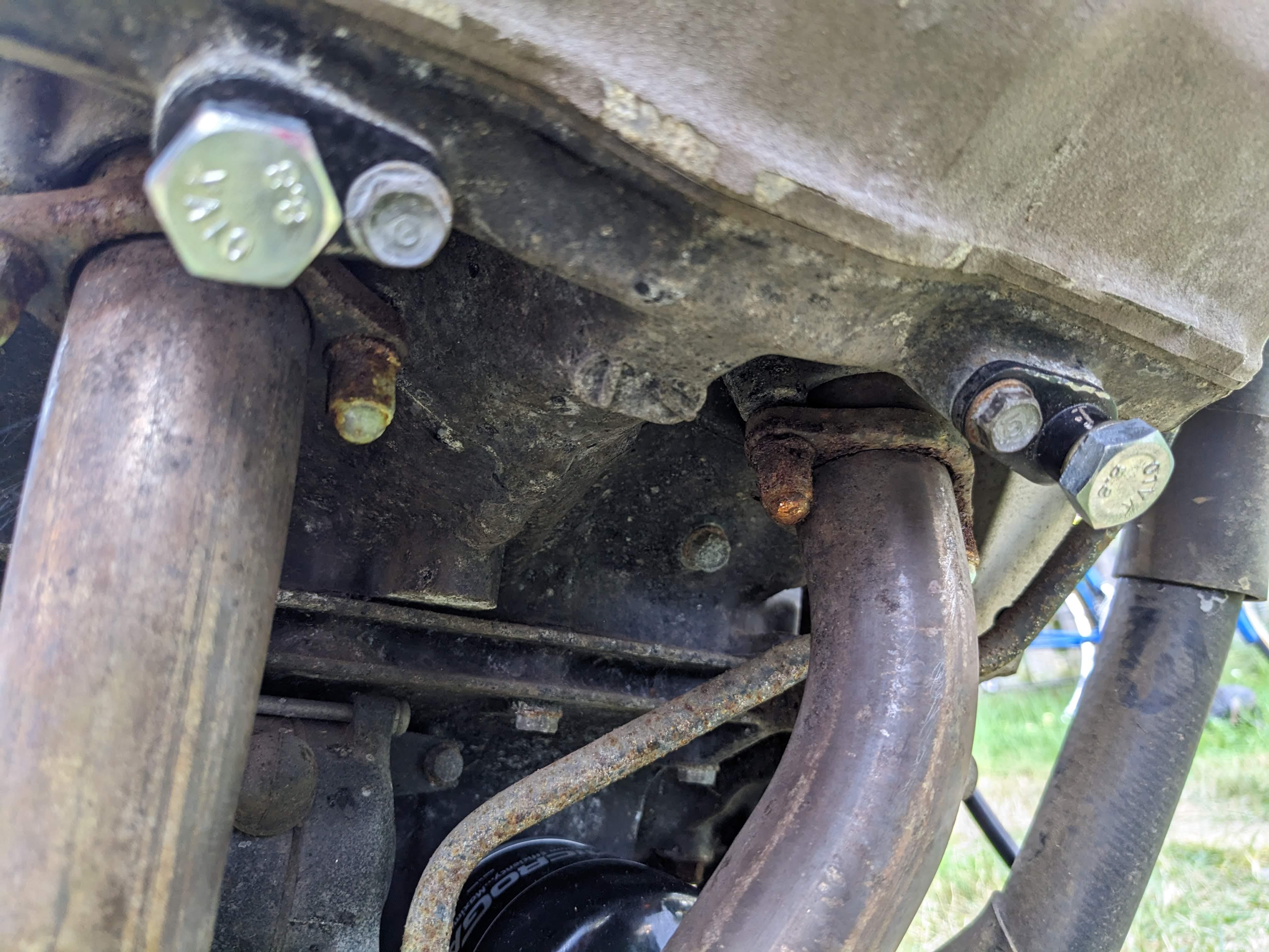

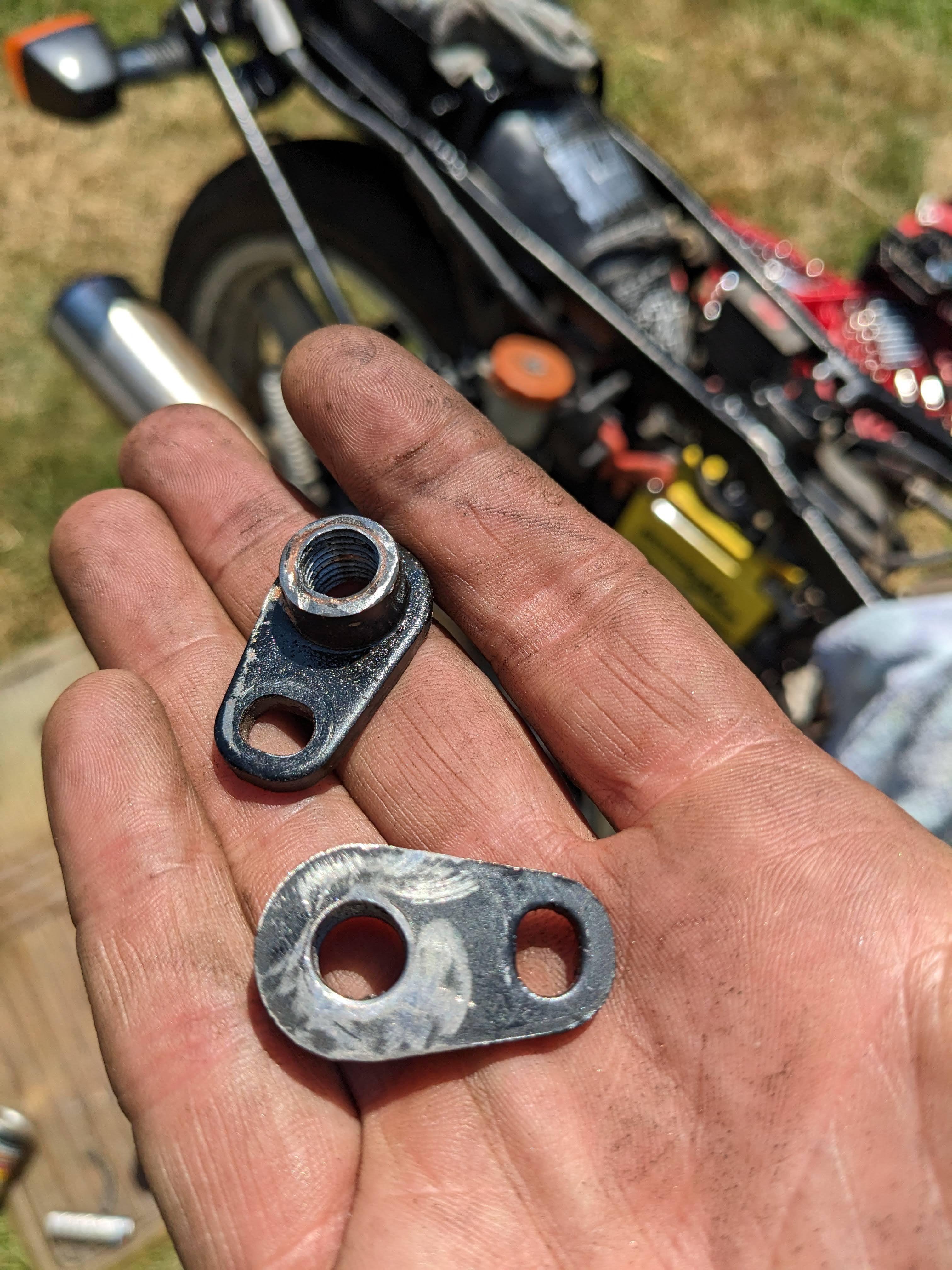

I pulled the Cali hard line off the bike, cut the hard line where it meets the mounting flange, tapped for what I think was an 8 or 10mm 1.25, bought a couple stainless bolts at Ace, cut them down to size to prevent protrusion or bottoming out, and put it all together. I kept the o-rings in the system - probably not needed, really. I also used old brake Banjo crush washers to help seal the whole thing - again, not needed, I'd guess. Once I decided to put a wrench on the bits, I think it took about 20 minutes. Not the prettiest, but given the location (and the bike's look overall) it's just fine.
Bam!   Some Honda bolts or allen heads look the part better, but like you said, for this application...   done.
