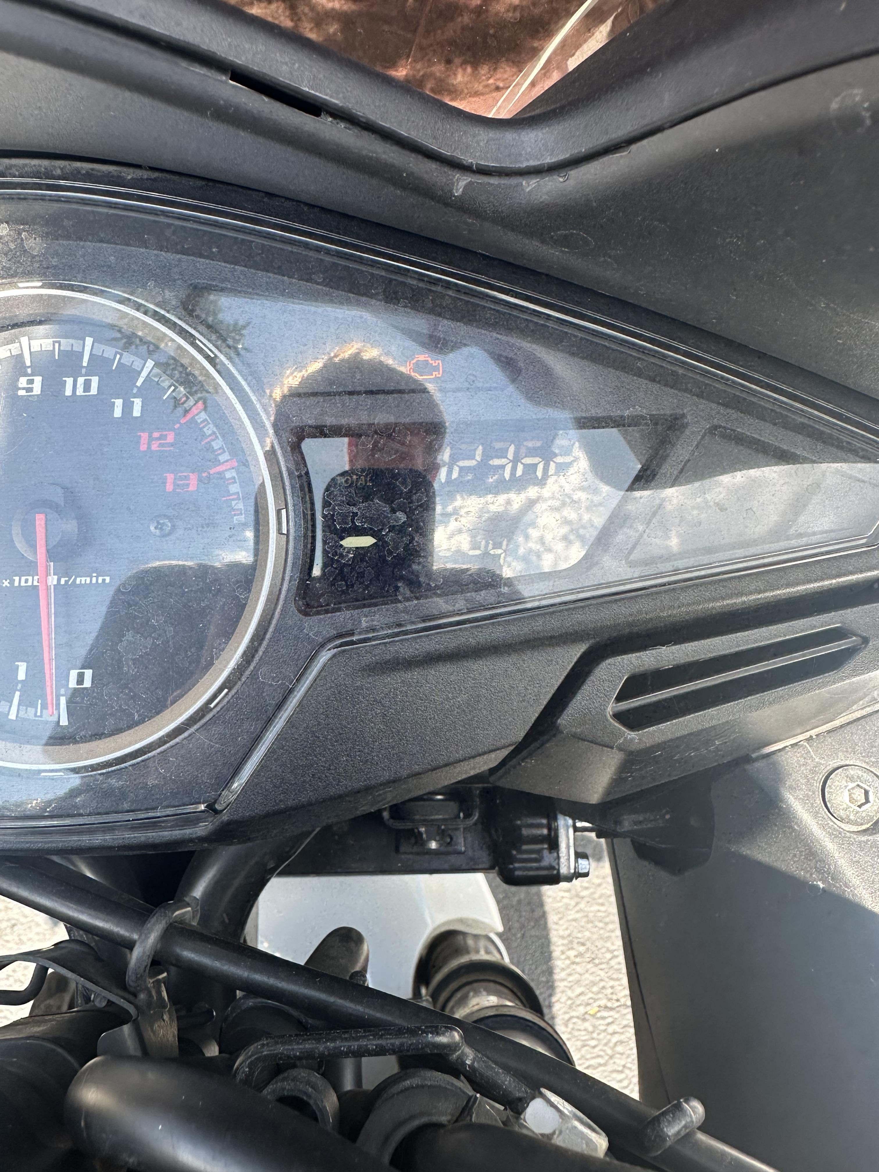

conwaychris626 Posted October 7, 2023 Posted October 7, 2023 2014 vfr800 fuel pump doesn’t prime and wont turn over. Also not showing what gear it’s in just blank lines Quote

conwaychris626 Posted October 7, 2023 Author Posted October 7, 2023 Battery is okay it doesn’t show nuetral but even with clutch pulled and kickstand up it doesnt try and do anything dash comes on but when you push the start nothinb happens and you never hear the fuel pump Quote
