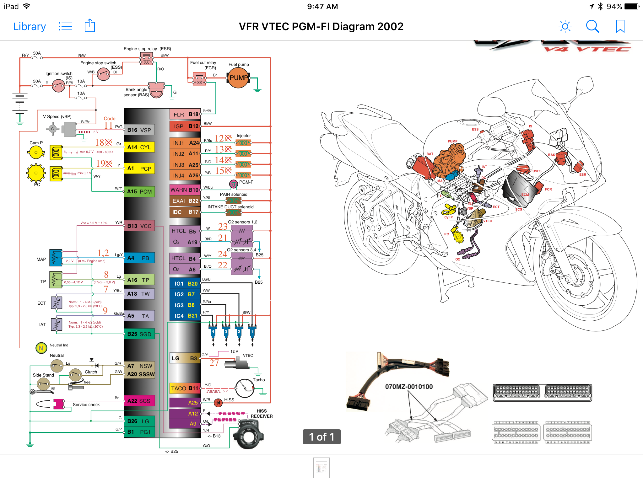

Remember, the ECM provides the switching Ground for the Fuel Cut Relay which powers your Fuel Pump.
So first establish the fuses are ok. Then, as GreginDenver suggested, unplug the Fuel Pump lead, stick your voltmeter probes on the lead and determine that at Ignition Turn ON you get 12v for a couple of seconds?
You can easily verify the Fuel Pump operation by carefully using some test leads and powering it directly from the battery.
Lets know how you go with the above suggestions as a starting point.
Check out the basic PGM-Fi Diagram and you can see how the Fuel Pump is controlled.
