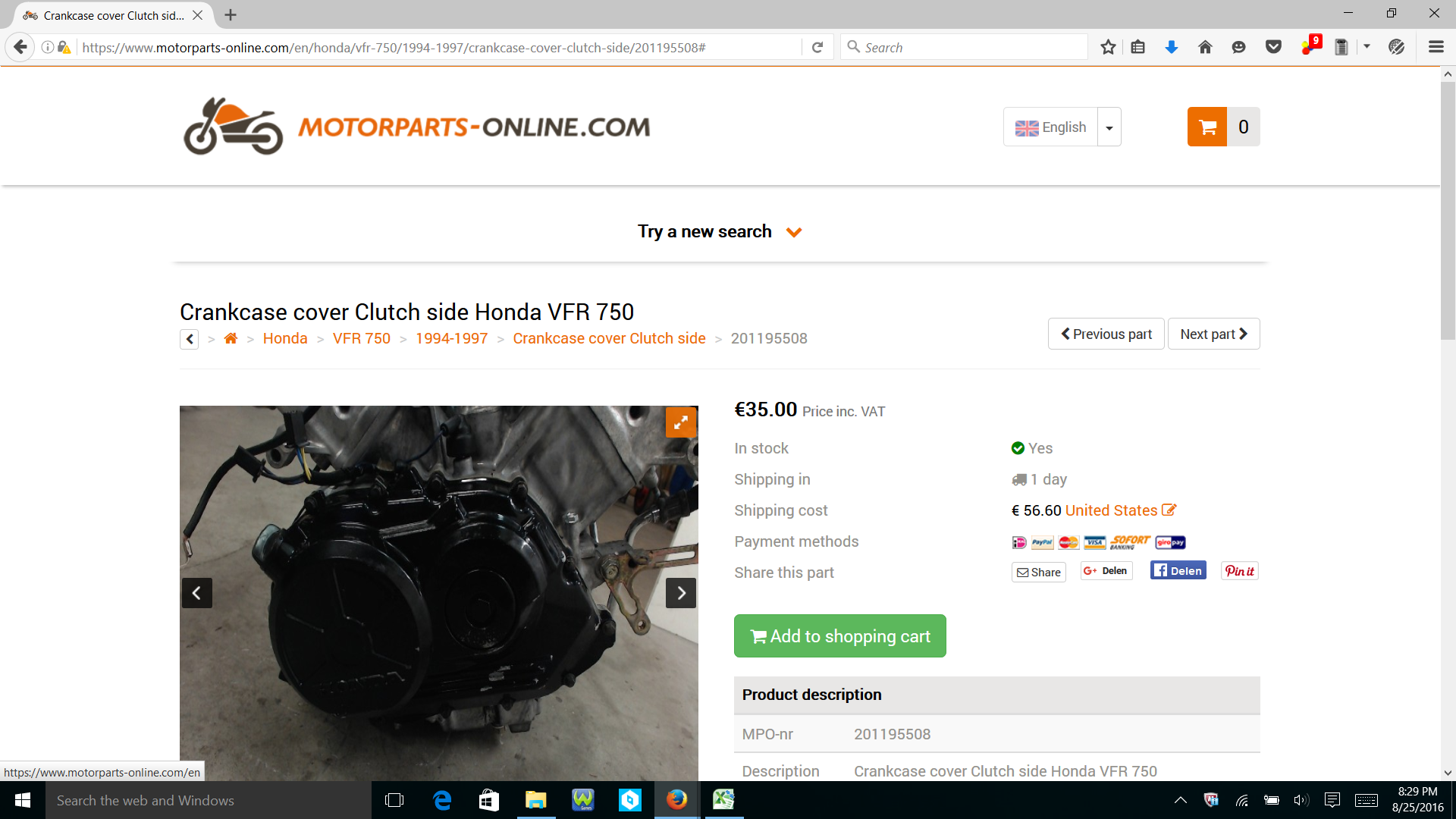

@Dutchy
Thanks for the quick and through response. I totally get that there are two different styles of covers: one with the oil filler in the middle and one with the hold towards the left. What is confusing is that the picture of the part in the listing I posted is to the left as if it were a part that could fit my bike. However, the title describes the item as coming off of a rc24 F/J/K which should have the hole in the middle.
Thanks for the new links I didn't have those or find them when I did my search. I am a little surprised that the shipping cost to the US is 56 euros! That almost triples the cost of the part. But given that I can't find one locally, it may become an option.
If the dutch breaker charges 54 euro shipping, that is crazy.
Ask them to ship regular "PostNL"
Or else pm me and i eill see if i can help (plenty time on my hand, the one that is not in a cast :-) )
