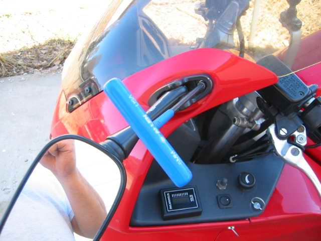

Remove the mirrors - 5mm hex bolts

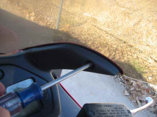

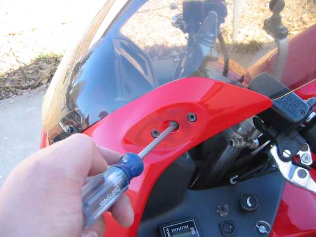

Under the mirror is a screw that must be removed

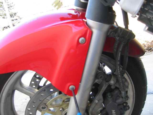

Remove the screws on the inner moldings

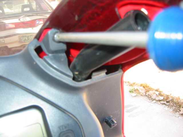

Another hidden screw inside the molding

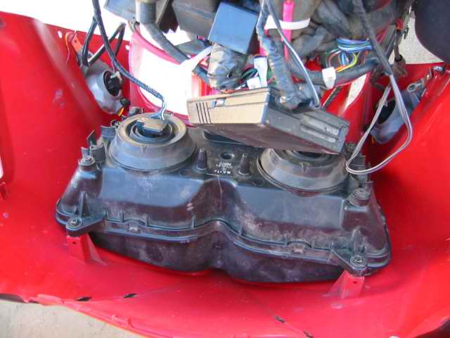

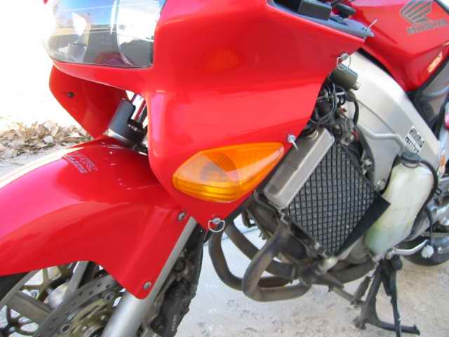

The front cowl is ready to be pulled loose
Now you can unplug the two lights and turn signals
Remove the fender

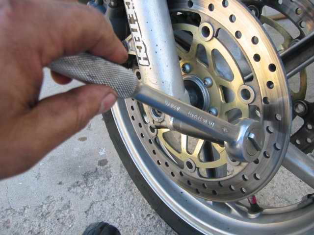

Taking off the wheel loosening the axle bolt
Loosening the axle pinch bolts

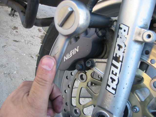

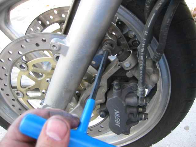

Removing the brake calipers this side is 12mm bolts
the other is 6mm hex

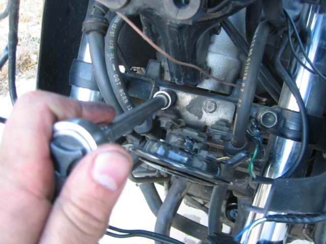

I lifted the bike with a jack under the pipes and pulled off the wheel, then I started to remove the hose attachments and the horn assembly.
Remove the horn assembly

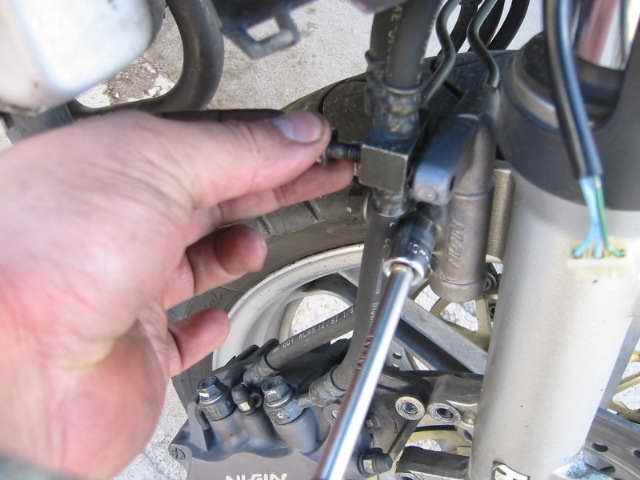

Take off the hose attachments 4 bolts one is behind the hose so its last

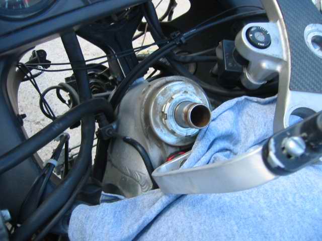

Here is the steering column
Bend the tabs flat and tap off the top pinch bolt with a hammer and a flat screwdriver.

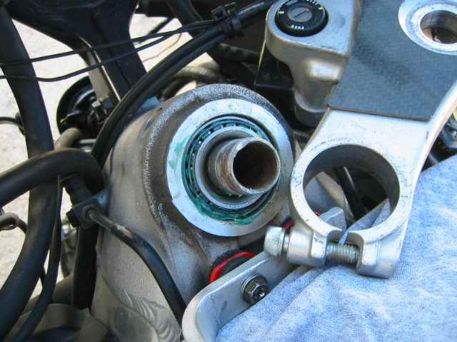

Honda sells an expensive socket for this but I dint have the time to find it. They are not on too tight Unscrew the bottom bolt and remove the clip, then the column just falls out careful not to let it drop, remove the old bearing sets.

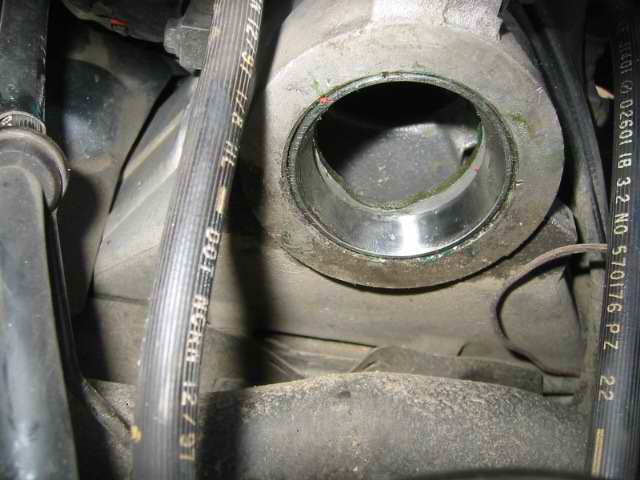

Hammering out the bottom race

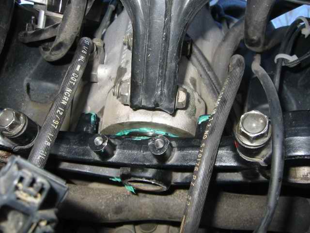

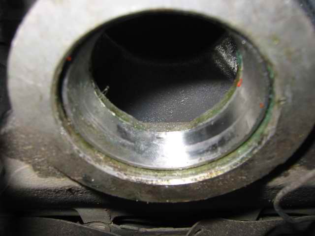

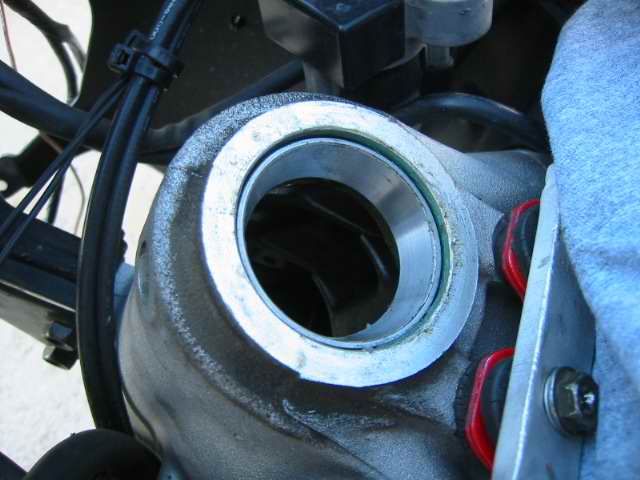

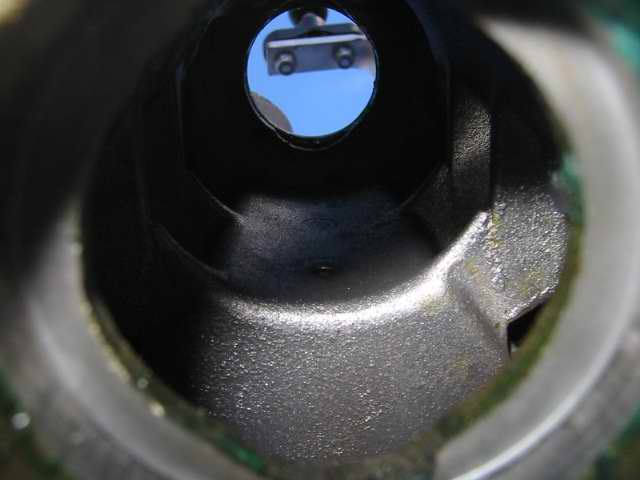

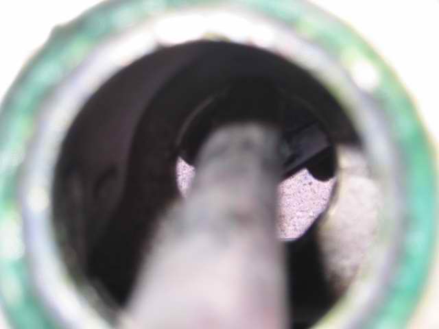

The races have to be hammered out, the frame has notches for you to do this, I used a metal rod and hammer and tapped on both sides until they popped out.
Looking up you can see the notches
The old races came out easy

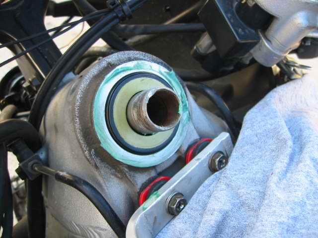

The old races where visibly pitted and that was the cause of my chattering forks, too much play in the column does that.

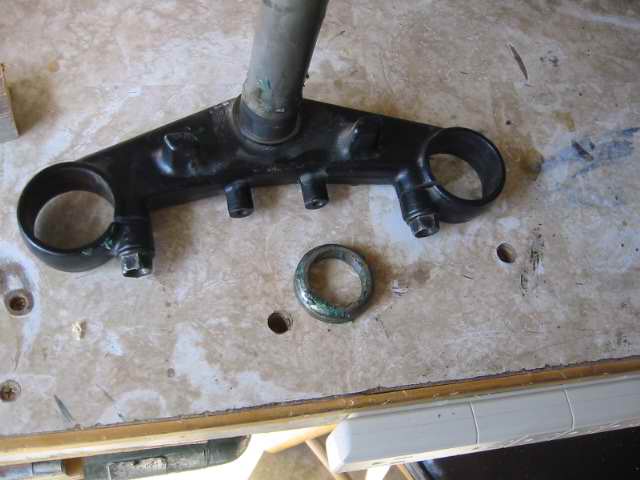

You can see where the ball bearing pitted the race

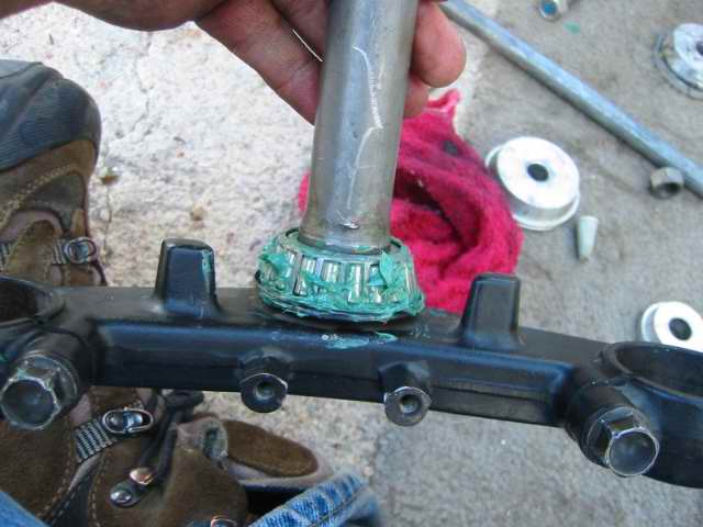

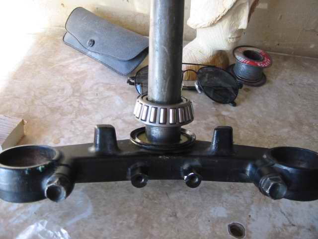

I gently clamped the column and started to hammer the race off
This was a bit awkward, I used a rag in the vice and hammered on each side until the race came off, it took about five minutes. ?I did not use a torch since I tend to burn myself with those. ?It just took patients and evenly hammering it so it would not twist and bind on the column.
Now its off
I saved the old races to use as hammers to make contact with the strong part of the new bearings to keep from damaging the tapered rollers.

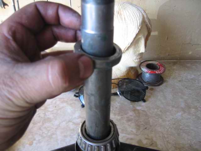

New dust collar and slide on the new bearing
The new bearings are binded with the outer races the old ones were separate pieces. I flipped the old race over and found a pipe that was long and wide enough to make contact and hammered the new bearing in.

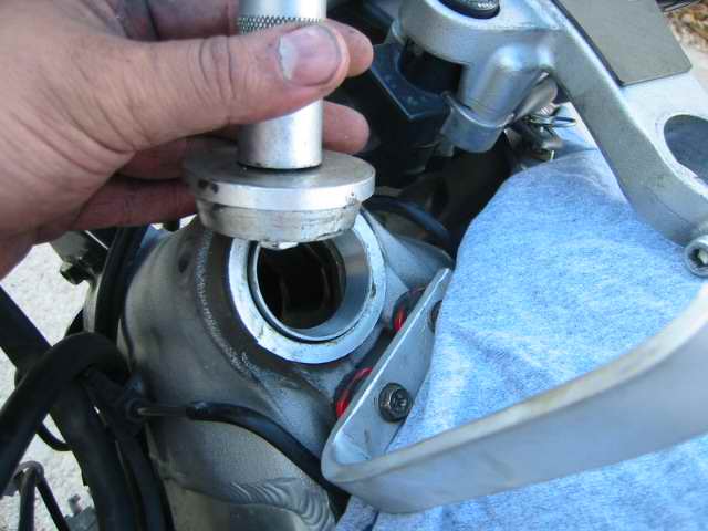

I have a bearing hammer that has interchangeable heads for different sized bearings, this one fit the top race just right.
Now the top race
its in, now grease the race surface good.

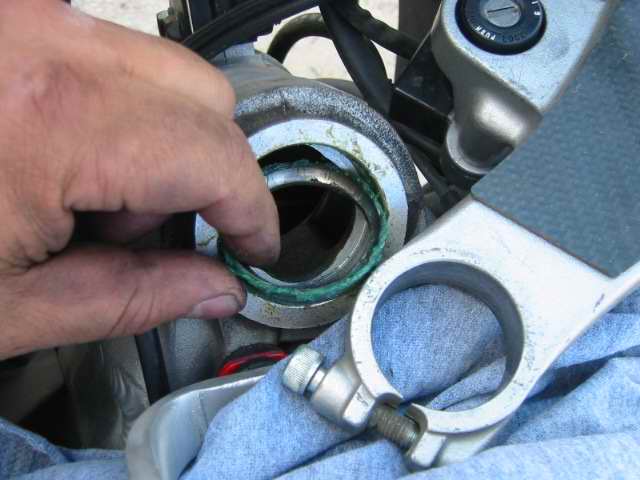

Put on the top dust seal
I screwed on the flange and tightened it not too tight so that it turned easy but not loose, over tight could ruin your new bearings, too loose and your in trouble. ?It should take about 7 lbs of force to move the handle bar fully assembled you should not feel it grinding thats too tight. ?Just as IntAcepter suggested I followed his procedures for the most part.
