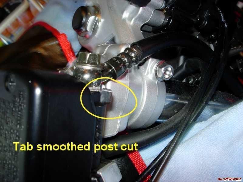

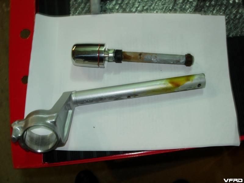

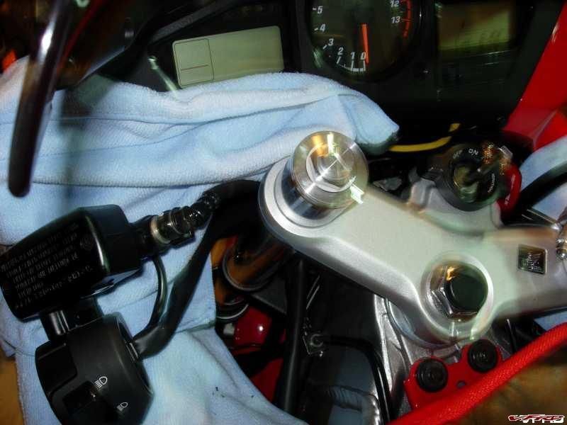

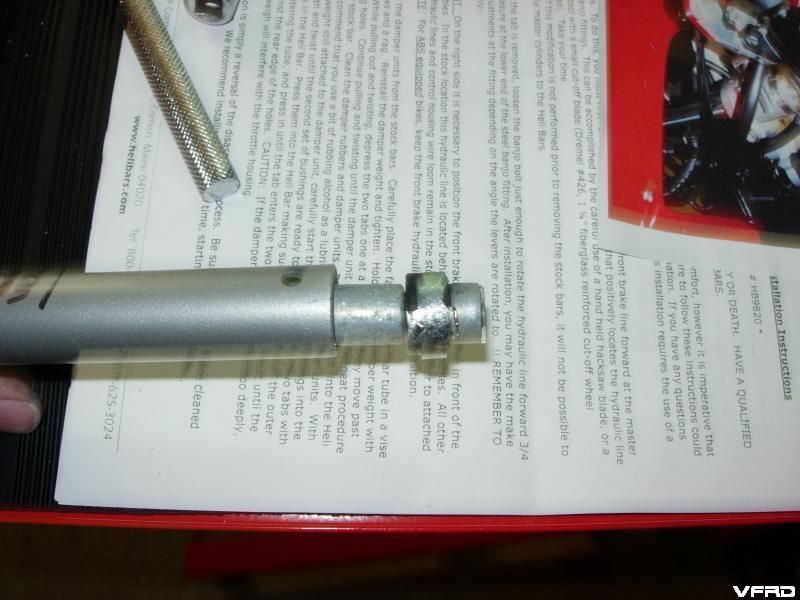

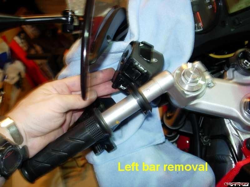

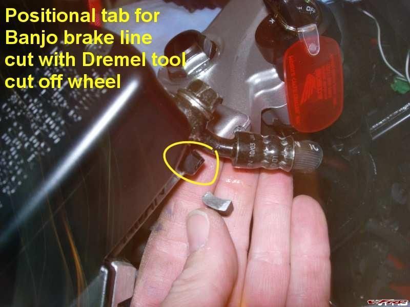

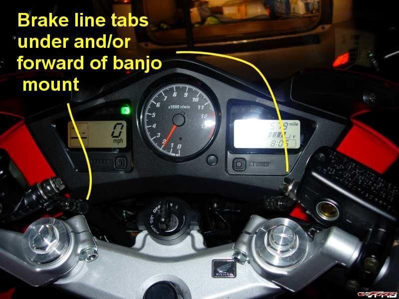

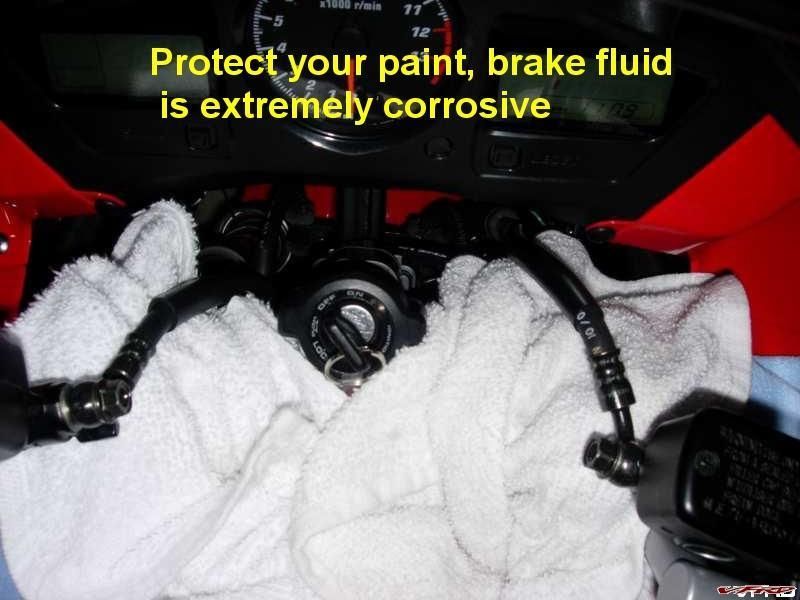

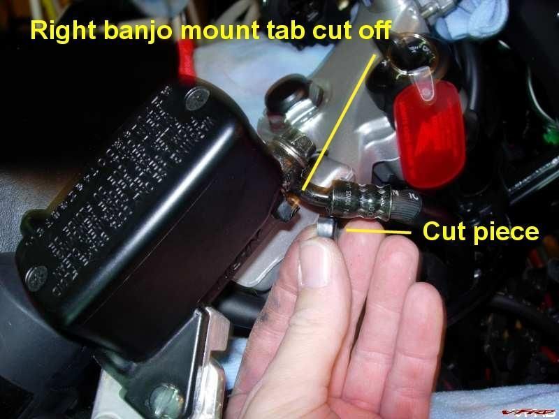

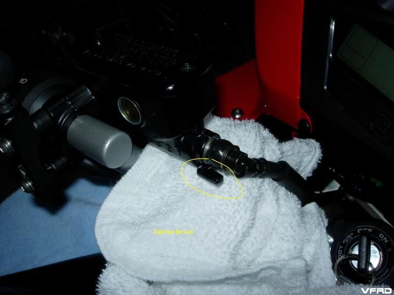

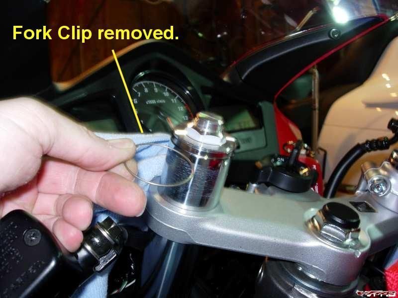

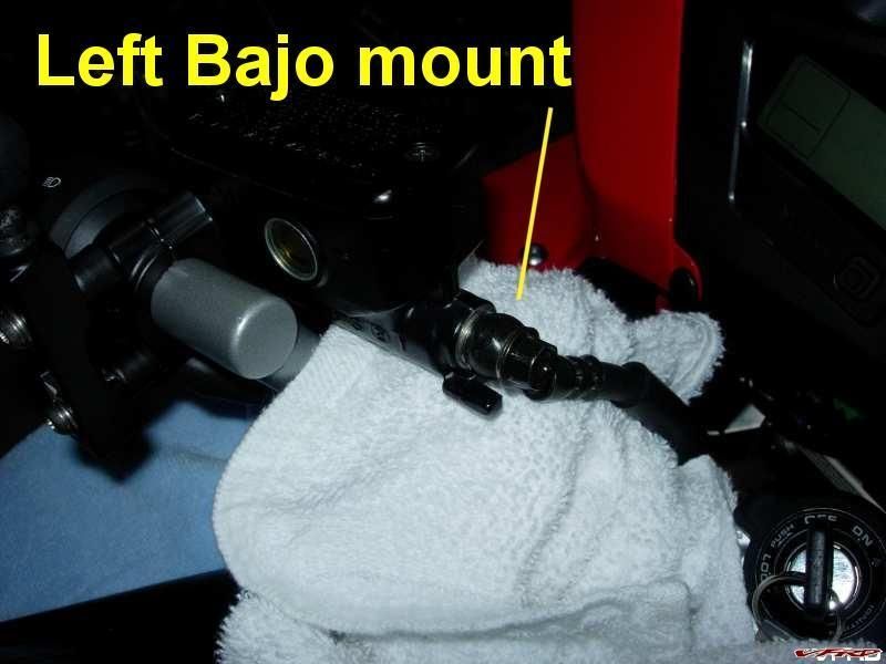

I had a tutorial on Helibar installation at one time. This was on my 04 6th gen.
anyways, here are the images once again.
Hope this helps & not too late for ya.
v/r

Rotating the clip while pressing in the tabs that hold the bar dampener in made it easier to pull them out. That way you don't need to hold the tabs in while pulling on the dampeners. Make sure you disconnect the wires on the switches at the brake master cylinder before trying to swap around the cable placement. I hadn't realized it was possible till they came out on their own.
Also, I did not need to cut anything off the master cylinders. Maybe it is because I have them moved all the way in on the handlebars. They do slightly touch the new bar clamps however.
