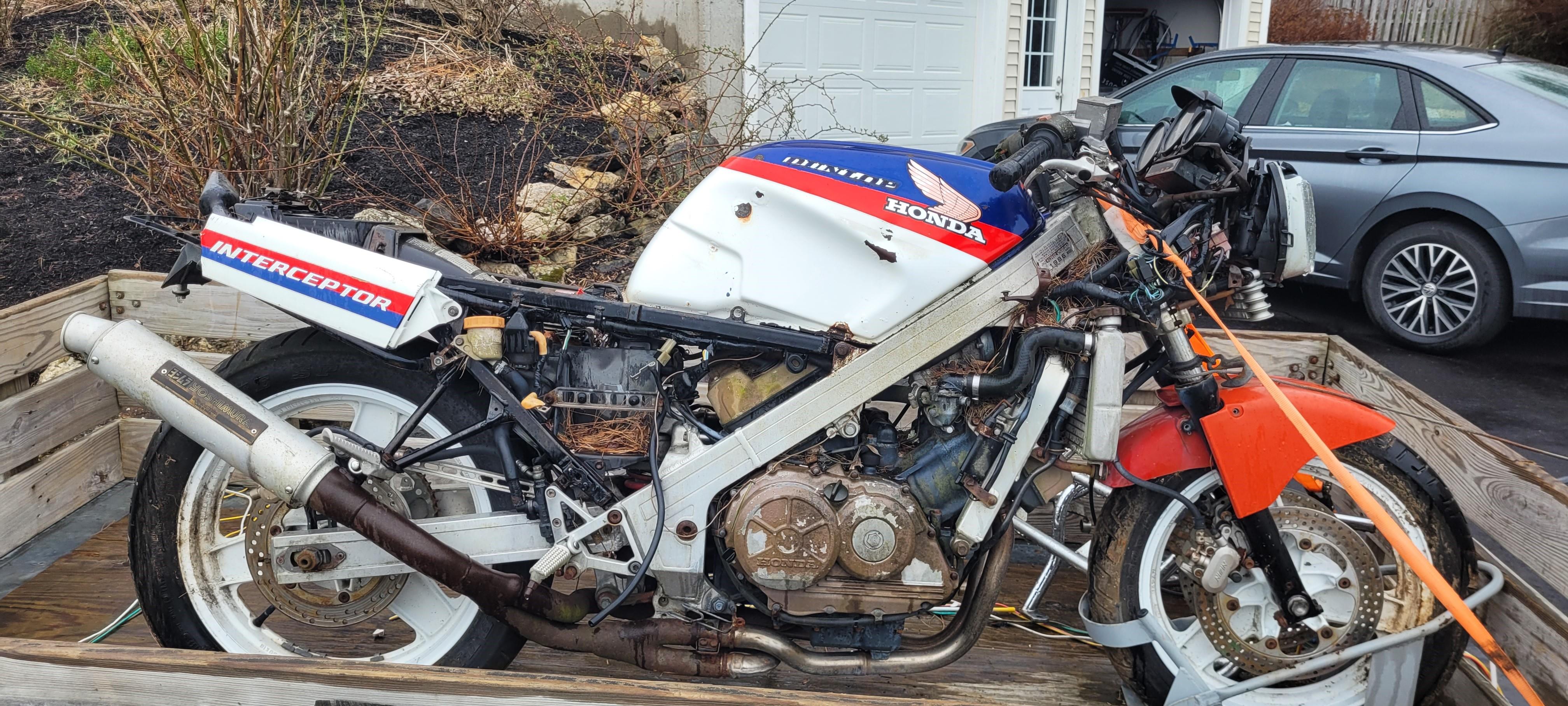

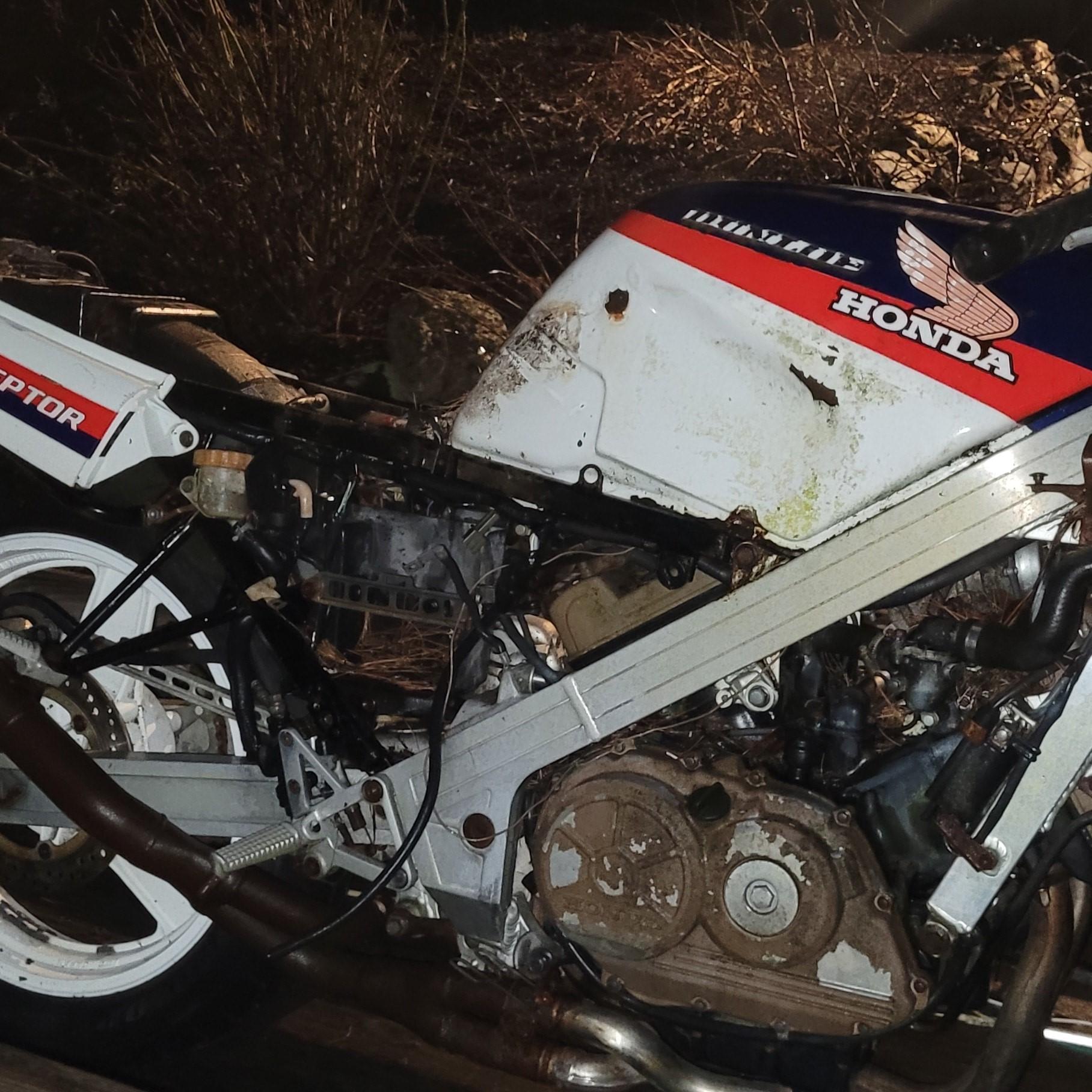

Hi guys,  I recently started another project bike that I pulled out from behind a barn in Maine a few weeks ago.  The bike had been lying on its side for more than 10 years.  The tank is toast.  had at least a half a tank of gas in it when it was stored and that dissolved into brown junk.  The tank has holes in it all around and would take a major advanced welder to be able to fix it.  Just wondering if anyone out there has a tank for a 86-88 they want to sell or if anyone knows if there is an aftermarket tank available?  I think I saw a post about a retired guy in CA who makes them from scratch?
thanks for the assistance

I have done a ton of work on it so far.  Taking the engine apart this week, 3 out of 4 spark plugs came out fairly easy.  1 is in there really bad, gonna need some heat the luck to get it out.
have a complete set of bodywork now, just need a complete brake light.  I will be posting some of my extra parts on FB marketplace soon.

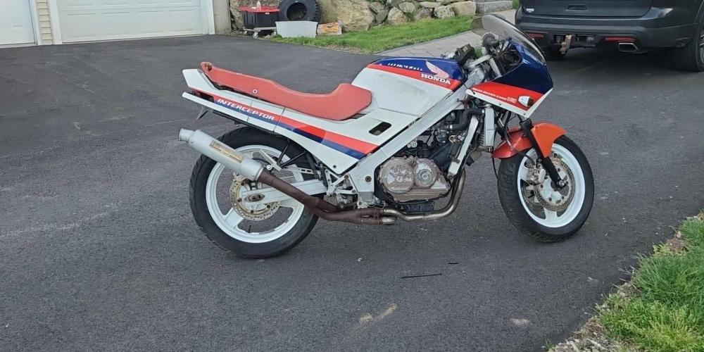

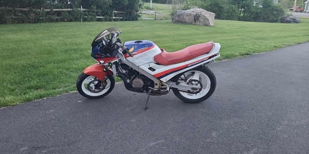

updated pics, found good lower fairings but just not in the pics.  Still working on the darn spark plug problem.  been tied up with my 86' ninja 1000r project.
