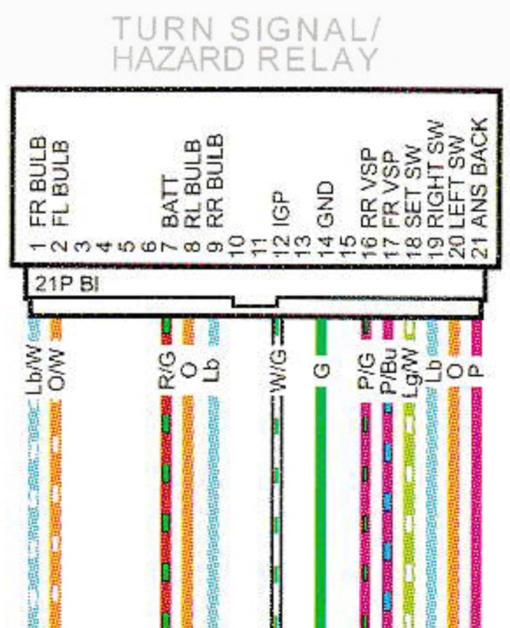

There is no need to sever both Front and Rear wheel inputs to the Turn Relay to disable the auto cancel function. Just removing/cutting the Front wheel input at the Turn Relay will do the job.
So at the Turn Relay its the Pink/Blue wire to Pin 17 being the FR VSP input.
Makes things a little simpler and easier to restore to normal if needed.
