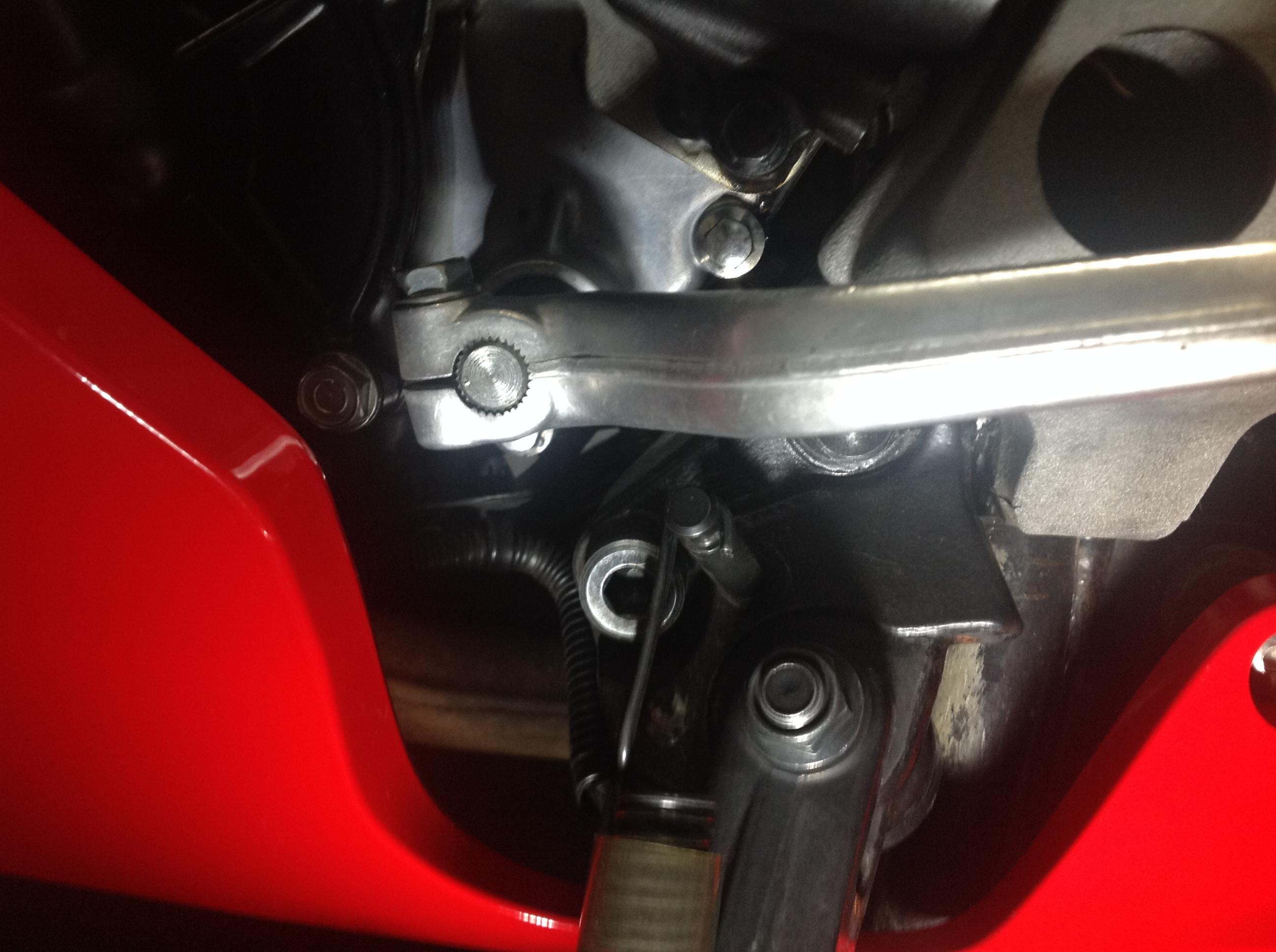

Two weeks ago I've installed OEM quickshifter in my 2014 VFR. Unfortunately yesterday was the track day and I lost part of it, this pedal covered in gum.
I have to return back to regular lever...
Does anyone can share with me photos how it is installed on your bikes. On rod coming from the engine there is a little dot so it will be good if that part will be visible.
Thank you all.
Hi mate.
Not too sure what you are requesting, but here is a picture of the normal gear shift lever in the standard position. As you can see the gear shaft dot is in line with the gear shift lever slot.
Is this the information you wanted?
2 minutes ago, mate said:
@Grum exactly that is the information 🙂 thank you very much 🙂
