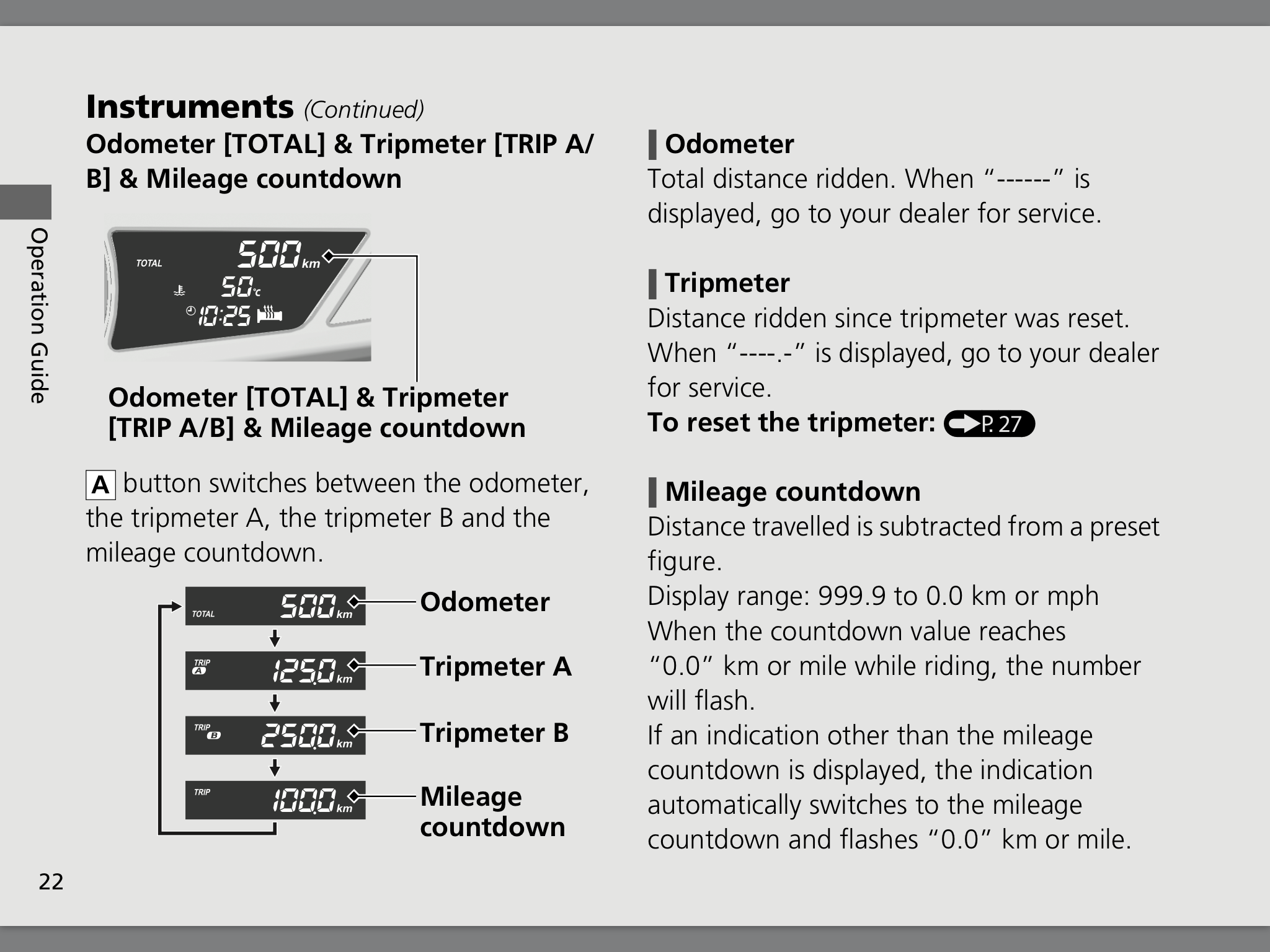

Hi Zane. There is no maintenance schedule warning on these bikes. I suspect you have the "Mileage Countdown" function active.

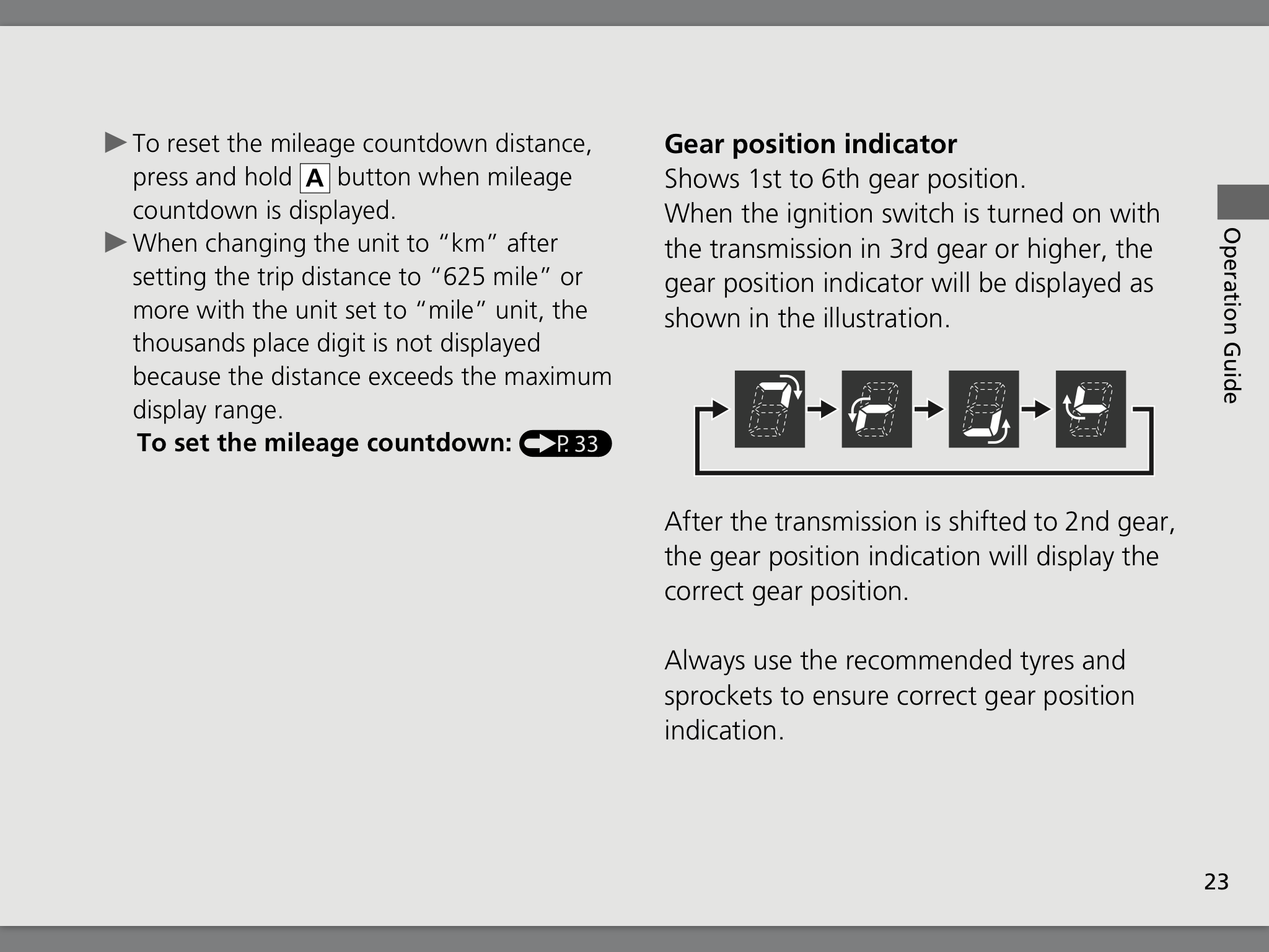

You need to make sure Mileage Countdown value is zero.(see top of page 23 to reset).
