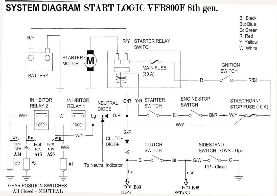

SgtMarbles Posted April 8, 2024 Author Posted April 8, 2024 2 minutes ago, Grum said: Now we're almost getting there BUT. You see, I've mentioned the combination of Clutch In and Sidestand Up.!! Does this always operate the Starter when pressing the Start button. Very Important to know this. This is the alternate path for the Starter Relay to energize Rather than the Neutral gear path. So establishing which path is faulty will zoom in on the faulty area. Info - On an 8gen Neutral Indication and Starter Relay coil grounding is done very differently to previous VFR'S. Not always, very rarely im able to start the bike without putting the kickstand up and pulling the clutch in. Quote

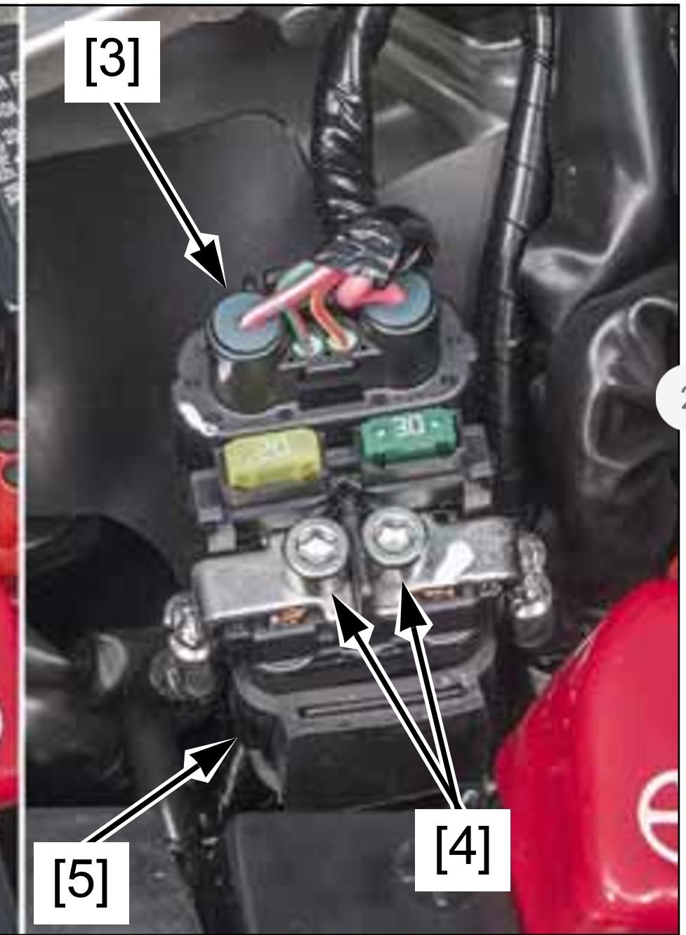

Member Contributer Grum Posted April 8, 2024 Member Contributer Posted April 8, 2024 On 4/8/2024 at 11:05 PM, SgtMarbles said: Yes, exactly! Im at the shop today. Ok so if you're hearing the Starter Relay Click EVERY time, then you most likely have an issue with the Relay internals, or a faulty main cable to the starter motor, or starter motor fault. See attached photo and remove the Starter Relay cover. When the fault is active. Grab your voltmeter, Ignition to Off. With your black meter lead to battery Neg terminal, now probe the two Main Terminals (4 see pic) on the Starter Relay with the other meter lead. One terminal should measure 12v. Now turn Ignition to On, bike in Neutral. Now probe the other Starter Relay Main Terminal, press the Starter Button. Do you hear the Relay click AND Measure 12v.? Is the Starter Motor spinning? If you hear the Relay Click but Don't measure 12v. = Probable Starter Relay faulty/Intermittent. Another brutal Test is to simply use a couple of screwdrivers shorting the two main relay terminals. Do this with Ignition Off and Make sure you're in Neutral. The Starter Motor should spin over every time you make the short, if it does then you don't have a starter motor or main cable issue. You can download the Service Manual from this site if you don't already have it. It will show how to fully test the Starter Relay. By the way. What was the brand, type and part number of the new Battery you fitted? And it's Fully Charged? Bedtime for me. Let's know you get on. Nighty night! 1 Quote
