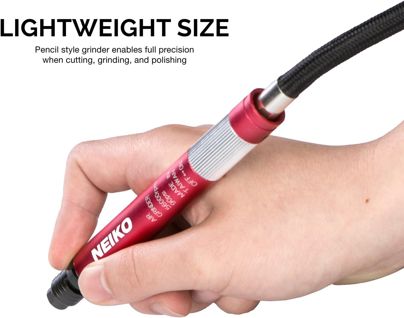

Member Contributer DannoXYZ Posted March 16, 2021 Member Contributer Posted March 16, 2021 I second air grinder suggestion, and recommend micro 1/8" size. I bought one of these 10-yrs ago and it's going on strong. Got it to replace Blue Point brand one that lasted 10-yrs. Which was purchased to replace Dremel. I prefer smaller lighter form factor of 1/8" air tool for porting & polishing heads. Just like using pencil, it can reach into smaller tighter areas than Dremel. Lighter weight and pencil grip is less tiring to use. https://www.harborfreight.com/pneumatic-18-in-micro-die-grinder-kit-60244.html earlier https://www.ebay.com/itm/Air-Micro-Die-Grinder-Kit-Pencil-Polishing-Pneumatic-Tool-58000RPM-1-8-Collet/223635755486 1 Quote

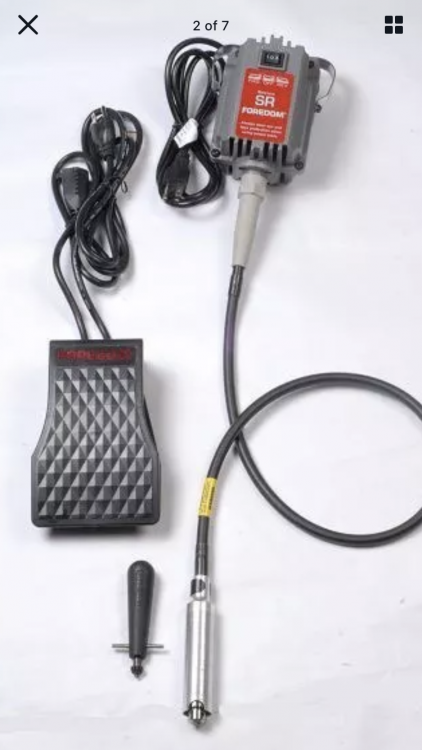

Member Contributer Stray Posted March 16, 2021 Author Member Contributer Posted March 16, 2021 Wooo, you boys brung out the big guns - I‘m loving the selection! Wish I could go with an air tool but my compressor’s not up to it and it’s tucked away. I only wheel it’s out for a task once a year and then put it away again. Plus noise would have neighbours up in arms! I do like that pencil tool Danno! Magneto, looks like your Black & Decker is the RTX after all. You’ve got more grinding tools than any man should have! In the end I bought a Foredom pendulum grinder. The 220v version they make for Europe. At £67 it’s slightly cheaper than the Dremel 4000 and gets excellent reviews from industrial users so I’m taking a punt. Plus it comes with a foot pedal to modulate speed- how cool is that! It’s got a very weird name. Cross between foreskin and femdom: Foredom. If it plays nice I may buy a pencil type tip like Danno’s for it (they’re cheap and quick change). One thing for sure is whilst I’ve been researching a decent rotary tool every site I visit is full of disappointed Dremel owners. I feel very let down by them as they’re widely regarded to be the best. Seems their reputation is ill deserved... Stray 2 Quote

Member Contributer Stray Posted March 16, 2021 Author Member Contributer Posted March 16, 2021 10 minutes ago, Cogswell said: Sounds like they have some interesting people in their marketing department. Maybe they'll be coming out with a line of vibrators soon . . . Apparently they have very high torque motors that can go for hours without overheating so you may be on to something, Cogswell! So if I’m looking to do a little grinding and “her indoors” has pilfered the Foredom, should I knock on the bedroom door or wait politely? They look like this, by the way: 3 Quote

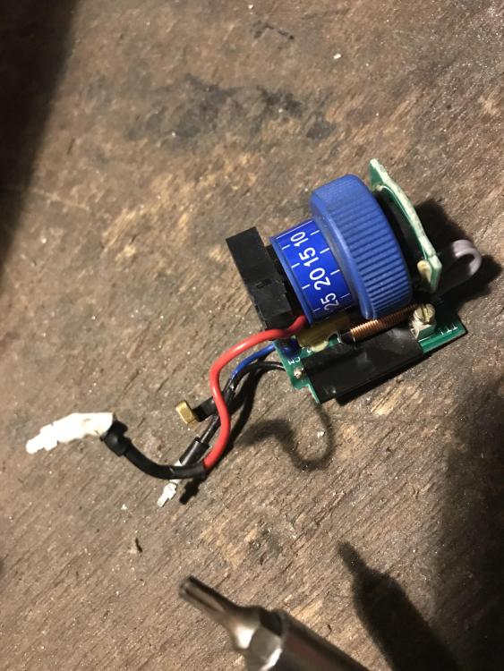

Member Contributer Stray Posted March 19, 2021 Author Member Contributer Posted March 19, 2021 Update: I repaired the Dremel 4000. Faulty switch. God bless YouTube tutorials! It’s just a little thing but what a nightmare packing all the wires in properly so they don’t foul or catch the slider/armature. Then trying to seal the cases without the brush springs shooting out whilst seating the circuit boards flush. May as well be trying to put toothpaste back into the tube! The sliding switch is a glaring example of poor design and I’m shocked Dremel still employ this crude technology. It’s prone to wear of the knob that actuated the switch. Anyway, I no longer trust this tool to be my main precision grinder so I’ve packed it away and will rely on the Foredom. Dremel might get an outing occasionally if lucky. Stray 2 Quote
