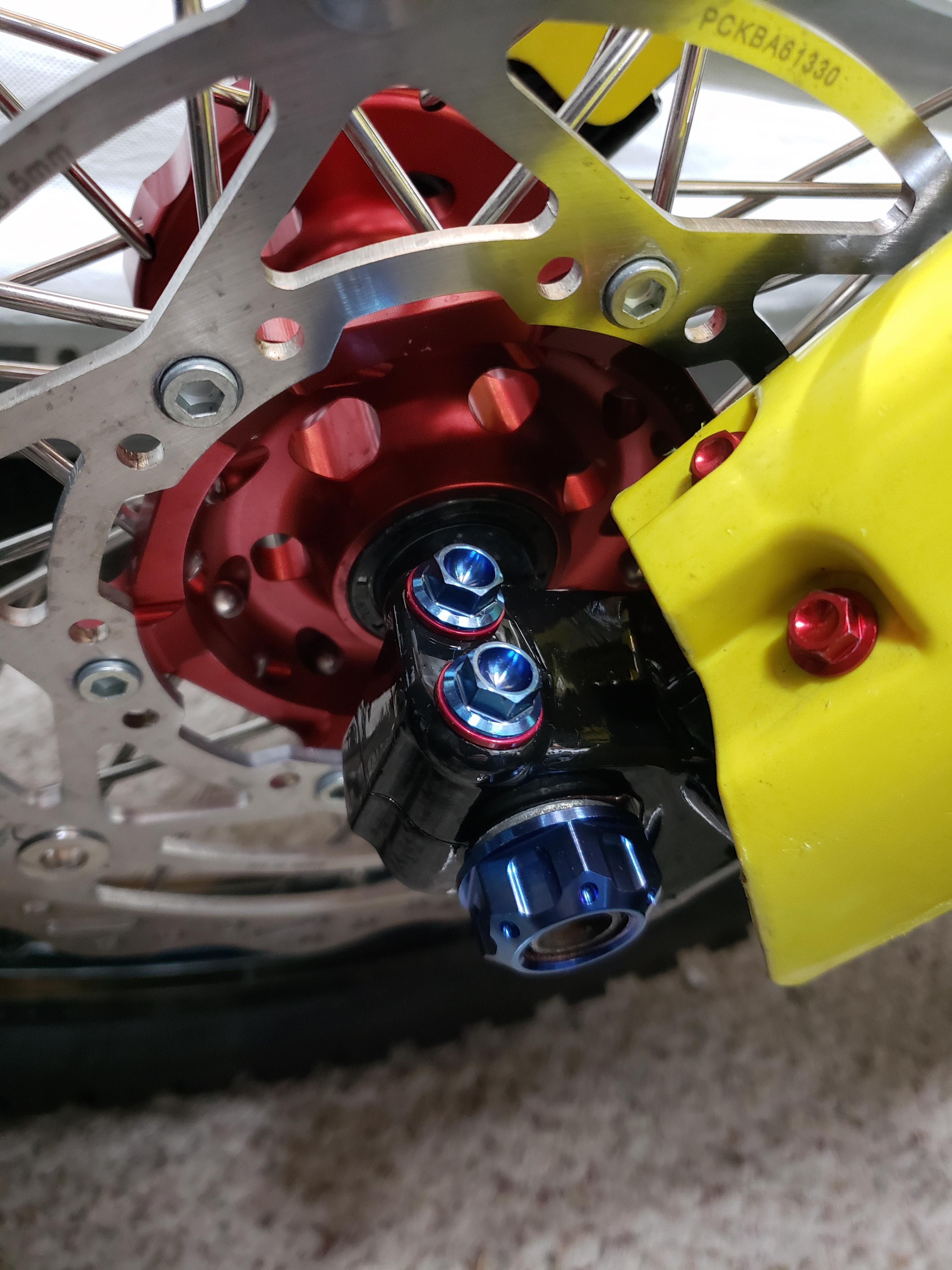

Member Contributer RC1237V Posted February 2, 2021 Member Contributer Share Posted February 2, 2021 Yep, I like that one - I just don't want to start down that road on the Street Fighter. I already did up the DRZ with Ti and Aluminum all over, and it was eye opening as to the cost... I took a few pounds off the bike, but I spent around $500... Quote Link to comment Share on other sites More sharing options...
Member Contributer DannoXYZ Posted February 2, 2021 Member Contributer Share Posted February 2, 2021 1 hour ago, RC1237V said: Yep, I like that one - I just don't want to start down that road on the Street Fighter. I already did up the DRZ with Ti and Aluminum all over, and it was eye opening as to the cost... I took a few pounds off the bike, but I spent around $500... Yeah, replacing nuts & bolts costs A LOT per-gram shaved. Best to actually start from biggest bolts first, such as any solid axles, brake-caliper bolts, sub-frame bolts, etc. On my race Ninja 250, replacing both front & rear wheel-axles with titanium saved 900gm! Honda's got some extremely trick heat-treated hollow chromoly brake-caliper bolts on their CBR600RR. Even hole at end is tapered and beveled! Couldn't believe it 1st time I disassembled brakes. It's as light as Ti bolts! Quote Link to comment Share on other sites More sharing options...

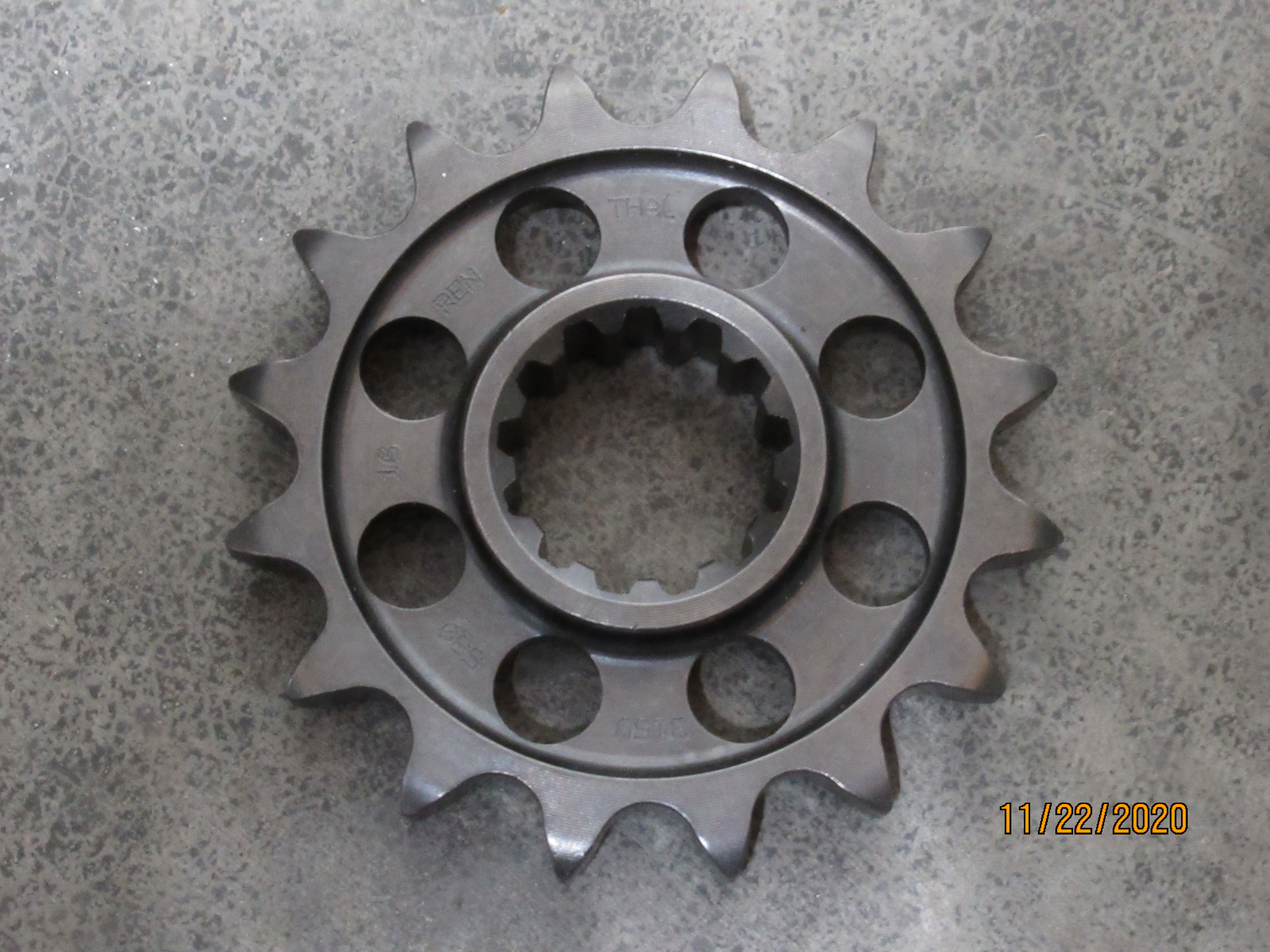

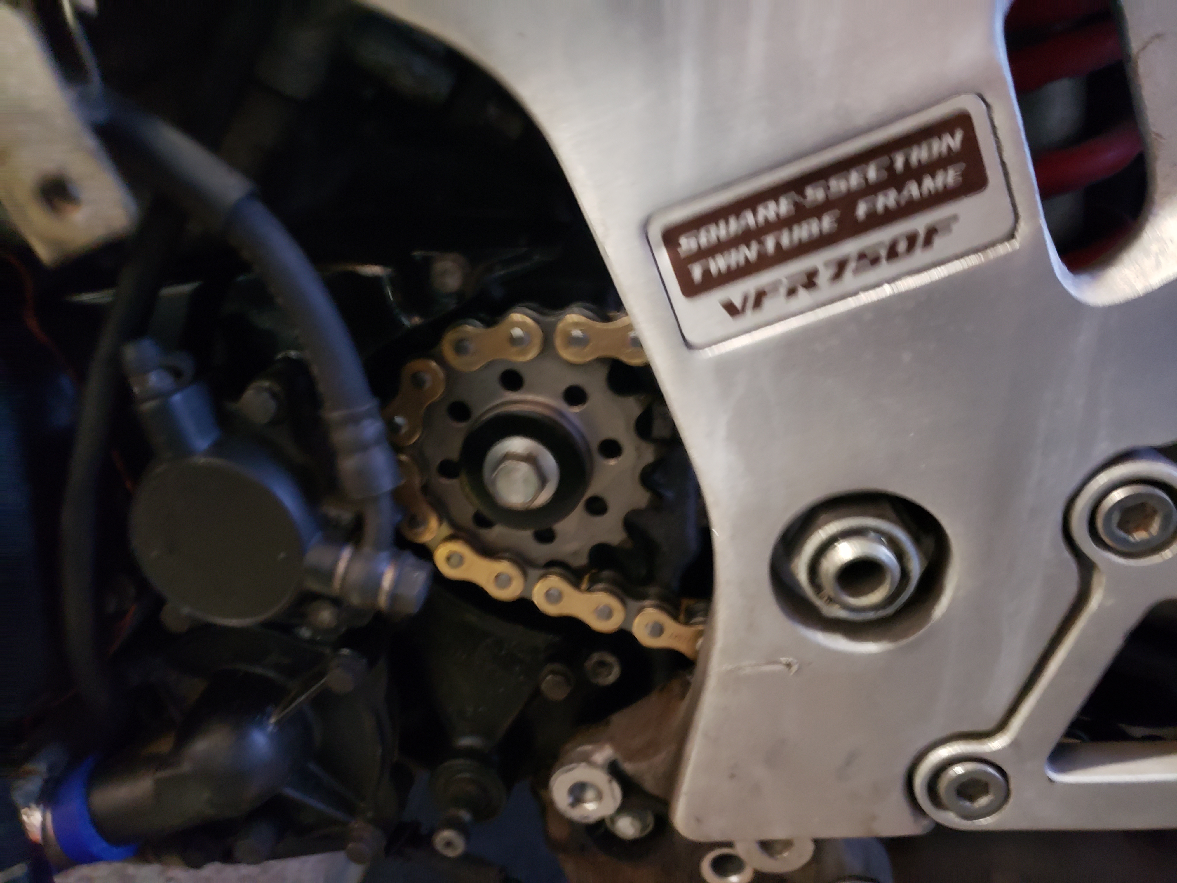

Member Contributer jefferson Posted February 9, 2021 Author Member Contributer Share Posted February 9, 2021 Got some good news out of the UK today as it looks like my sprocket is going to be shipped. No idea how long it will take to get here. Looking forward to attaching it with the titanium sprocket bolts. Got the front sprocket off and weighed and the difference between the Renthal and stk was .14 lbs. The Renthal is almost too pretty to put on to be hidden. The lightening and opening up of the sprocket cover I don't believe will make it much more visible. The sprocket cover is .13 lbs. lighter and I may open up one more area. Quote Link to comment Share on other sites More sharing options...
Member Contributer jefferson Posted February 9, 2021 Author Member Contributer Share Posted February 9, 2021 On 2/1/2021 at 6:53 PM, RC1237V said: Looks like all the 800's and the CB1000R used a 16X51mm bolt, and all the 750's used the "heavy pig" 16X60 bolt, which is why they weigh more than an 800 😆 Heavy pig is right. It weighed almost a quarter pound at .22 lbs. Quote Link to comment Share on other sites More sharing options...

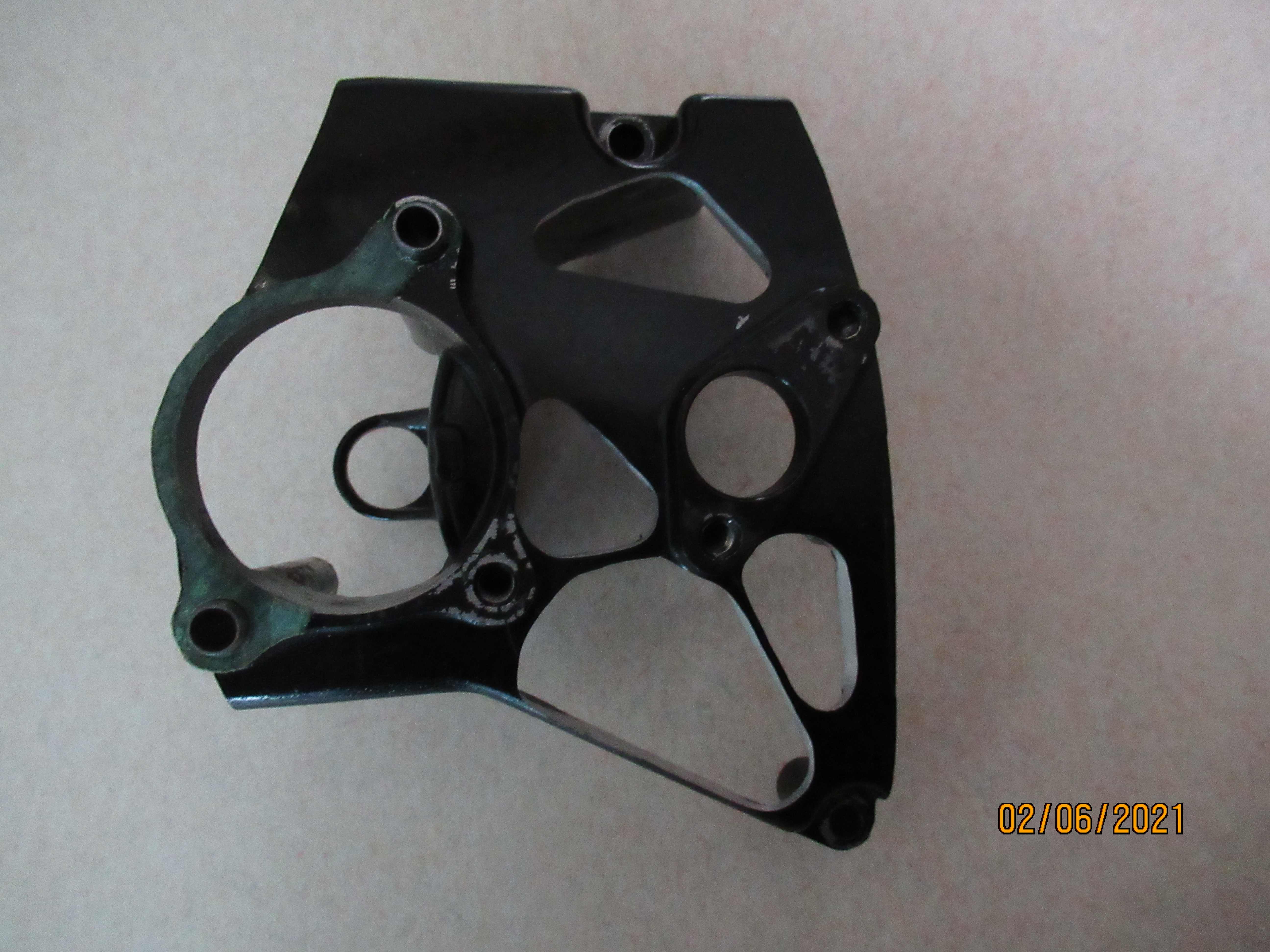

Member Contributer RC1237V Posted February 10, 2021 Member Contributer Share Posted February 10, 2021 The sprocket cover cannot be completely cut unless you want to loose the speedo drive, or get a digital speedo... Quote Link to comment Share on other sites More sharing options...
