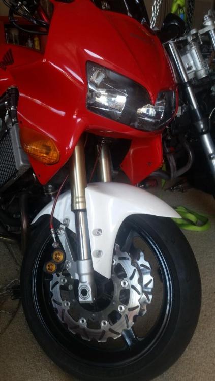

Ive put the wide bars as I even the standard bars are too low for my worn out wrists. And the forks were just because I could.
In case you're I'm also thinking of putting all my boxes of bits and the 2006 up for sale. It has a great motor, Shock Treatment upgraded suspension, rear sets, panels, ect ect ect.

The R6 forks seem quite OK, but I'm yet to push it's limits.
