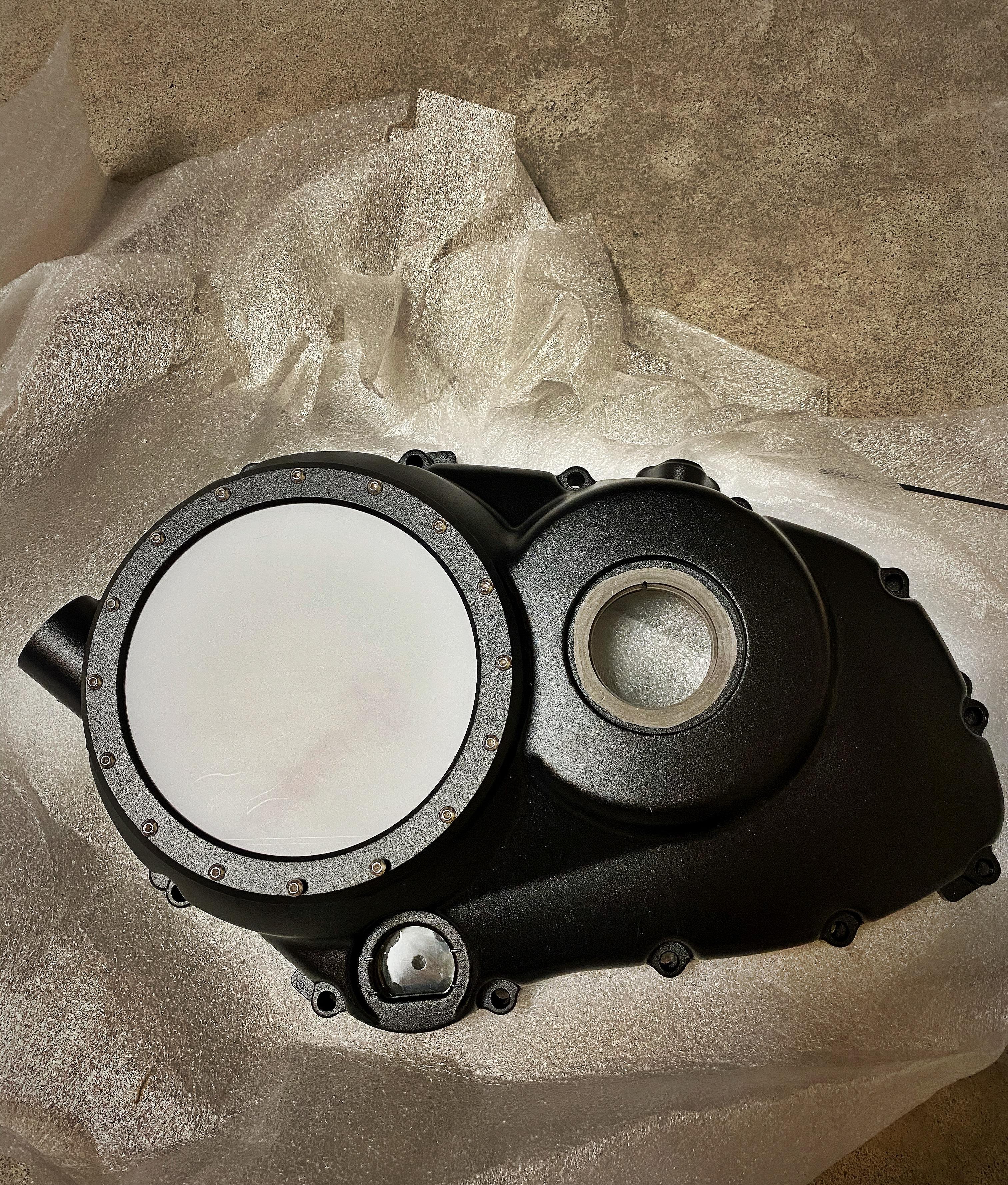

So I have been sitting on one of Sebs clear clutch covers for awhile now (not literally sitting on it of course)
Now, before I install it I have been really huming and hawing over whether I should replace some, if not all, of the clutch bits while I am in there.

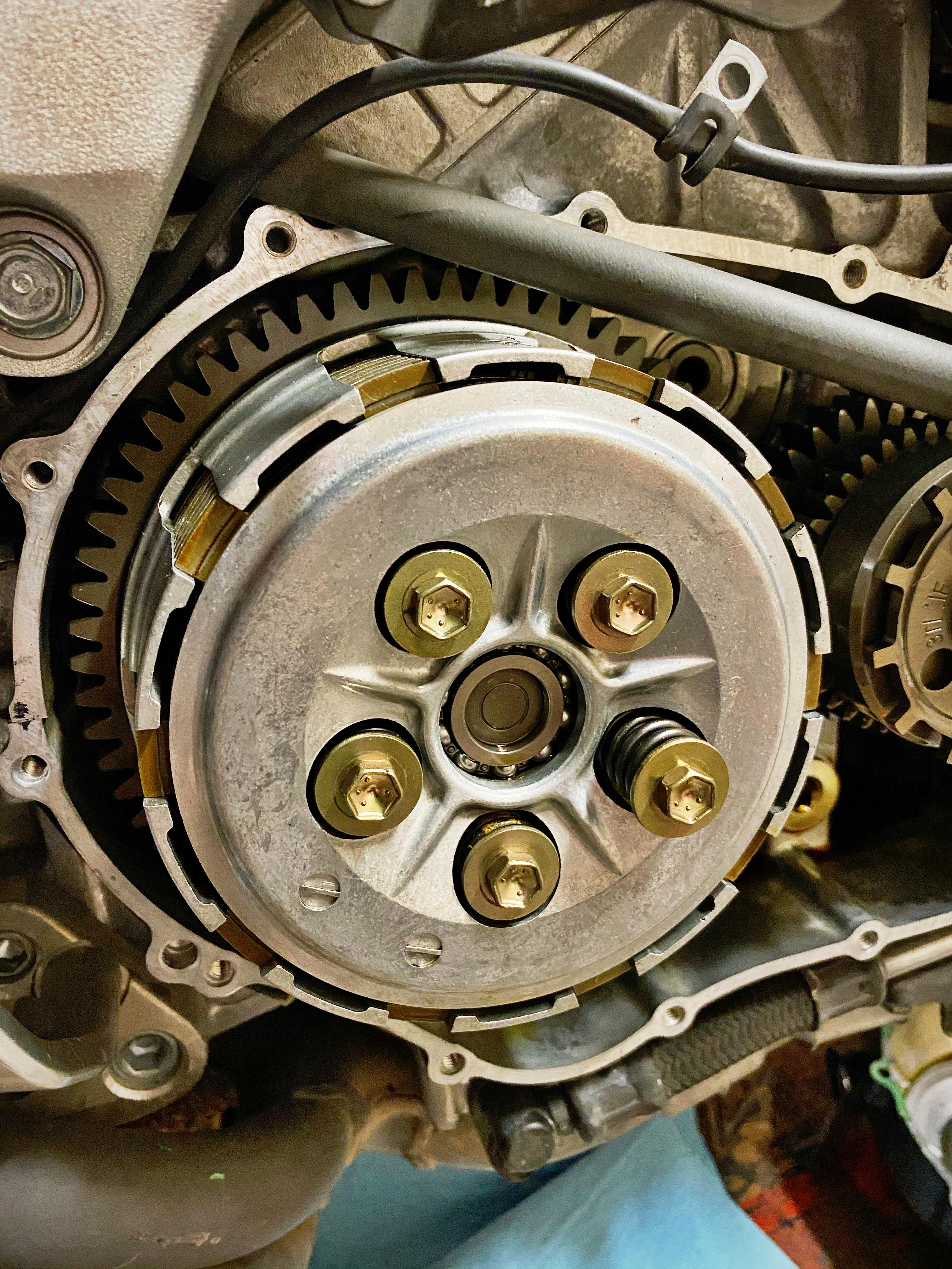

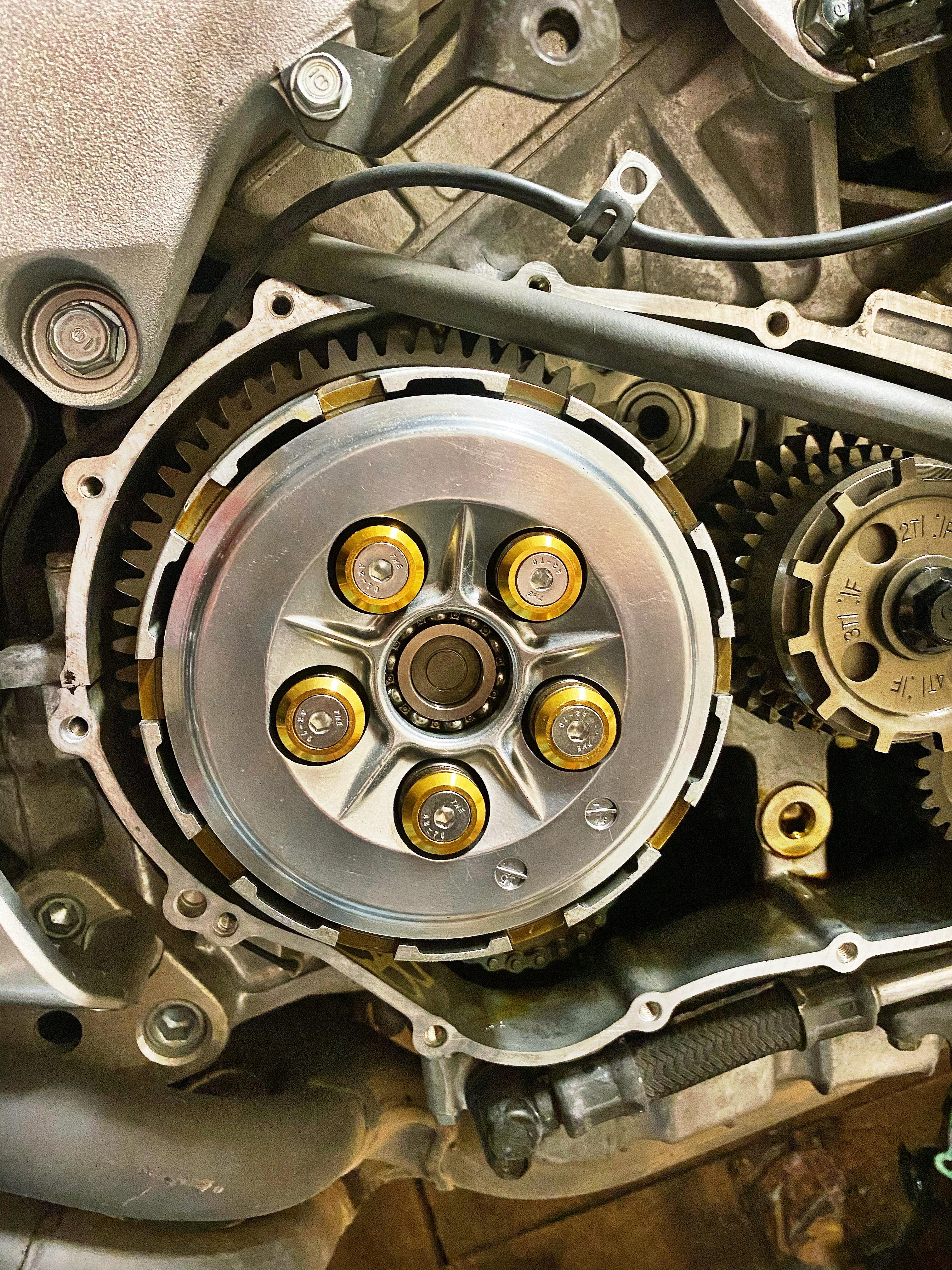

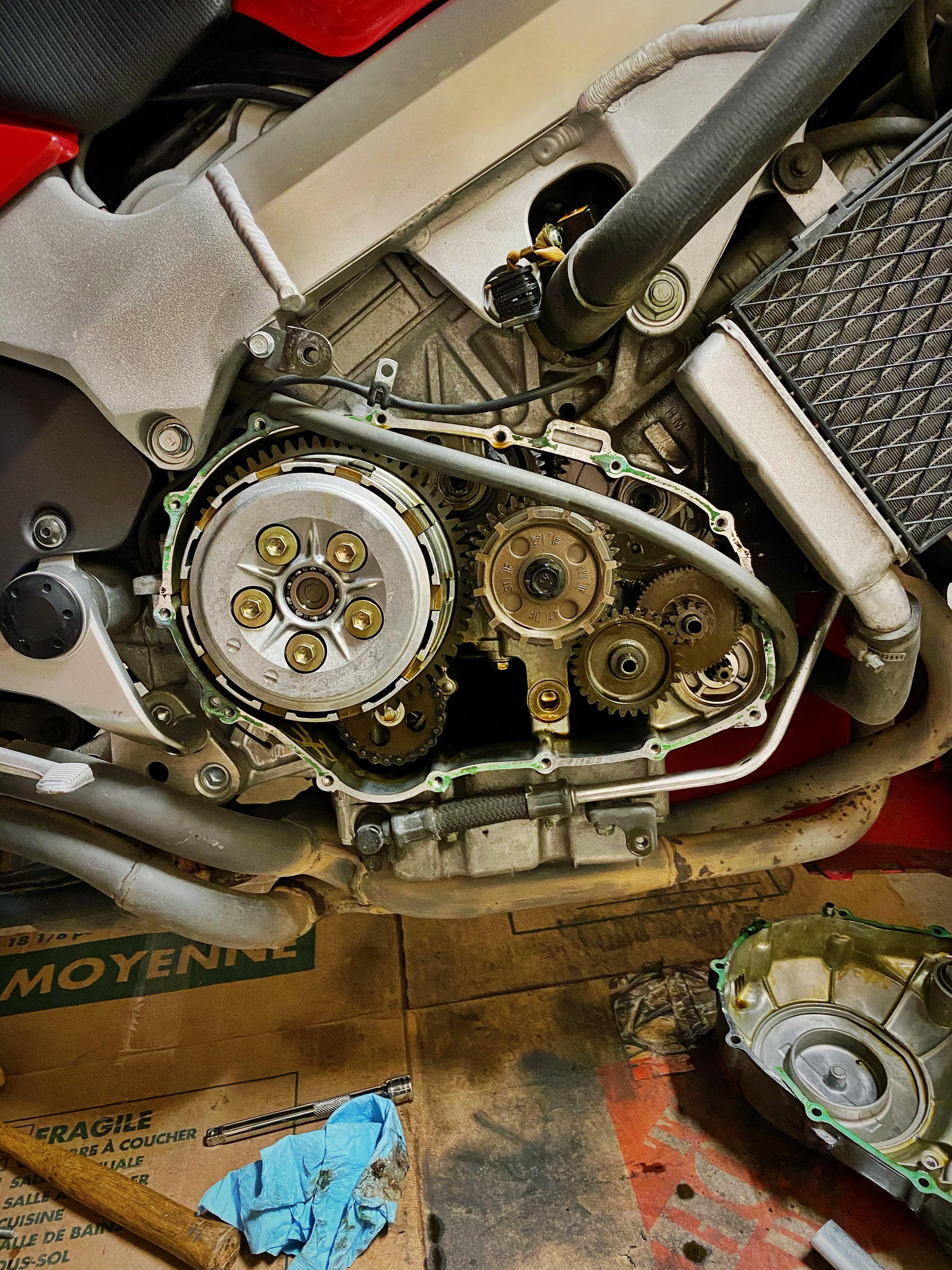

So I finally had a free day and got crackin on the clutch cover.
 Removing the clutch cover was a bit tough. It was really stuck on there, and I really had to yank on it to get it off.
Usually I find the most difficult and tedious process of doing something like this is removing the old gasket material but it came off surprisingly easily with my new gasket scraper tool.

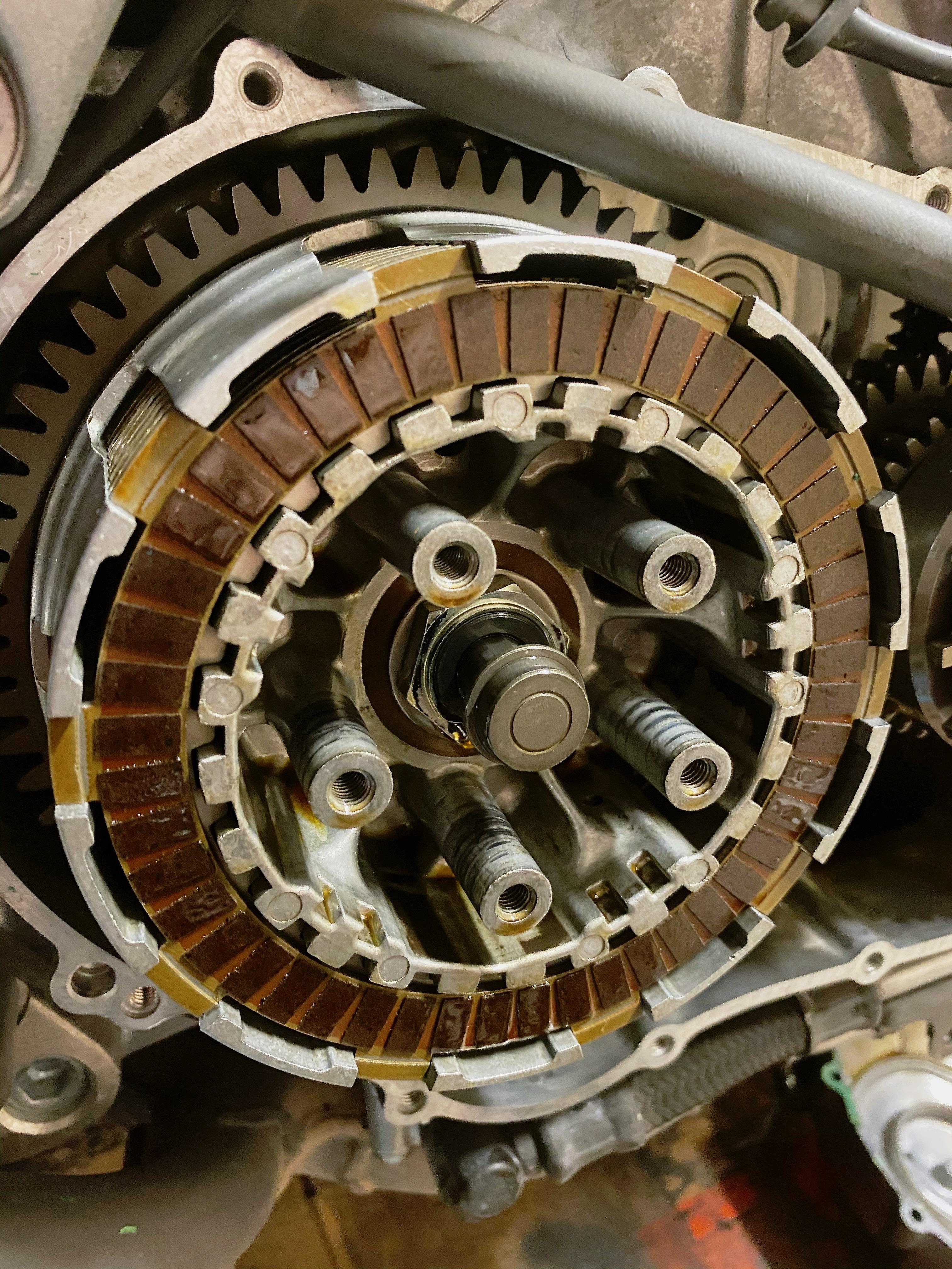

After that it was time to pop off the old clutch plate and spring bolts.

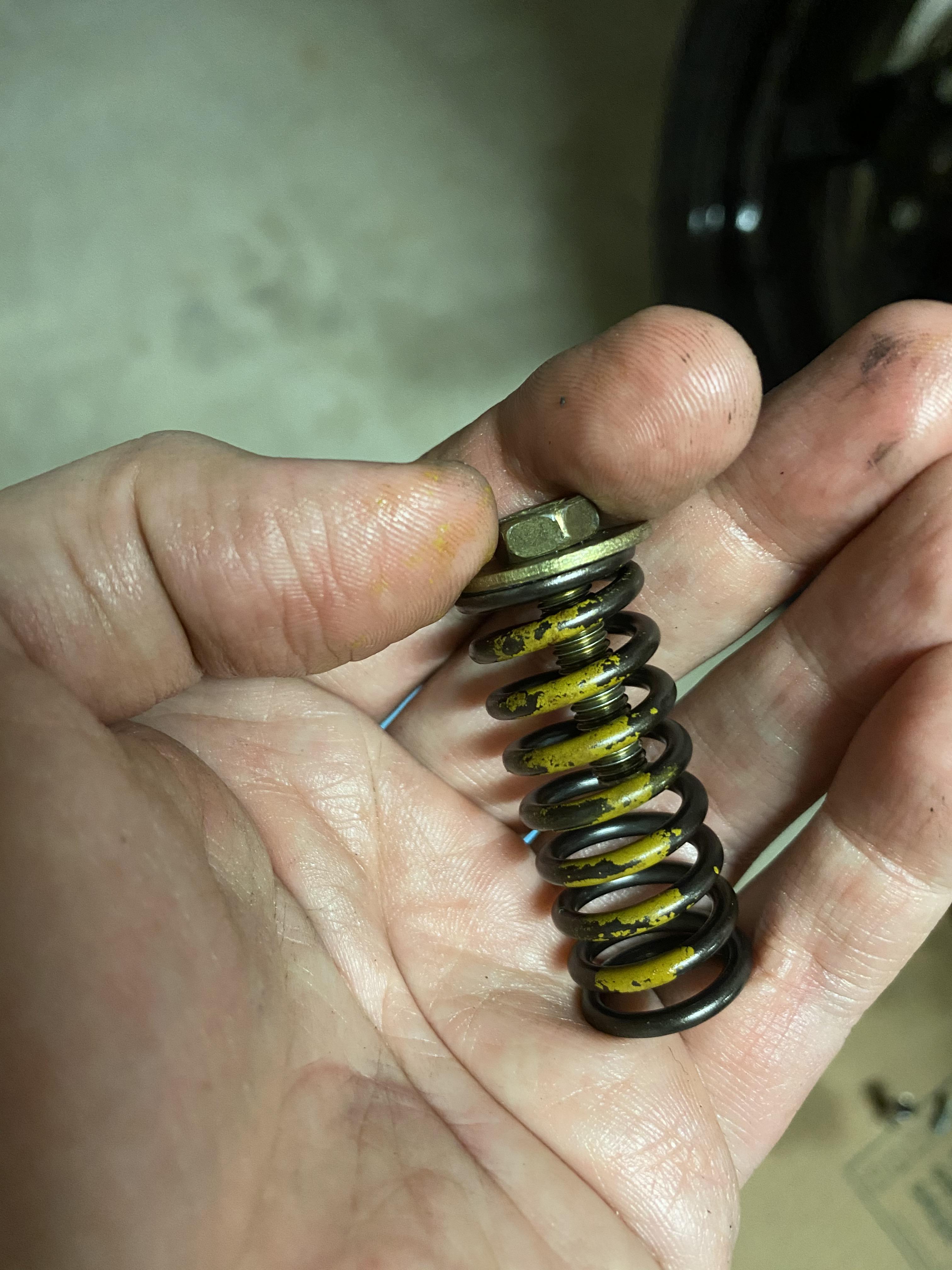

I inspected the clutch disks and plates and they seemed fine. The Clutch springs measured within spec but they had this strange yellowish goop on them.
 I thought maybe it was paint but it came off with some light scrubbing. 🤷‍♂️ I don't know.

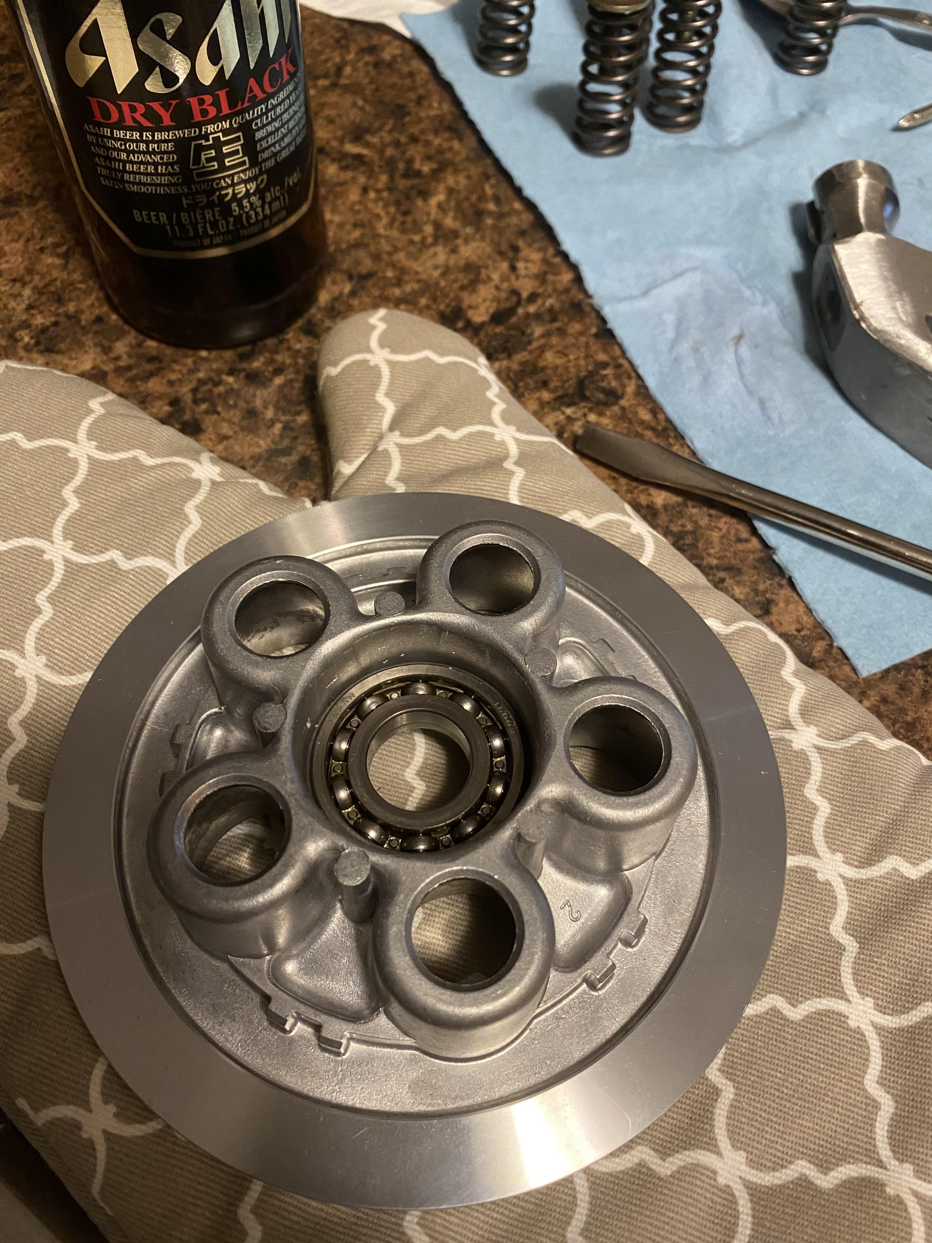

Now this is where I hit a bit of a road block. The bearing that sits in the clutch plate would not go in easily...and by easily I mean it did not want to go in at all. it came off the old clutch plate easily but I couldn't put it in the new one at all.
I tried everything. Heating the plate and putting the bearing in the freezer. trying to smoothen out the inside of the plate. Light tapping....nothing.
I ended up tapping it in there pretty hard. It was the only way.
The bearing now feels a bit notchy when I spin it 🤦‍♂️
So I've buttoned it up for now and the bike feels fine, but I'll have to order a new bearing and polish up the old clutch plate and go back and replace them.

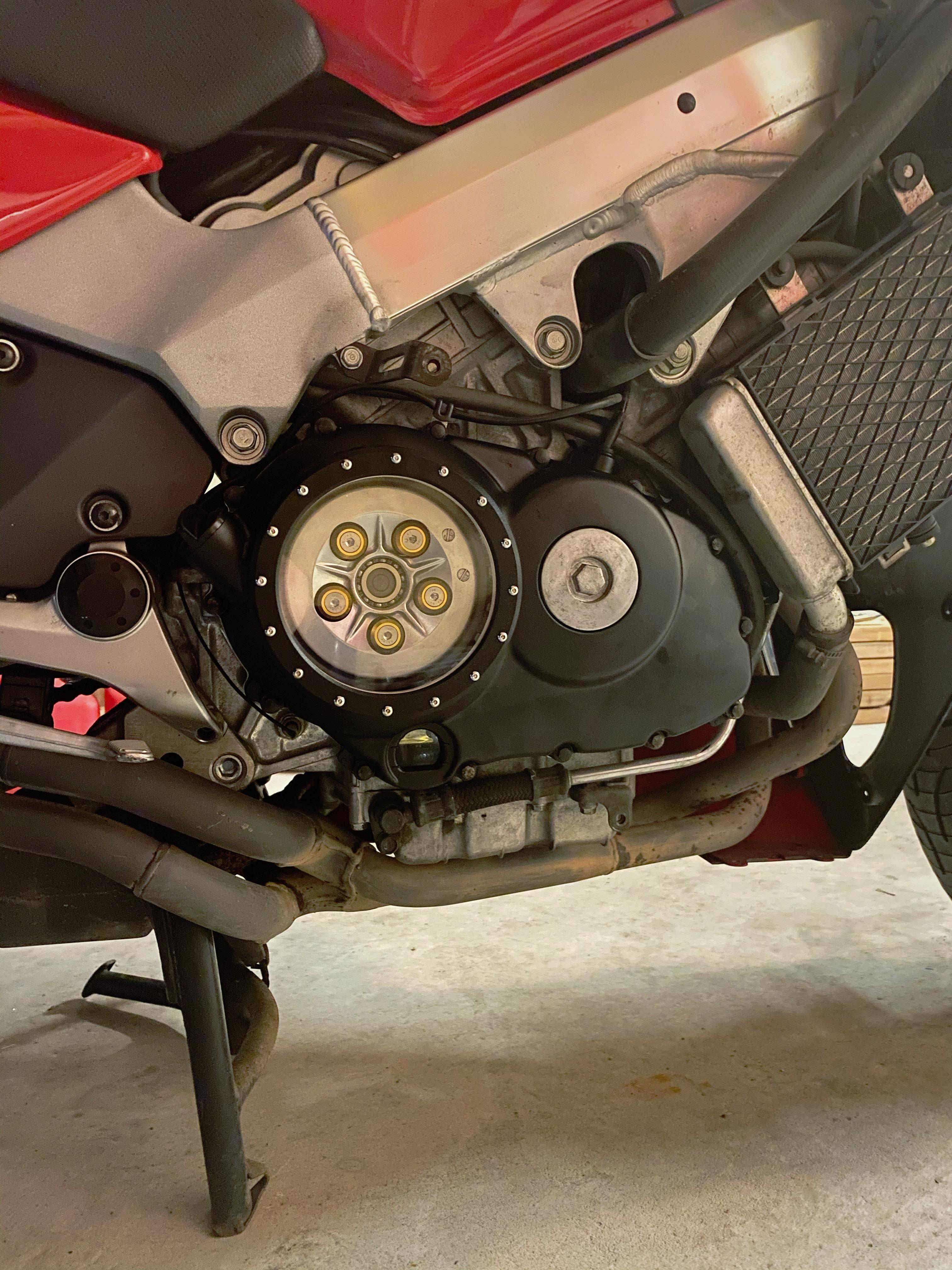

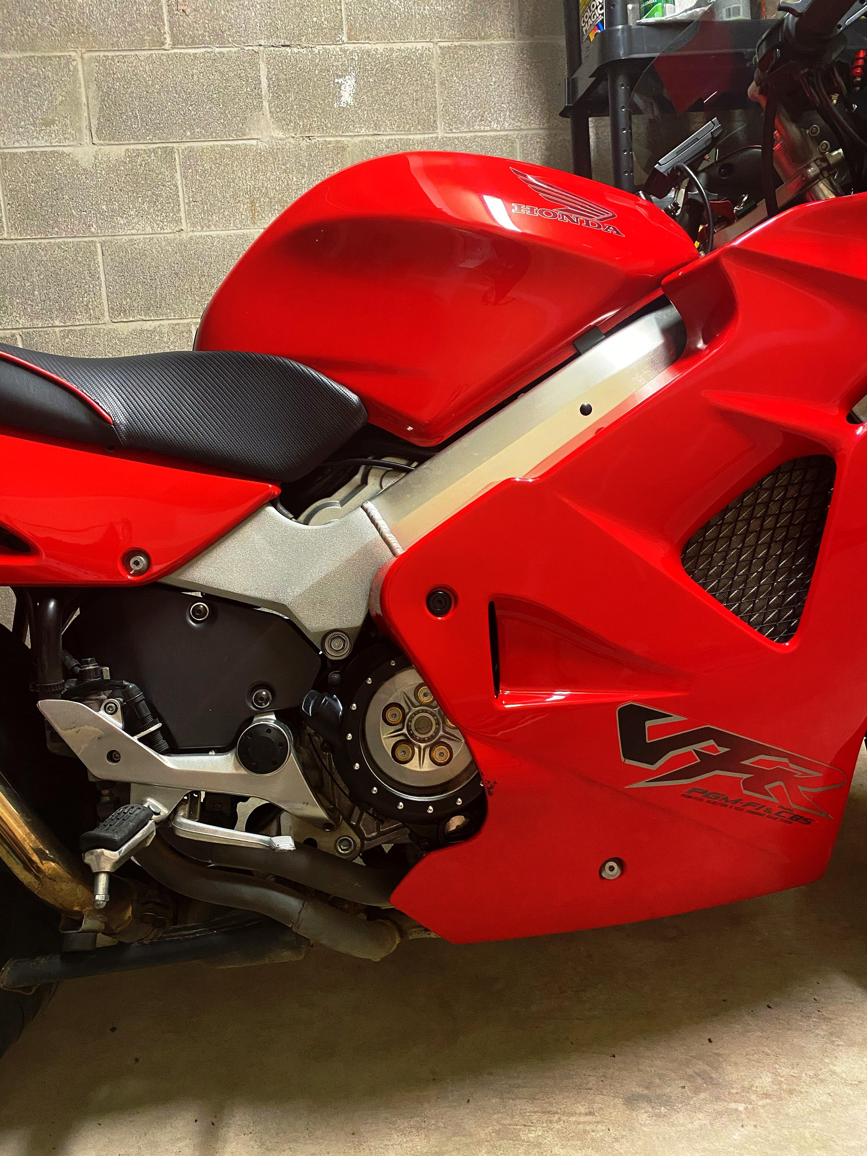

Here is the finished product.

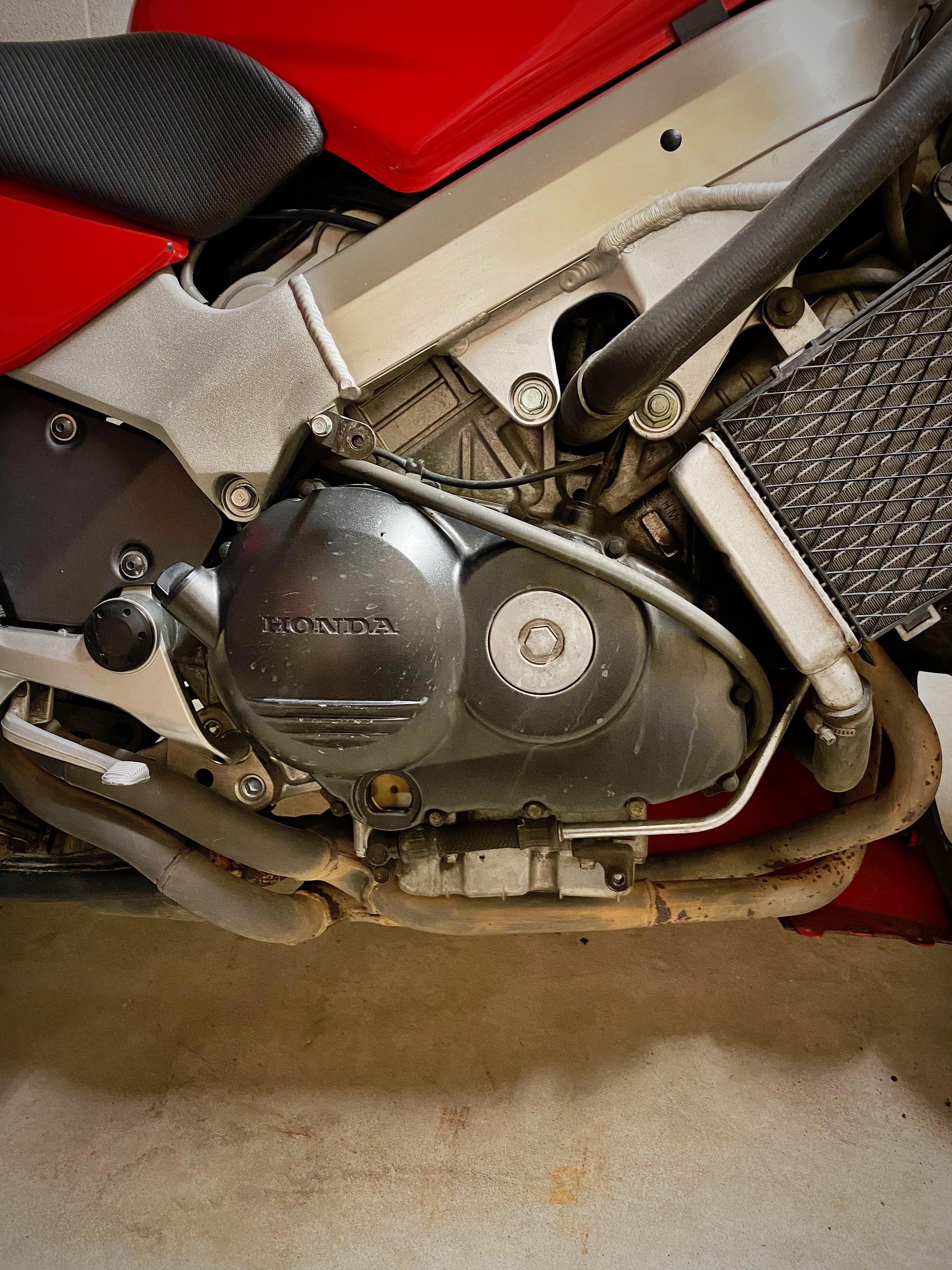

EDIT: Just thought I'd post an update since I am getting messages about the install. I ended up putting the original stock cover back on because this one was leaking oil from the sight glass window. I didn't have time or space to keep messing with it so I ended up selling the cover and going back to stock.
That yellow paint is "OEM", i.e. new parts have it too.
