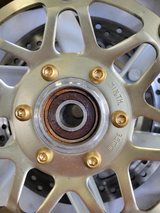

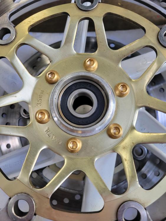

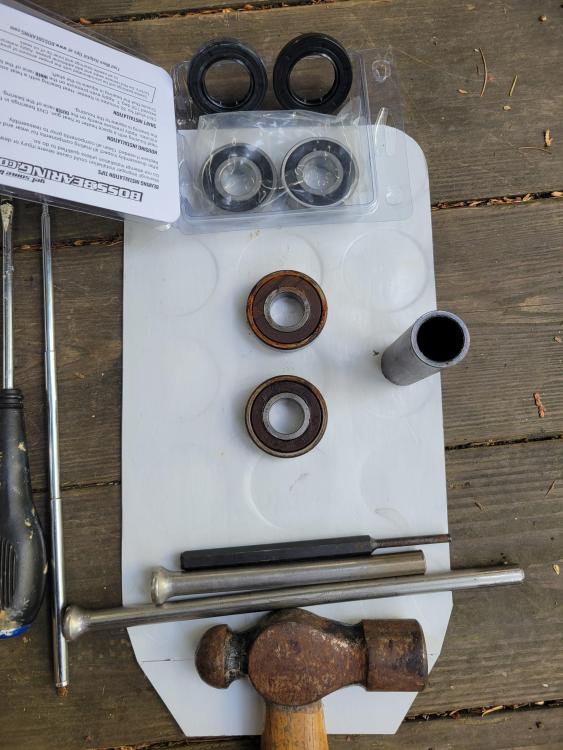

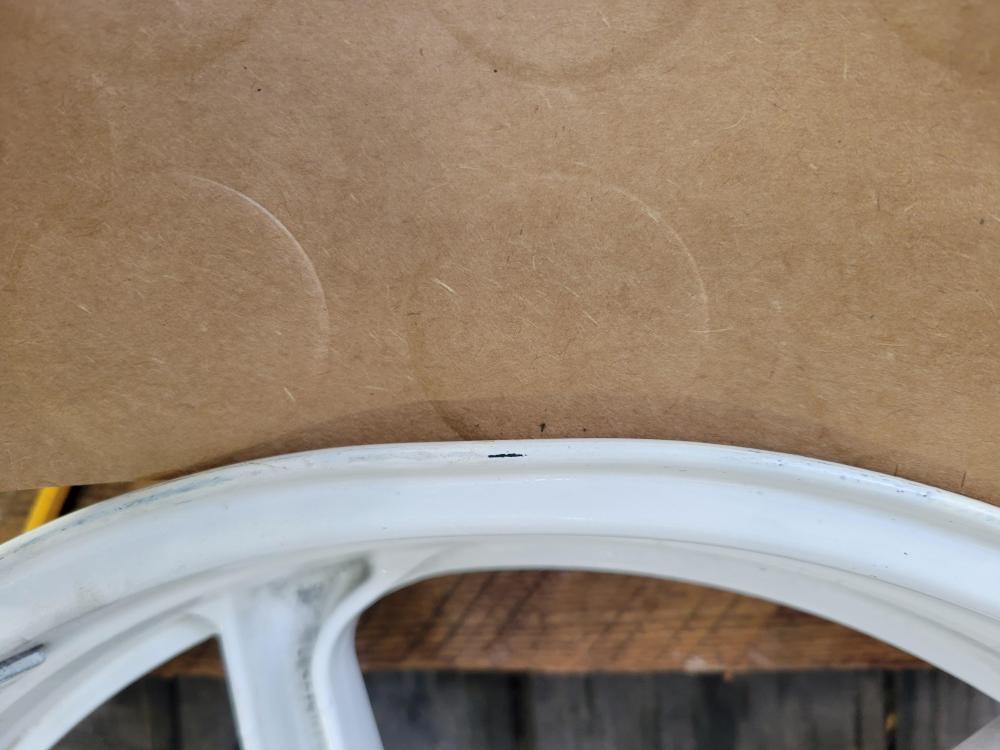

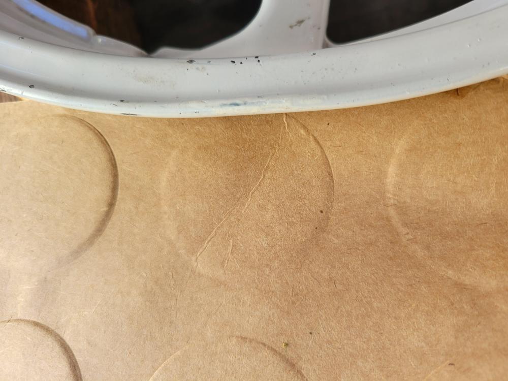

Member Contributer FromMaine Posted September 13, 2025 Member Contributer Posted September 13, 2025 Replaced my front wheel bearings. A trip in early May to the Cabot Trail in Nova Scotia took a toll on my front rim. When I replaced my tires last Sept. I inspected the rims and bearings carefully as the bike was new to me. With only 11.5K on the bike they were as they should be. I knew I put a dent on the front while I was in Nova Scotia. as I also blew my right fork seal. I put the bike away for June and July, had a lot going on. In August, tucked into the front end to find the front rim had not 1, nor 2 dents, but 3. The left fork seal was shot to boot. Having gone through this with my 4th Gen 10 years ago, I figured the bearings were toast. I had seals and bearings on hand, until I went to install the bearings, they were for my 3rd Gen..... .🙃, so had to order a set. Anyway, some pics, because if not, it never happened. The right bearing was chowdered. Edit: For the record, the last picture is from 10 years ago and what your front bearing on your 4th Gen looks like after it disintegrates at 65 mph on the highway. I keep a close eye on my bearings now.😁 1 Quote

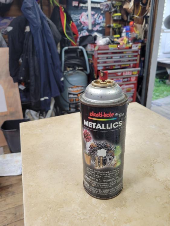

mello dude Posted September 13, 2025 Posted September 13, 2025 ^^^^What are those blingy rotor bolts Maine? I like... 😊 1 Quote
Member Contributer FromMaine Posted September 14, 2025 Member Contributer Posted September 14, 2025 Yeah, kinda "the Hood" choice of rotor palette presentation. But, I've had that paint sitting around for a while after buying it for a non motorcycle project. The paint I use on my rims takes about a week to cure, and well, idle hands and a desire to use the can before it's use by date.......... Honestly thought it would be a little less Mr. T after I installed them.😁 1 Quote

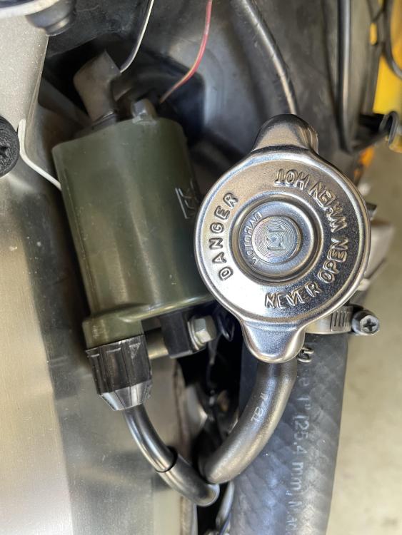

YosemiteVFR Posted September 14, 2025 Posted September 14, 2025 Installed new fuel drain hose, throttle body insulators & Napa Auto sourced radiator cap. I’m looking forward to road testing to verify cooling system performance. I’d been chasing down some elevated coolant temps and a situation where the radiator fan or air flow at speed wasn’t able to bring the coolant temp below the switch threshold to turn off the fan. After testing and verifying the properly functioning thermostat I’d installed a year ago (I was thinking it may not be opening all the way), I tested the OEM rad cap I’d installed, what I thought was a year or two ago, actually ended up being 4 years ago. I should have tested that first because I found the cap would slowly leak. Buttoned everything back up and logged heat cycle times to compare to an earlier test and it looks good. It was a good reminder to test/verify especially those things that were relatively recently replaced. 3 Quote
