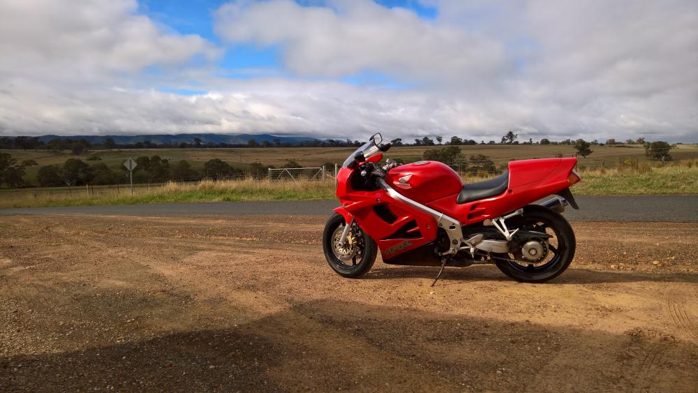

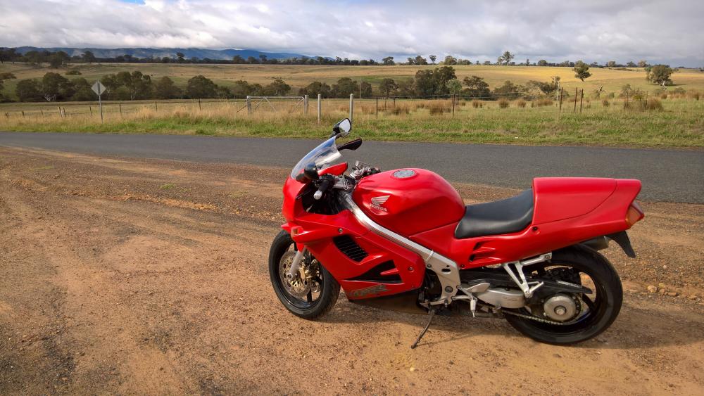

I wasn't sure where exactly to put this story, I had already completed an introduction post (Linky-poo) but I haven't been around or active much (soooo much lurking) as I have had my hands tied up with the below:

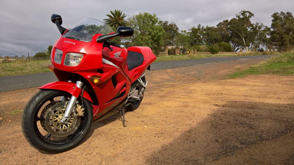

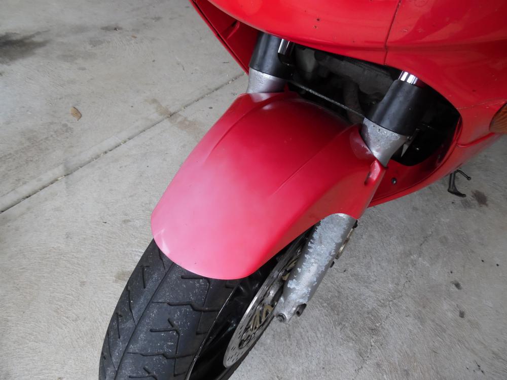

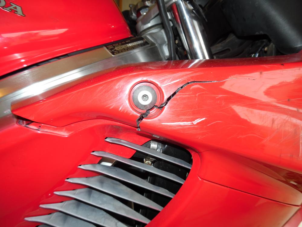

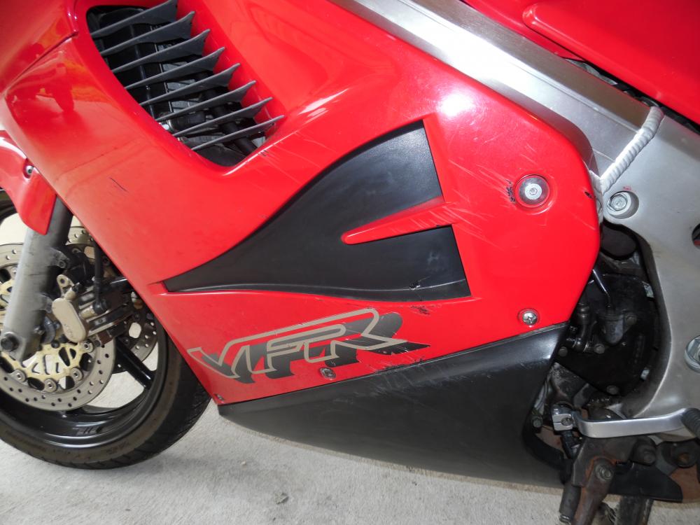

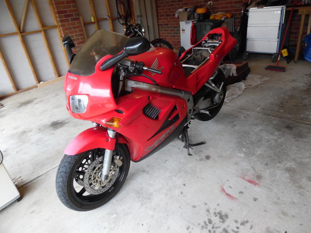

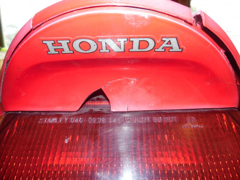

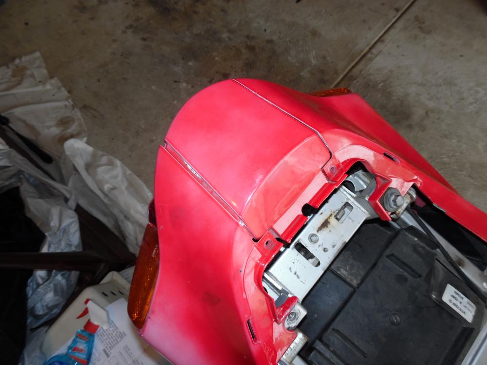

After doing some investigation and various bits and pieces I had everything I needed to be able to work on the bike. Mechanically very little was needed, in the end it was some various seals/gaskets, full fluid flushes, front brake, starter motor and carbie rebuilds, some fine tuning and a tiny bit of re-wiring. The painting held me back for a few months as I was waiting for the right weather - I even built myself a boot to do it in. Luckily, at the last moment I was able to secure a booth through a friend and used that, instead.
I have never really done a lot of panel repair before, and especially not to this level, and I had never really painted before. I've got no doubt in my mind that the experienced spray painters will be able to recognize my (many?) errors along the way, but for my first go I'm pretty happy with the result.
All up, the bike, parts, paint, tools, materials, registration, roadworthy and insurance have cost me A$3,500 - to put that into context, a reasonable condition second hand one in Aus (where you would still need to pay rego, roadworthy, etc) would cost around 4,000 - 5,000 - so I'm extremely please to have the old gilr up and running, now looking as good as she is mechanically. Plus, I got to rescue this amazing bike!

Thanks @VFR4Lee, all the repairs have already been done - I actually used a two part system which was both strong and easy to use (I forget the name, I'll check when I get home).

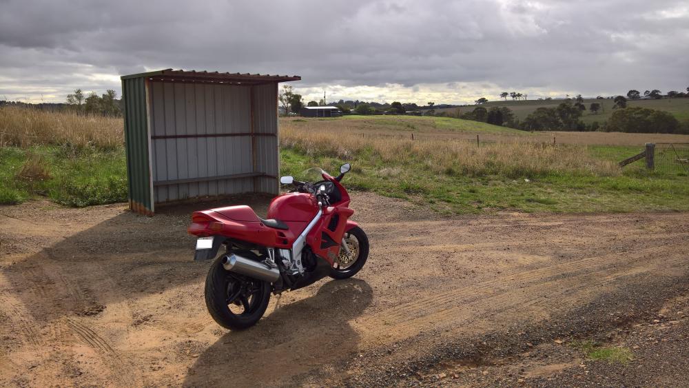

The last 4 pictures show it repaired and painted and on the prowl. I'll see if I can take some area comparison shots to highlight the before and after.
