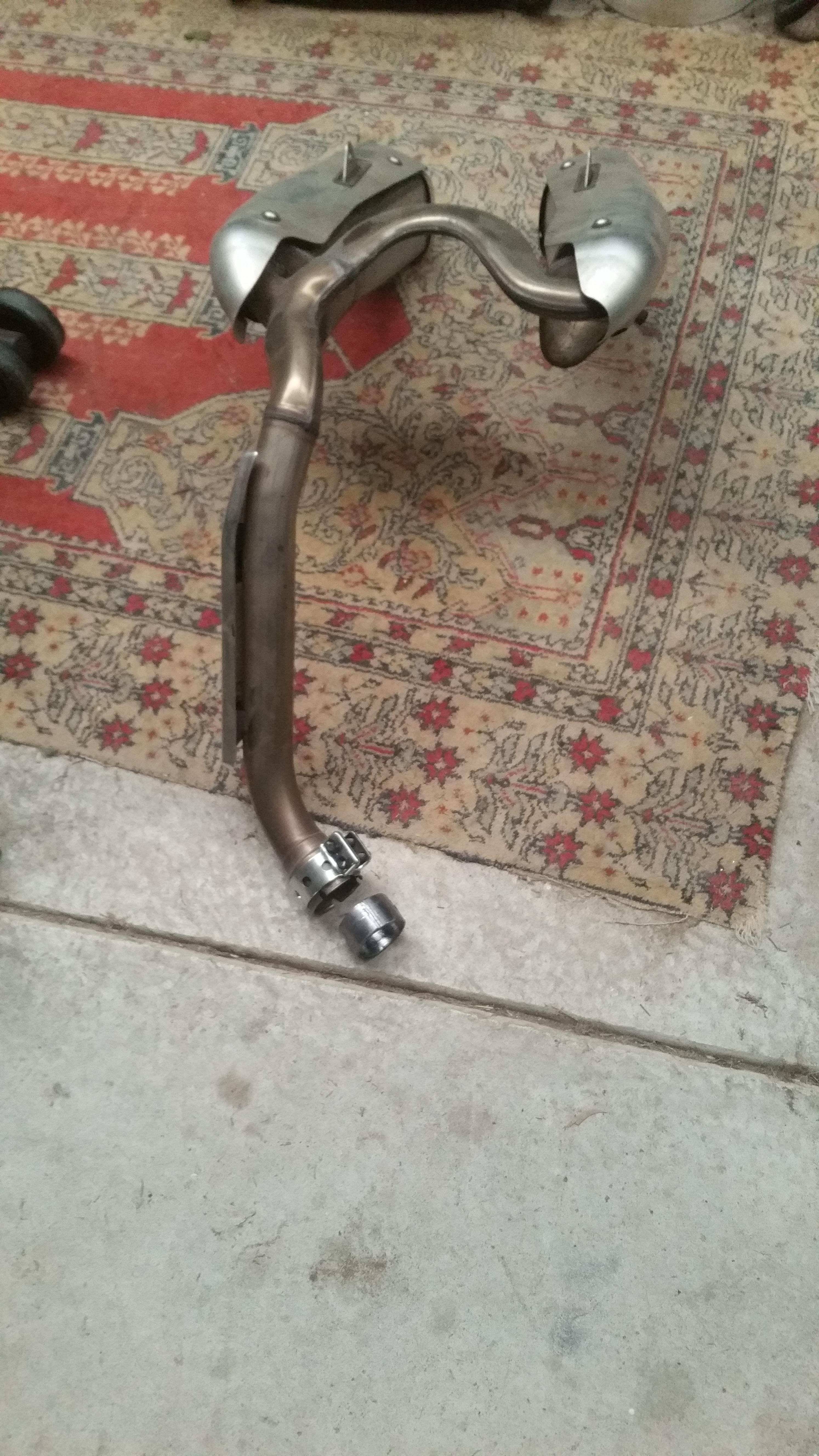

Member Contributer RC51Nick Posted March 24, 2017 Member Contributer Posted March 24, 2017 5 hours ago, RVFR said: 51Nick, do you have a photo of the Staintune there fitting up to what I believe would be the stock 6th gen mid pipe? Like you. My Staintune is staying put. I All ready know it wouldn't just slip on like it does now, so that's going to be fixed. Thing is, here with the 6th gen is where to make that part work so it fits correctly. Yes o2 bungs will be added on a as needed bases. as far as where, pretty much going by where they need to be with the stock location. RVFR - I'll try to get you a shot in the next day or so. My exhaust collector that the pipe connects to is under the bike so I'm not sure what mid pipe you're talking about. The Staintune has a mid pipe that goes up to the underseat mufflers. I'll get you shot of the connection of that pipe to the factory exhaust. Quote
Member Contributer Duc2V4 Posted March 24, 2017 Member Contributer Posted March 24, 2017 The gasket I believe that RS51Kick is referring to, would be on the exit pipe. You can just make it out on the 98-99 header on the bottom. Quote
Member Contributer boOZZIE Posted March 24, 2017 Member Contributer Posted March 24, 2017 Gasket. This 1? Quote
Member Contributer MadScientist Posted March 25, 2017 Member Contributer Posted March 25, 2017 Yep, that's the gasket in both of the above posts. My micron low and mig high both attach without the gasket (the inlet to the midpipe is smaller in diameter). This will be an issue for systems that use the gasket (stock and aftermarket) if you intend to have a larger diameter outlet from the performance system than the inside diameter of the gasket. Obviously now the gasket won't fit and the midpipe will need to be modified to fit whatever outlet comes from the performance headers. This can be avoided if the outlet diameter of the header is the same diameter as the outside of the gasket. Then you just run those systems gasketless. Quote
