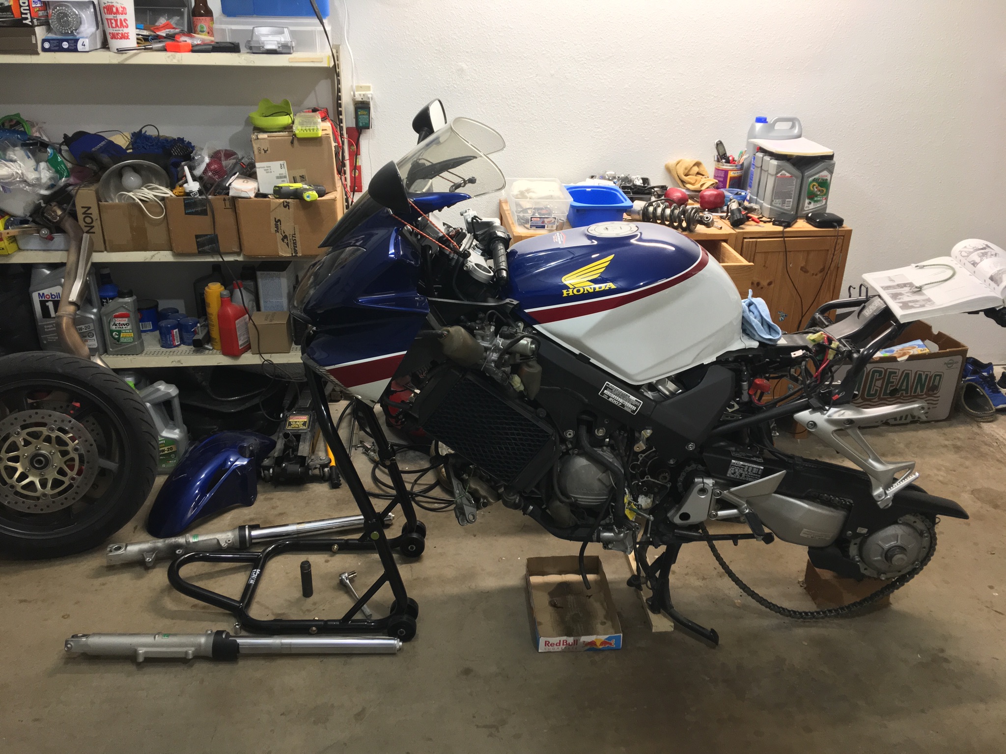

Member Contributer carlitos92 Posted December 12, 2016 Member Contributer Posted December 12, 2016 So, my 2007 ABS model is currently disassembled, awaiting DMr suspension rework, and a Factory Pro shift kit and Galfer lines under the Christmas tree. This little guy fell out as I was popping the bike off the center stand for a bit. At that time, I had just removed the rear fender, so I figure it was held by one of the bolts in the rear of the bike, nominally under the seat. I am guessing the round bar at one on end held electrical connectors but could be wrong. Anybody recognize this piece? Thanks in advance! Quote
Member Contributer Duc2V4 Posted December 12, 2016 Member Contributer Posted December 12, 2016 That goes on the battery side below the cover that wraps around the key hole for the seat latch. item #7 in this diagram... http://www.partzilla.com/parts/search/Honda/Motorcycle/2007/VFR800+AC/REAR+FENDER/parts.html Quote
Member Contributer carlitos92 Posted December 12, 2016 Author Member Contributer Posted December 12, 2016 1 minute ago, Duc2V4 said: That goes on the battery side below the cover that wraps around the key hole for the seat latch. item #7 in this diagram... http://www.partzilla.com/parts/search/Honda/Motorcycle/2007/VFR800+AC/REAR+FENDER/parts.html That was fast. I recognize it now. Thanks bud! Quote
