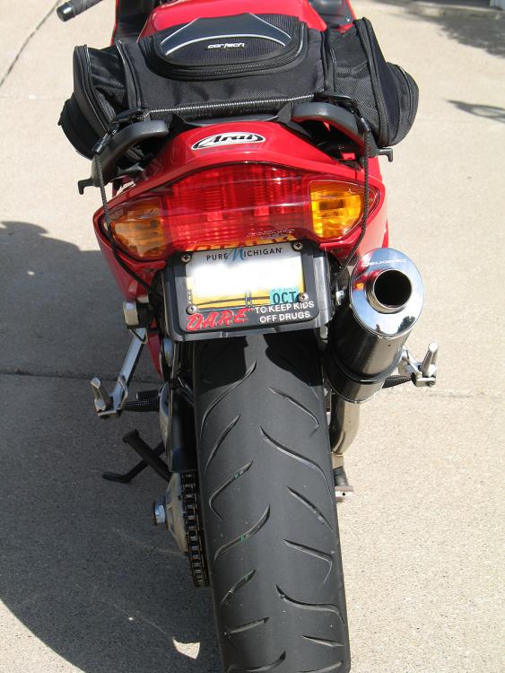

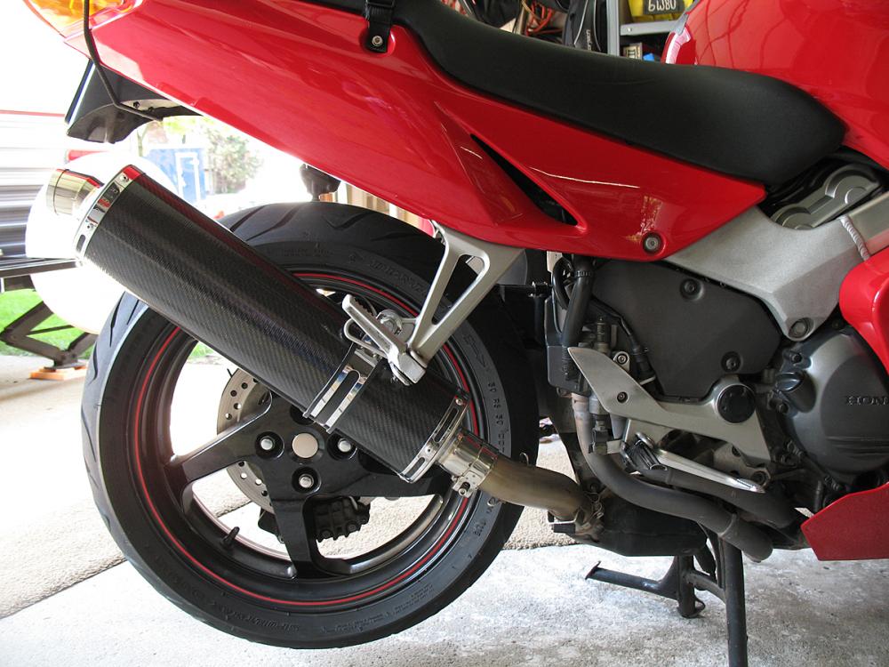

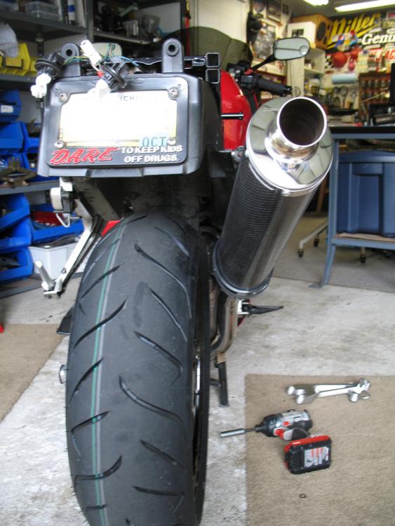

rc51jim Posted September 7, 2016 Posted September 7, 2016 Purchased a carbon Delkevic high mount 18" kit. I definitely don't like the fit. I currently have a 2 Bros. low mount slipon and it fits parallel to the bike and tight to it. This high mount is not parallel to the bottom of the fairing, and it juts out away from the bike at an angle. Contacted Delkevic and they say I have the right components, that I just need to tighten the brackets and clamps and it will pull it into the bike. Nope. Tried flipping the clamp around, pipe around (just in case), rotating the pipe this way and that, and it uses the Y bracket which can only go one way. Still nope. It's like the mid-pipe needs more bend to it to get the outlet into the right position. Currently trying to find a pipe bender to make me a better mid-pipe.
Member Contributer Madsen Posted September 8, 2016 Member Contributer Posted September 8, 2016 Picture please :)

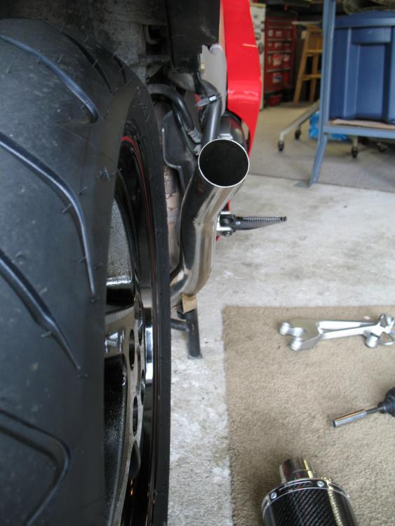

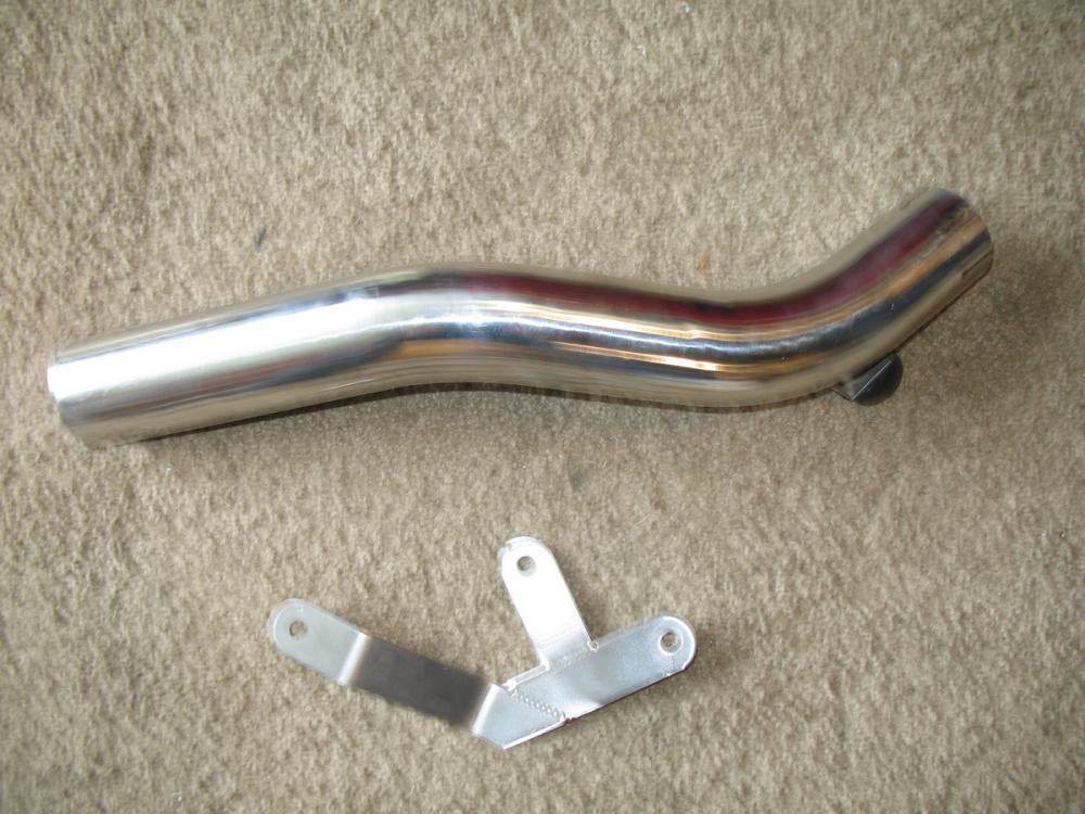

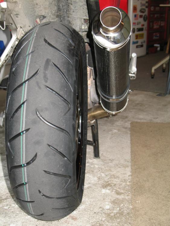

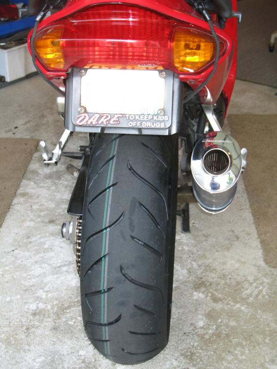

rc51jim Posted September 8, 2016 Author Posted September 8, 2016 I put it back on just for the photos Waiting for a reply from Delkevic. To me, the mid-pipe needs more of each bend. As you can see in the photos, the outlet of the mid-pipe comes out at an angle, so the muffler juts out at an angle also. No amount of clamping will bring it any closer. Tried the clamp inside the bracket, outside, clamp tab inside or outside, no luck. Rotated the mid-pipe up down and reversed, still sticks way out.
Member Contributer rhoderage Posted September 8, 2016 Member Contributer Posted September 8, 2016 Does it look like it sticks out that much when the tail fairing is back on?
Rogue_Biker Posted September 8, 2016 Posted September 8, 2016 I'm going to give to you straight out: It looks like shit when it's pointed outwards like that. It looks WAY better when the down pipe aims the muffler slightly inward. It makes the bike look more compact. You want the tip of the muffler to almost be pointing towards the rear fender. The issue is the downpipe section closest to the header collectors needs to be longer and sticking out. This helps the lower part of the muffle clear the rear tire and the rear cowl. The muffler itself needs to have a connector pipe that aims the muffler back in. Take a closer look at a Micron slip on for the VFR800 and you will see what I mean.

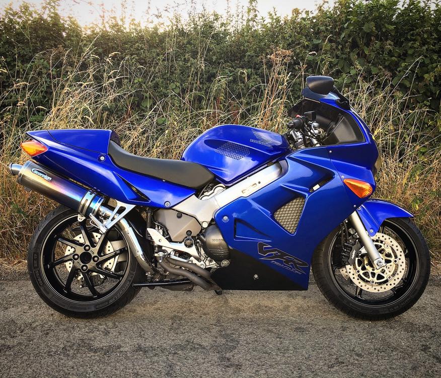

xpcgamer Posted September 8, 2016 Posted September 8, 2016 I looked at a lot of pictures (and videos) of pipes before I bought mine. What It came down to is that most of the lower price pipes sound very similar. This now came down to looks. I am afraid I did not go with the Delkevic because of how it splayed out of the fairing. I ended up getting the GPR Furon high mount and when I installed it lays in perfect alignment to the rear fairing and the side of the bike. I cannot show a pic of one yet as the bike is not in my garage at the moment but here is a Tri oval. And Delkevic. Bottom line I don't think your going to get it any closer.

rc51jim Posted September 8, 2016 Author Posted September 8, 2016 I totally agree it looks wrong, that's why I haven't used it. I put their can on a low mount pipe I had from a 2 Bros, which puts it tight and parallel. Still waiting to hear from Delkevic.

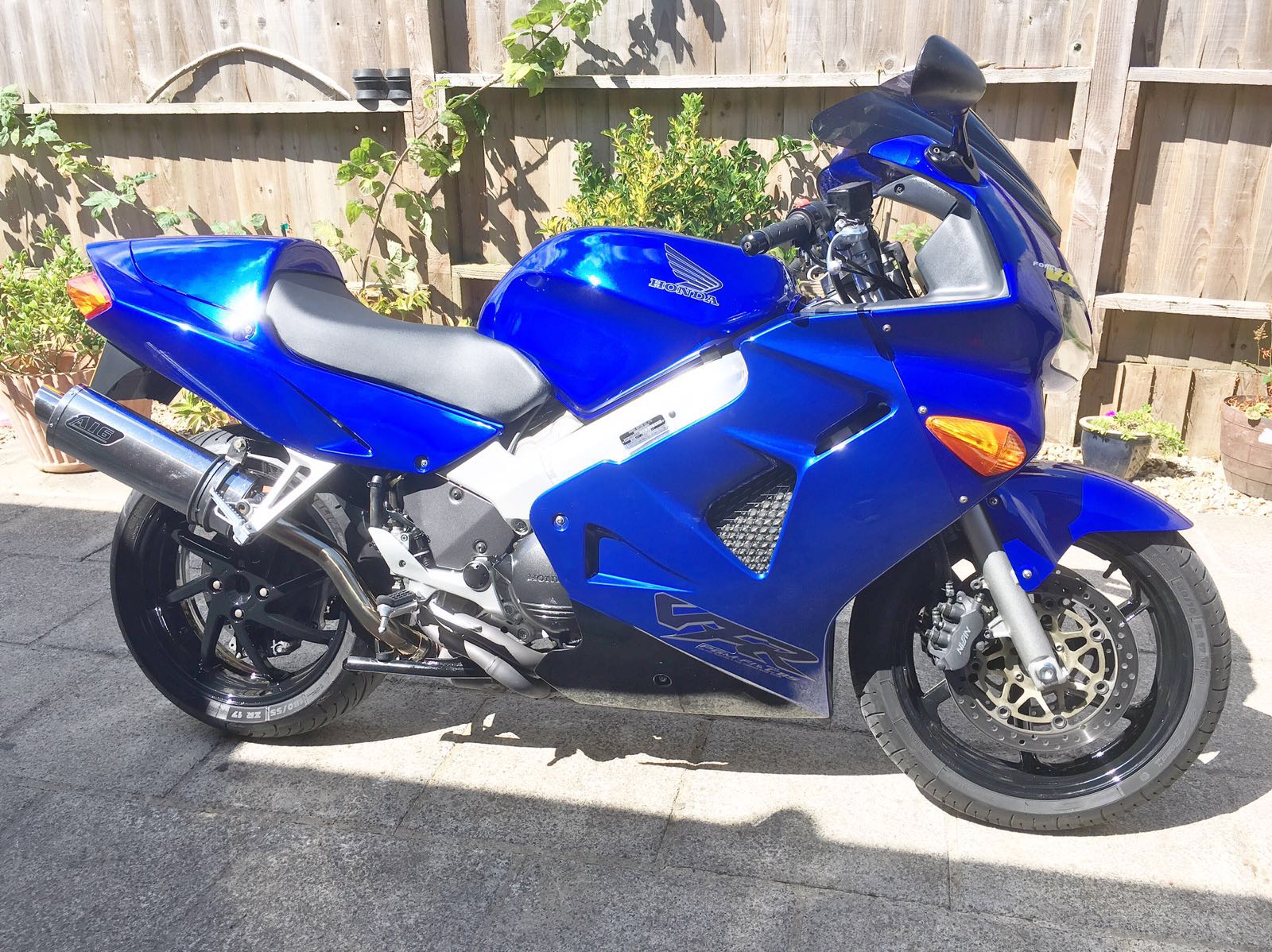

jackvfr Posted September 12, 2016 Posted September 12, 2016 I think that's how they come out the factory tbh, I had a similar link pipe from another company here in the UK. Stuck out & annoyed me every time I looked at the bike. The company who I got mine from probably just copied Delkevics, fortunately I got a scorpion high mount online auction.
CandyRedRC46 Posted September 13, 2016 Posted September 13, 2016 Man that is some real nice stuff right there!

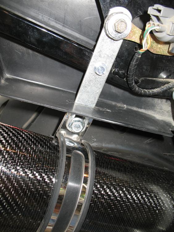

rc51jim Posted September 16, 2016 Author Posted September 16, 2016 Finally got a new midpipe from Delkevic which had a slightly different bend. After a lot of messing around, I eventually got it to work the way I wanted (no fault of theirs). I made my own bracket to put the barrel band more to the center. I also shortened the midpipe by 4" which put the can behind the footpeg. I then had to space the footpeg brackets out about 1/2" so as to not touch the can. It's now in about as tight as it can be without touching anything. I would have liked the can to be parallel with the fairing, but the shape of the pipe doesn't bring the front up high enough. On to the next project!
Member Contributer ggathagan Posted September 22, 2016 Member Contributer Posted September 22, 2016 I would still consider finding a a pipe-bender and get a cost of: Fabricating a new SS pipe from scratch The possibility of modifying either Delkevic pipe for a better fit. Yes, it'll cost more, but it might be reasonable enough to consider. I realize that this varies from person to person, but it would irritate me to see the poorly bent pipe every time I looked at the bike. What makes it more galling is the fact that it is a simple QA issue; they have the ability to bend the pipe properly, but choose not to.
