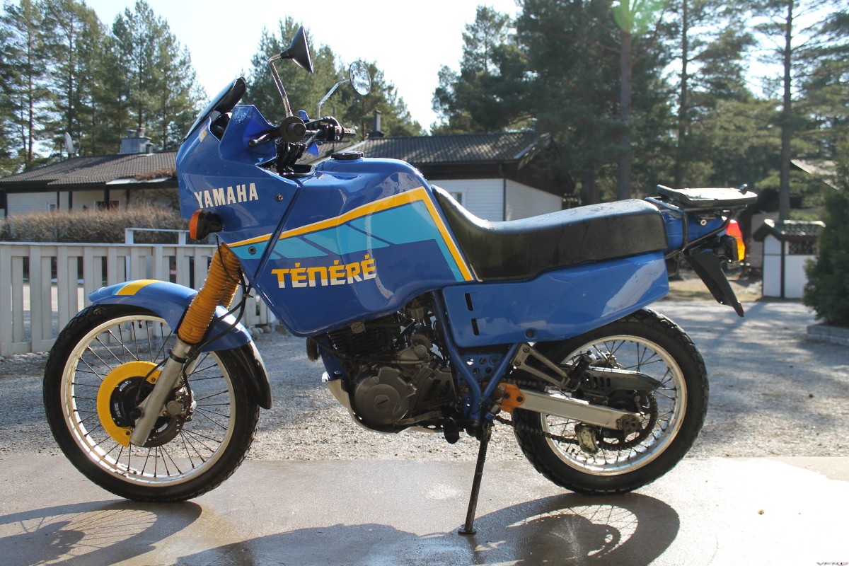

As some might recall I did buy a 1990 Yamaha XT600Z Tenere 2 years back, as I had my VFR800 up for sale.
But as I did not get the VFR sold that spring, and as the Tenere did smoke as cold i started to tear it apart, as it was taken out of road usage until the VFR was sold anyway.
Sadly just to notice the head was shoot, not just piston rings that is the normal wear thing...so it become a trophy in my garage...

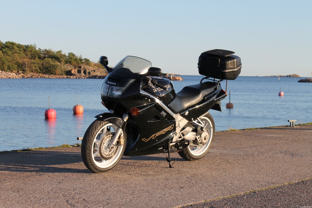

And even a nice bike it was not my bike..traded it for a 3rd gen
http://www.vfrdiscussion.com/forum/index.php/topic/82001-im-now-a-3rd-gen-owner/

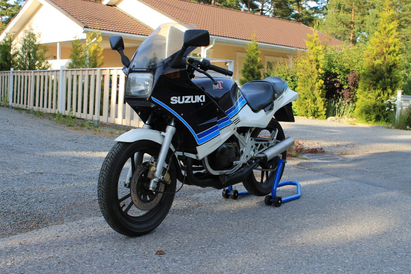

And so I still have a VFR, but the disire to ride some offroad also just got bigger, and as I had a Project, a VFR that is ridable but I want to do some cosmetic upgrade to and a 2 Stroker that I did not dear to ride after a deer hit in 2012, I desided to sell my 1984 RG250W Gamma to get funds for the Tenere Project.

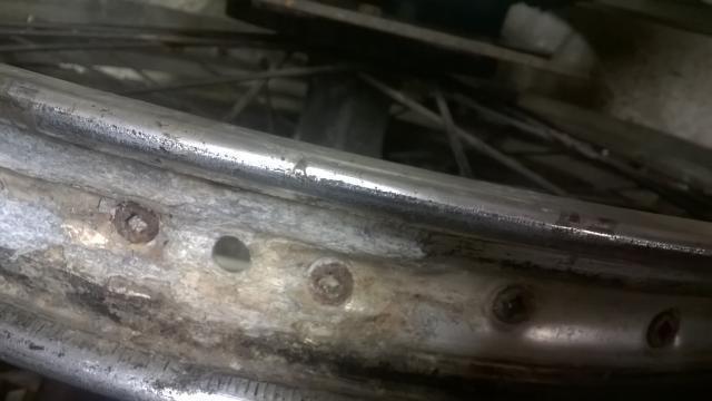

Well whit help of Dutchy (again, Thanks!) I did score a healty head for the Tenere. But as my drive got on I found out the wheels had cancer....
so as a desperate move I actuall did buy a second 600 Tenere, a cheap one actually whit deasent wheels at least!

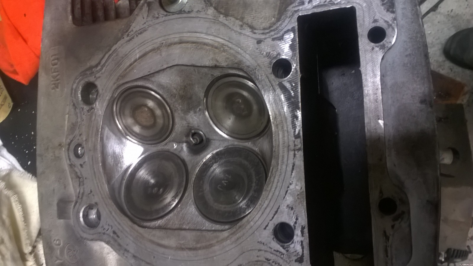

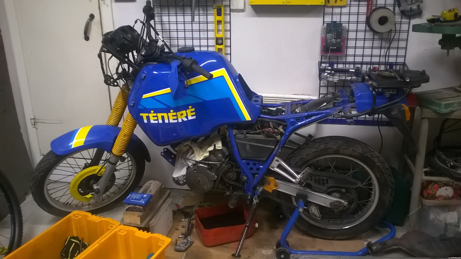

I did hope it would just have been to swamp the tank as panels from my older bike as it was a runner, but it did not run good enough even I had the carburattors cleaned, and it did wibrate a lot on higher rpm. The reason for the vibrations where a bent crank end on flywheel side, some one desperatly proberly have tried to hammer off the flywheel, that can sit quit tight on these. the reason for the bad running was the valves, bad sealing....so I tock back engine from the first one, and did put the best parts togheter. It had a good cylinder as piston7rings, cleaned the good head I got wwhit help from Dutchy, and now finally the engine is toghether
So now I really look forward to finish this Tenere off and get some milage on it on as off road! So far the second Tenere has been a good move, so many parts that are broken or corroded on the first one is good on the secondone!
