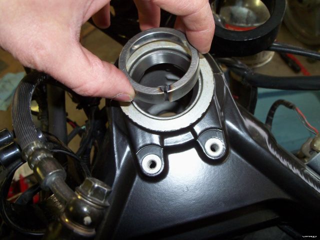

Veefer800Canuck Posted August 8, 2013 Posted August 8, 2013 For the bearing driver, you can use the old races. Cut a slot all the way through both the old races, so they're now 359 degree circles. Deburr the slot so it doesn't mar the I.D. of the steering head. Tap the new race in using the old race, flipped over as shown below. Cutting the slot ensures that the old race does not get trapped in the steering head, it allows it to be removed easily. As for the castle nut, you can make your own socket by grinding away the parts you don't want by trial and error. This is mine: Quote
