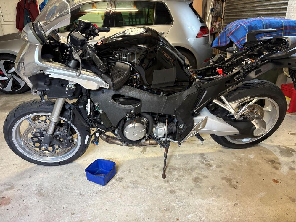

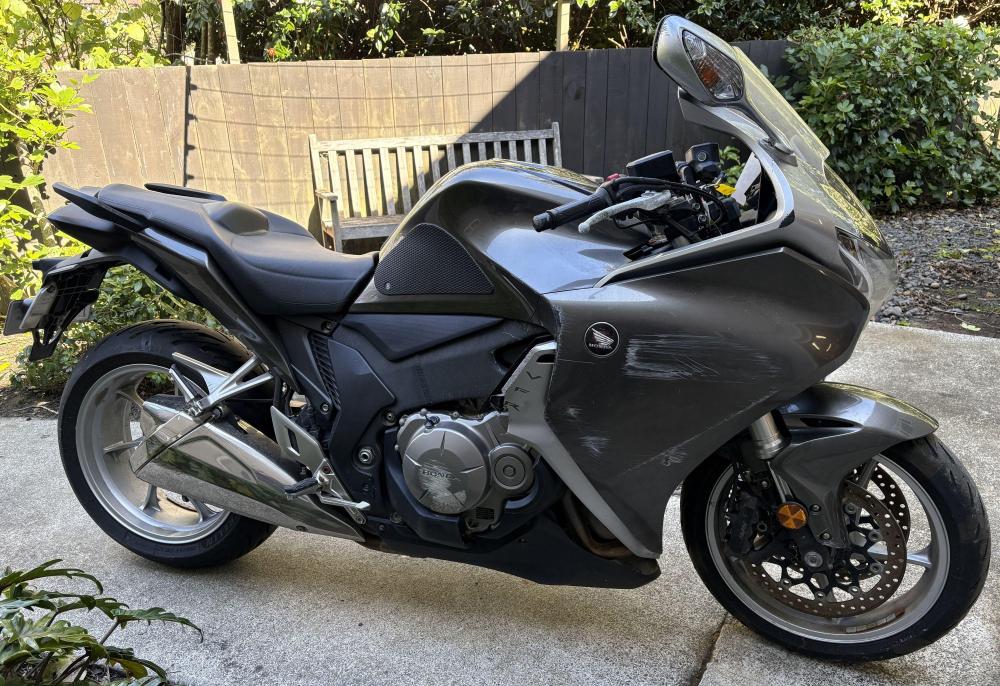

Member Contributer Terry Posted September 8 Member Contributer Posted September 8 I was looking for another project and this 2015 1200 hove into view; after one too many bourbons I hit the "buy-now" button and had it shipped to me. It has done 23000km and was an insurance write off; it was bought by the PO with the intention of powering a dune buggy but that never happened. It appears to have sat outside for a couple of years and has quite a bit of surface corrosion and the obvious crash damage. My guess is it was dropped on the right side at reasonably low speed in a collision avoidance, and then slid under the object that was being "avoided". Scuffs on the right side, left middle cowl completely missing and a severely bent radiator look to be the major offenders but the time parked outside has not been kind. Anyway the chassis and forks appear perfect, the brakes a bit draggy but not bent, and it starts and sounds mechanically great. I've owned many VFRs but never the 1200 so this is all new territory for me. Watch this space! Wish me luck! 6 Quote

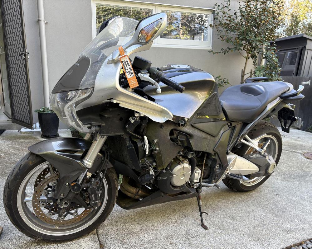

Member Contributer Terry Posted September 8 Author Member Contributer Posted September 8 Step 1 is the Voyage of Discovery where I get to learn just how many parts I need to buy. It is clearly going to need some panel and paint work, and given the price of new OEM bits I am looking for some lightly-used bits on the net. I also pushed the button on some Helibars as research shows the ride position of the 800 VTEC and 1200 are near enough the same, and I enjoy the higher bars on my 800. I will also splash out on a centrestand. I think I will keep it generally stock except for maybe a slip-on muffler to replace the "unique" stocker...call it a sympathetic refurb constrained by price. A lot of the bolts are showing surface corrosion; what would be the smart way to deal with those (other than just buying new)? as thinking to start with a soak in Evaporust but after that? The brake and clutch levers are super furry, what about those? 1 Quote

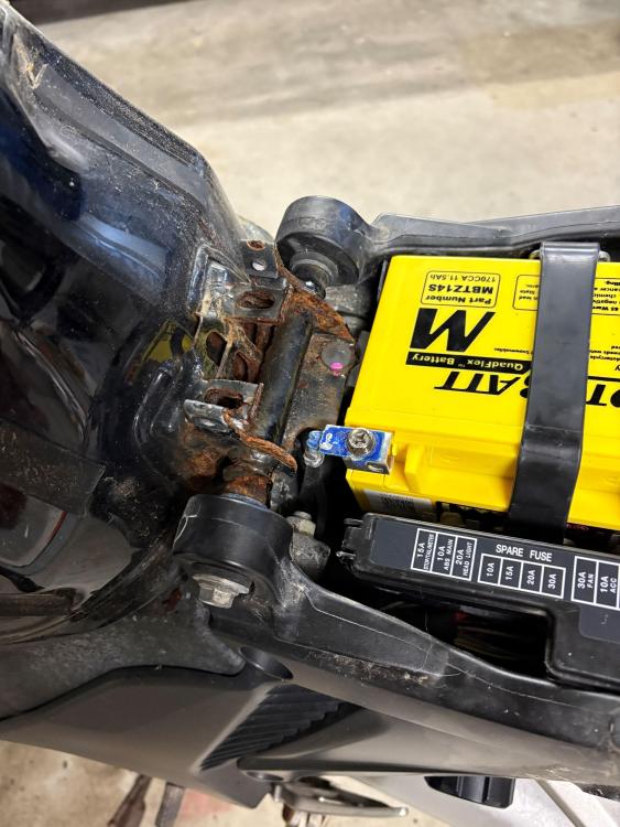

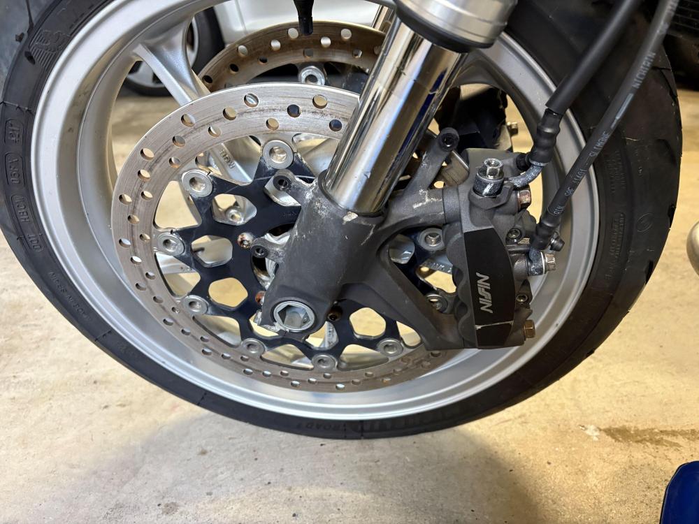

Member Contributer Terry Posted September 13 Author Member Contributer Posted September 13 Had a reasonably busy week making a bit of a start. First up was the front brakes which were were semi-seized making rolling around a challenge and which were predictably gunked up, one or two pistons had a small amount of pitting on their exposed ends but the seals were in good order, but what a pain to refit!. The master felt awful but was clean inside, still feels more draggy than I want so I will pull that one down again. One oddity that I haven't resolved is the brake light switch which works fine but the lever doesn't actually touch it. Wondering if I have an aftermarket lever here? The levers were horribly white and furry but a soak in alloy cleaner got rid of most of that followed with assertive wire brushing, and some penetrating oil and (im)patience got the span adjusters working. I will need to repaint the calliper bolts and maybe replace the pads pins as these also suffered corrosion. The discs cleaned up with some elbow grease and red scotchbrite pads but the disc bolts should get replaced to lose the rust. The rear brake will need similar attention but is not causing major drag. I ordered a full left middle fairing from a breaker in South Australia and that showed up today. I also found a radiator locally which arrived yesterday. I also found a clutch cover locally which will a little scarred is 100% better than what I have. I have the inner middle fairing coming from the US, and some radiator hoses from Florida. I bought a genuine HISS key from the local stealer and will get that coded and cut at some point. I have worked some graphite powder into the locks and they are feeling much better. I am wavering on buying a centrestand; I have a set of race stands but no way to use the rear one due to the SSSA and shaft drive. Have found a few unpleasant surprises with the hinge bracket on the tank rear really rusty; structurally OK but will need TLC to preserve what is left. The frame has some weird powdery white corrosion which is visual only but a bit ugly. Autosol seems to do a reasonable job without messing up the black finish. The reflector on the left lower fork leg took some impact and this has marred the lower casting and cracked the fender a little which will need some Plastifix or similar. One of the mirrors refuses to lock down when in the normal position, and I'm suspicious this might be an aftermarket part as well. Today has seen a major scrubbing session which has left me feeling drained, but at least the worst of the gunk is behind me and I can see what I have to work with. Electrically all seems fine, and the bike started right up with a new battery fitted. The next major project will be the forks which are a bit weepy as they are wont to do after a long idle period; there is some surface corrosion on the tubes but nothing too serious so I am hopeful a decent clean and polish will sort this out. 3 Quote
Member Contributer Lorne Posted September 13 Member Contributer Posted September 13 55 minutes ago, Terry said: found a few unpleasant surprises with the hinge bracket on the tank rear really rusty Are you able to spy the inside of the tank? This spring I finally worked up the nerve to check my '09 Vtec's, and was very relieved to find it looks pristine inside. Quote

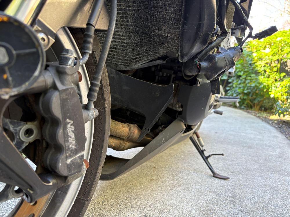

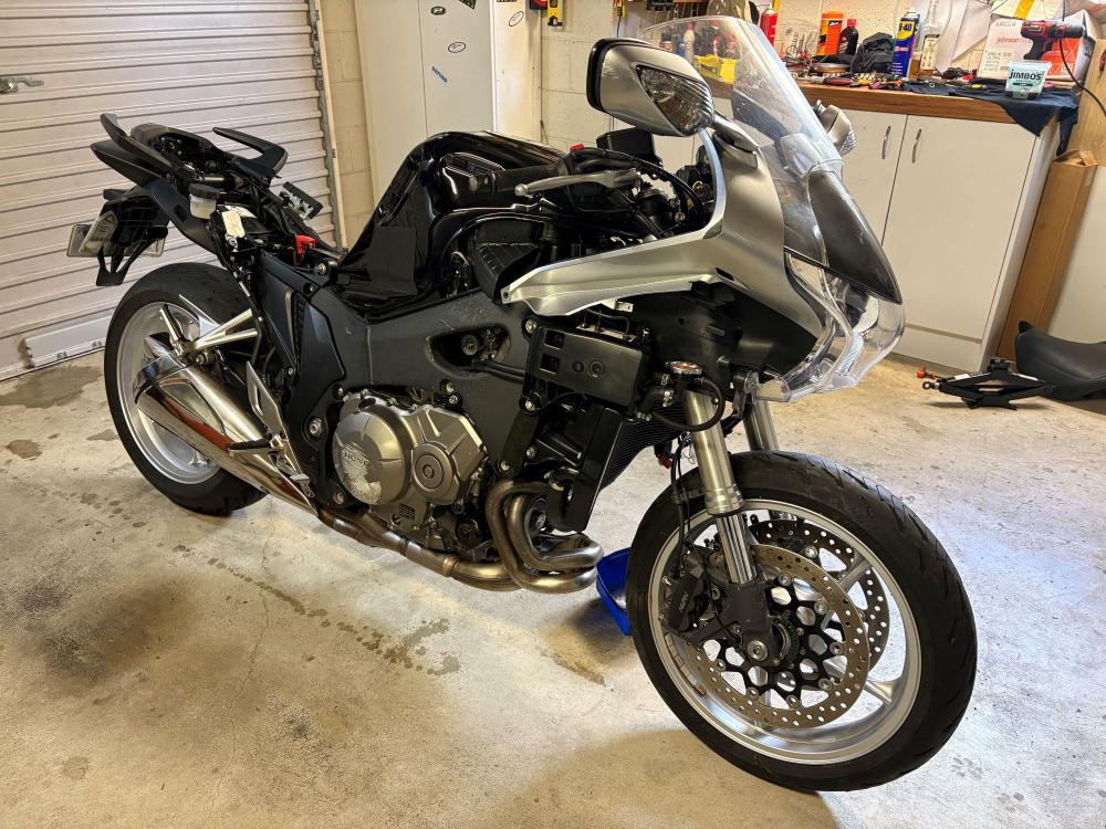

Member Contributer Terry Posted September 13 Author Member Contributer Posted September 13 Looks pretty nice in the tank, no sign of any corrosion inside. This bike sat outside for at least 2 years, looks like maybe salt spray got to it. The corrosion while not unexpected is more widespread than I had hoped. Still looks like a clean and straight chassis and the motor sounds great but without a cooling system I have limited my enthusiasm there. I just fitted the radiator so as soon as I get the missing hose and the forks I could take a sneaky ride.. Quote
Member Contributer Terry Posted September 18 Author Member Contributer Posted September 18 I received some second-hand radiator hoses on Tuesday and so was able to properly fill the cooling system for the first time, which also allowed me to run the engine up to fan cycling point. It sounded great and there were no leaks! Unfortunately I now have a check engine light which is telling me I have a wiring fault in an O2 sensor. Closer inspection shows nicks in both sensor wires where the bent radiator crushed them, so I ordered some more second hand parts for those (sigh) from Boontsra in Netherlands... I'll be pulling the forks apart this weekend and seeing what joys reside within. I am hoping to just clean the seals without replacing them but that will depend on what I find. I also placed a reasonable order with Webike Japan for some OEM fasteners and a mirror, plus second hand levers and muffler shield; a bit spendy but the best I could find. 3 Quote
