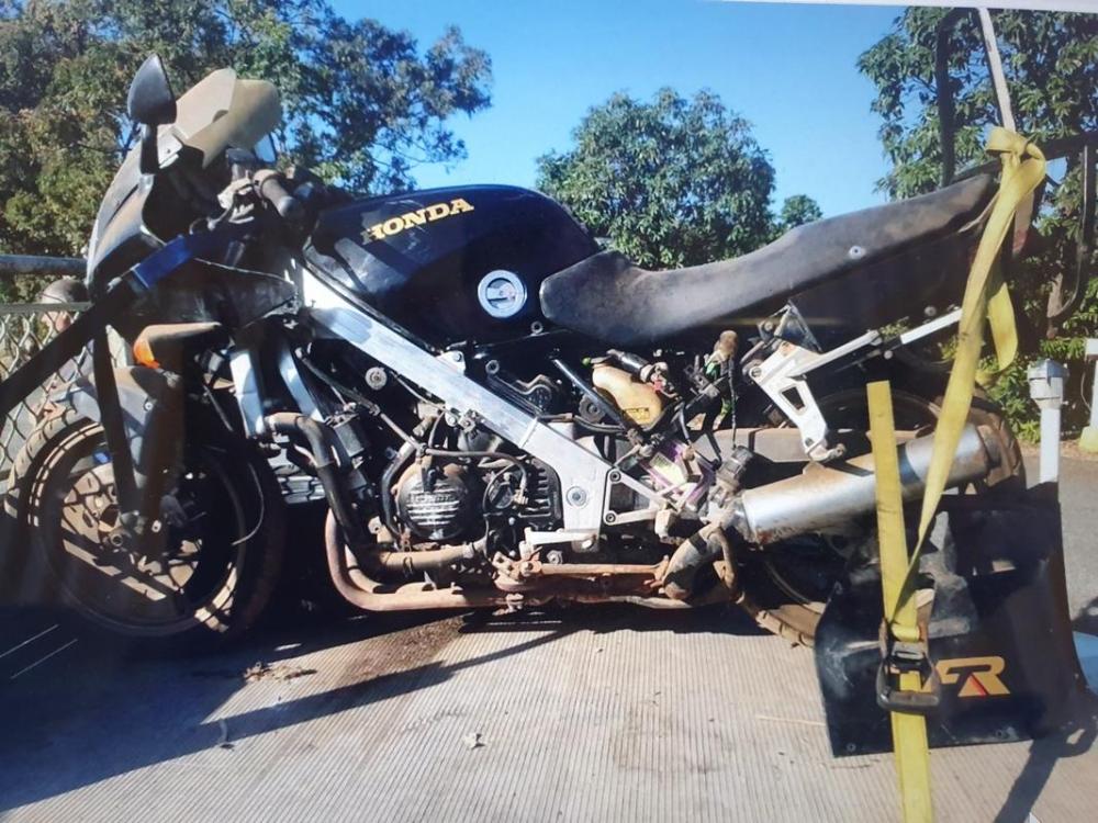

Member Contributer Skipper Posted August 18, 2025 Author Member Contributer Posted August 18, 2025 Thanks for the kind words' a "before" photo, as she arrived at my place, for those who might think I was exaggerating. Holes and cracks in the fairings, missing mounting lugs that had to be re-created, and the belly pan was badly distorted by heat Apart from insulation inside now, I cut holes on the front and added SS metal mesh behind them, hopefully no more issues The decals are custom made on the finished bike due to the different shape of the fairings And since it is a genuine AU build, I did not want the Interceptor name as people might think it to be an import from US There are a few small items yet to be done - I can't read that "orange on grey" facia so will need to fix that (I'm color deficient my optician tells me) Already painted white dots on the cover over the speedo to tell me what speed I am travelling at, as a temporary job. Quote

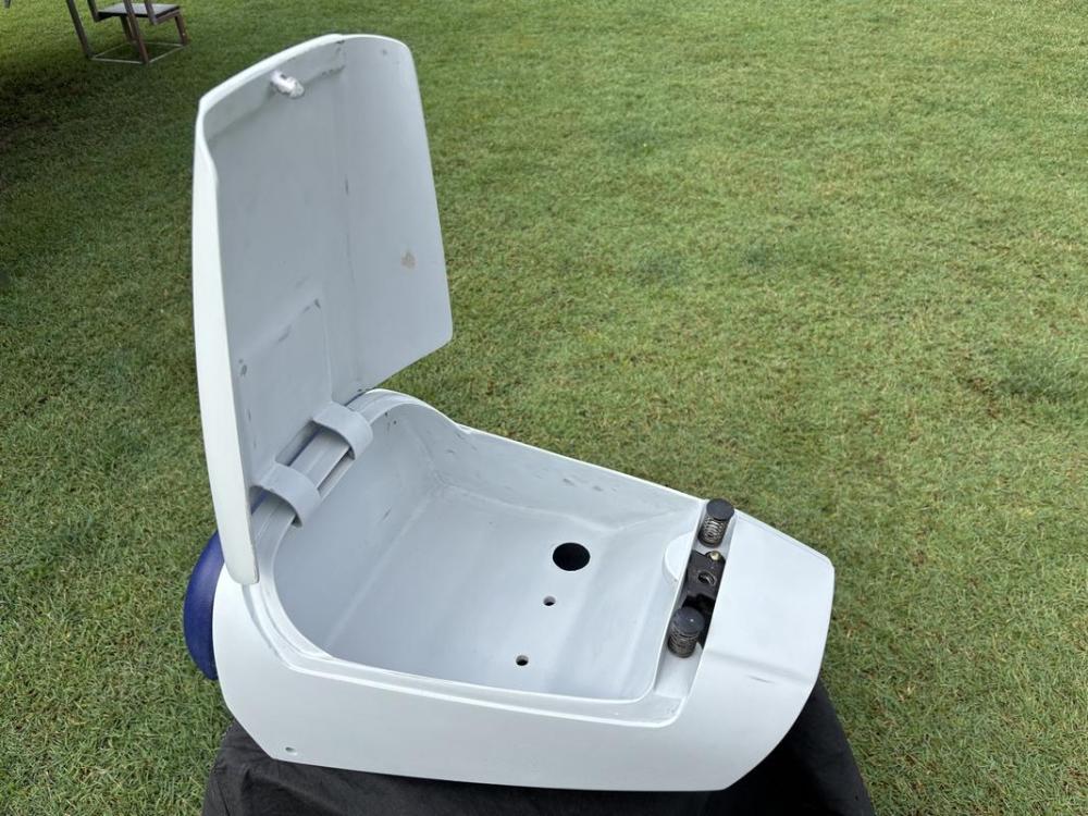

Member Contributer Skipper Posted August 19, 2025 Author Member Contributer Posted August 19, 2025 What do people think of my tail box, the single item I am perhaps most proud of? It follows the lines of the bike as originally designed, not the boxy cowl the factory "hung" over the seat. With the pillion seat entirely removed, the internal capacity is somewhat increased, so I not only carry tools, but my wet weather gear as well. In fine weather I can carry small shopping purchases, snacks or whatever. The lid is front hinged, and the rear has a concealed cable operated latch, using the original lockable latch from the seat and a new extended cable. The whole box is mounted solid down on the bike frame with minimum 10 thou clearance all round from that very fragile tail Moulding. The whole thing is made in fiberglass, is completely weatherproof and no - I do not want to make another, there were too many hours spent building that one! Photo below shows it during the painting process and has the rider's seatback attached using the same screws that hold the lid hinge, fixed from inside the box A rubber seal (not shown) fits across the front, under the lid, diverting any possible water down to the sides where it can drain freely out along the side channels 7 Quote

Member Contributer Skipper Posted August 19, 2025 Author Member Contributer Posted August 19, 2025 I'd love to, but you could not afford my time At 78 y/o, I am slow, and I could die before it was completed. 🙂 Besides, I did not keep the plug as I never wanted to do another! My moto "I'm slow but I'm rough" allows me to keep my distance when others want me to do something on their bikes Feel free to copy the concept, I would help you with the details! 3 Quote
