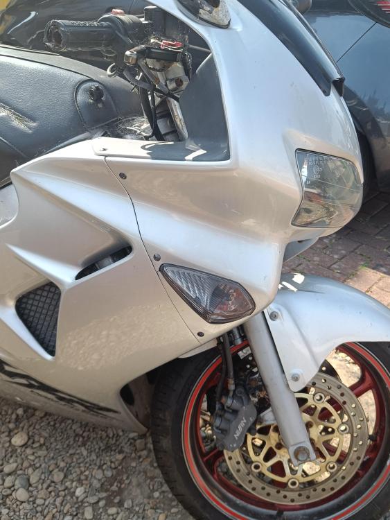

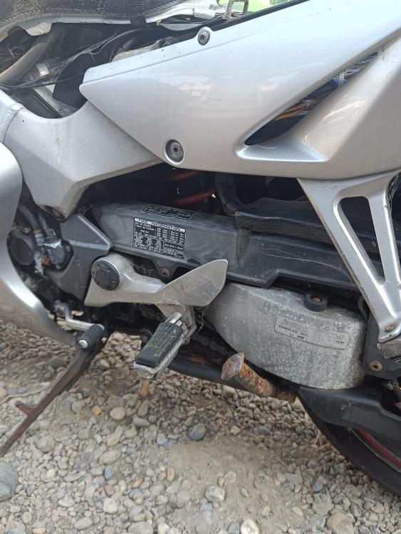

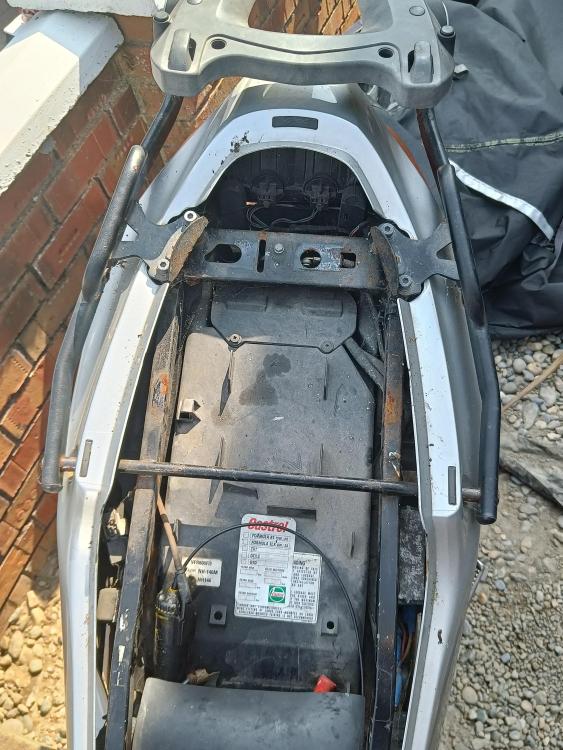

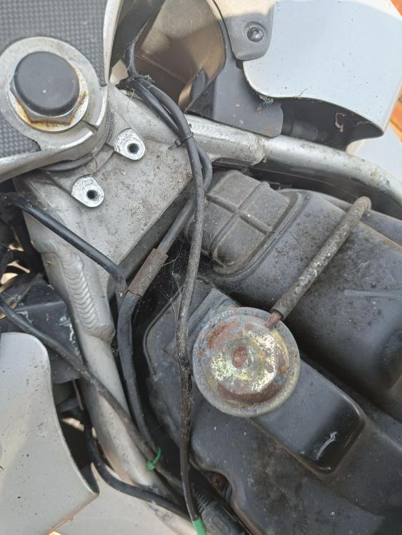

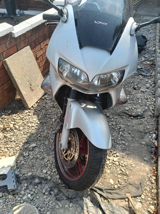

A few pictures of the starting point.
It's filthy, covered in cobwebs so needs a wash and a lot of degrease from chain oil fling, but that can wait for the moment.
My first job is it is currently idling at 3k revs when warm. I'm guessing the piston on the wax unit might be stuck from sitting up so I lifted the tank to get at it.. The airbox screws look nasty so it might take some time to get those out!
The current short list of jobs:
front left caliper partially seized
Needs a new tyre valve for the front wheel.
Fork seals are blown
Sort the fast idle.
After that I can take it for a short spin to see how it runs and there will be a much longer list at that point! It was apparently not running well when parked so that's why I want to take it for a spin to see if it is acting up under load.

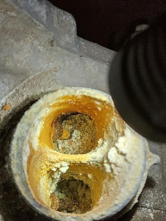

It would settle to a very high idle (4-5k) while it was warming up, so I figured I better look at the wax idle unit. I drained the coolant and popped off the hose which revealed some nasty white powdery gunk so I'm guessing someone has just had water in there which has oxidised. I'd say flow was at least partially blocked to the wax idle unit. while I was in there, I also realised the starter valves are fairly rusty looking and just aren't moving freely at all so I've ordered a good second hand throttle body which should take care of all of that. Now that I think about it I should probably test the thermostat while I'm in that far.

Success! I got the throttle body off and this thing just gets worse the deeper I delve.
