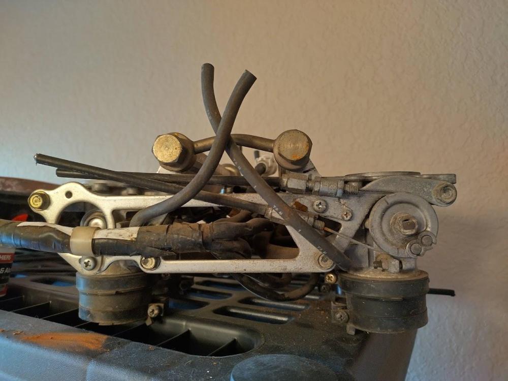

Throttle bodys with the 3.5mm silicone vac hoses... .. Tried the 8mm but decided to skip, the tight bends just werent gonna work.
Ok  on this one, need your tips, suggestions, I am struggling to get the TBs to fully seat down.
Front right is fully down, front left is about 75%, rears are about 50%.
Been using a wood block on top of the TBs and a larger rubber mallet to try to set things home...
Stubborn bastards... waht do you suggest? Huge thanks in advance...

make sure the couplers are fully seated on the engine. when i was putting the throttles back on mine i had to make sure they were all 100% down--i did what you did and used a block and a mallet--but after that the throttles pretty much popped into place. silicone spray would also help.
also i see your PCV valve is capped. unlike PAIR, that actually serves a pretty important purpose by keeping crankcase pressure down. i'd hook it back up or at least stick a cone filter over it.
The PCV cap thing is just temporary to keep junk out while I work on the bike.
I have rubbed oil on the insulators... mine are being stubborn... As mentioned RF is fully down, I did feel it "pop" into place...
3 more to go..
I used silicone grease on the insulator boots on mine after I did the thermostat, and they dropped into place with just "firm downwards pressure" i.e. me leaning on them. Maybe some heat from a hair dryer to soften yours up a bit more? I did a Dumb Thing ( my specialty) and managed to trap a hose in the front right throttle mechanism so they couldn't freely close, so I had to pop them off again to sort that, and then I had some weird idle/vacuum issues for a bit, difficult to synchronise and the idle rose, so I don't think I initally had a great boot seal but a decent ride fixed that (no tools required aside from me).
Those blue vacuum hoses have got to be worth another 5 bhp, easy.

Do yourself a favor, and ditch the rubber mallet/wood block for a dead blow hammer. You can thank me later.
To clarify, I have a Pittsburg 3 pound dead blow hammer guy, I think I'm going to go grab a 5 pounder...
I only have about an hour of patience at a time with this thing... this fit it stuff drives me nutz...
Plenty of other work to do in progress....
Get the Icon. It's softer, yet more robust. I had a Pittsburg, and it disintegrated.
