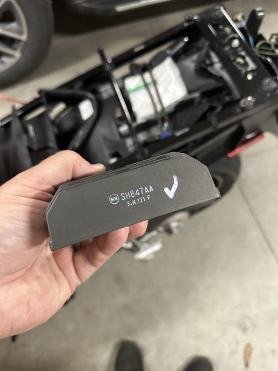

trmoyer Posted May 27 Author Posted May 27 RR in hand, next be the stator. Finding a place to rewind it in a reasonable amount of time is a challenge so I’m gambling on a Rick’s but will still send the original out for rewinding and keep it as a spare. Quote

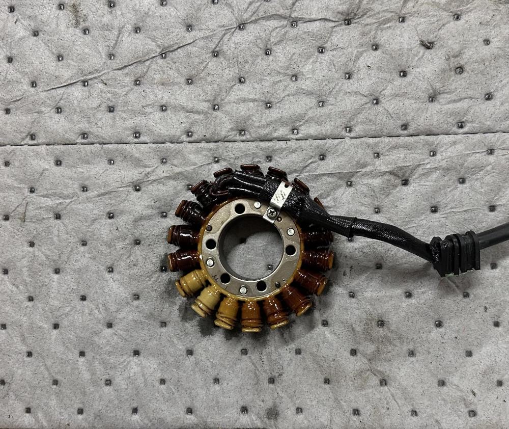

trmoyer Posted June 1 Author Posted June 1 Update. Pulled out the old stator and it has been set aside until I have time & place to have it rewound. Made a mounting plate for the RR and tested things. AC and DC voltage looks good. Now the weather has to get its act together and do some riding. 2 2 Quote
Member Contributer Ughandi Posted June 1 Member Contributer Posted June 1 That stater looks ~KRISPY~ 4 Quote

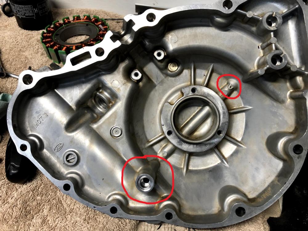

Member Contributer Terry Posted June 11 Member Contributer Posted June 11 My FSC600 scooter had a small oil jet aimed at the stator which I assume was there for cooling purposes (but it still burnt out the stator). The photo below shows the gallery where the oil crosses into the alternator cover and then the little jet (at 12 o'clock when installed) where it aimed at the stator. 2 Quote
