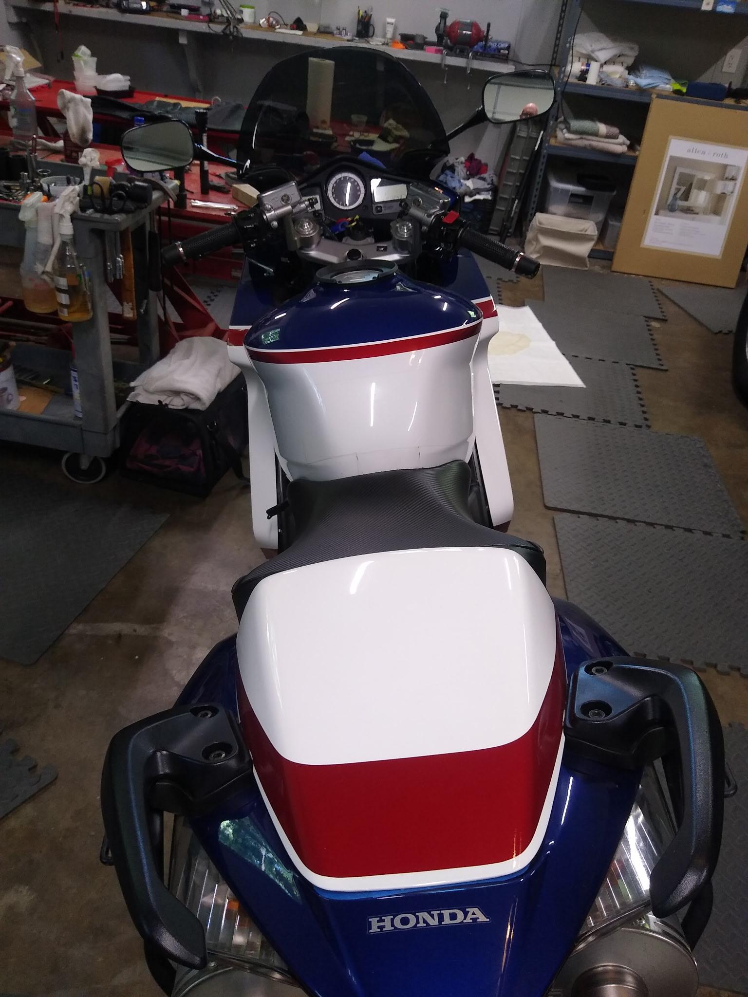

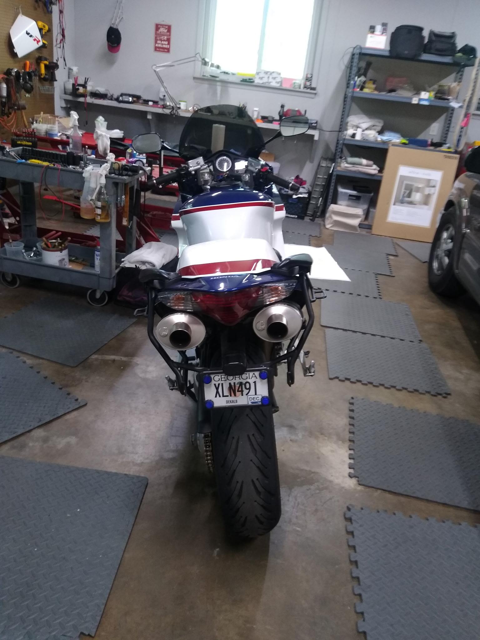

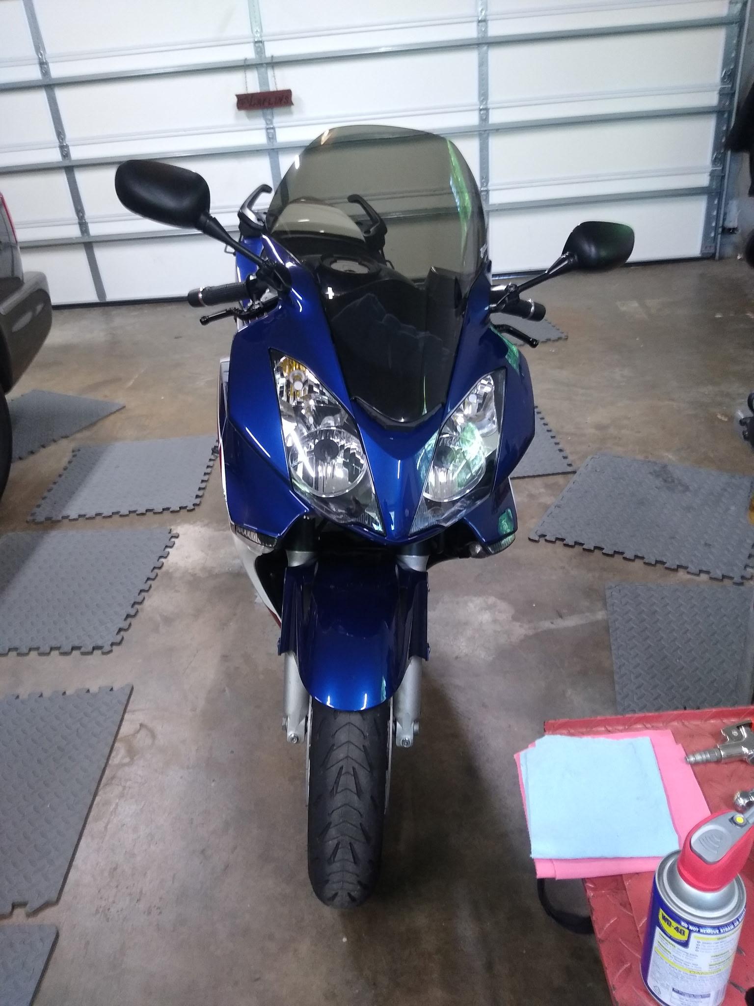

It looks like it has an aftermarket windscreen.

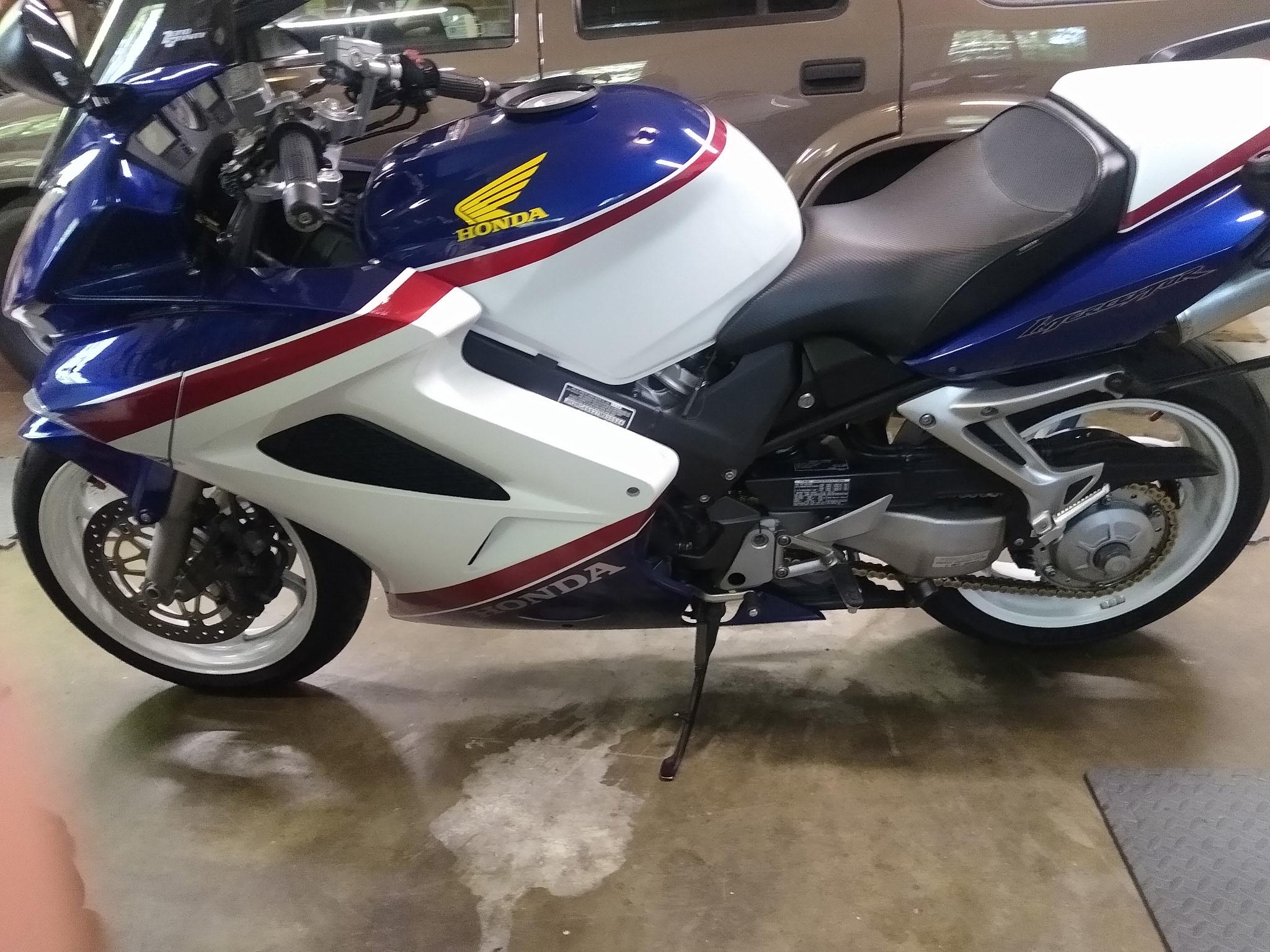

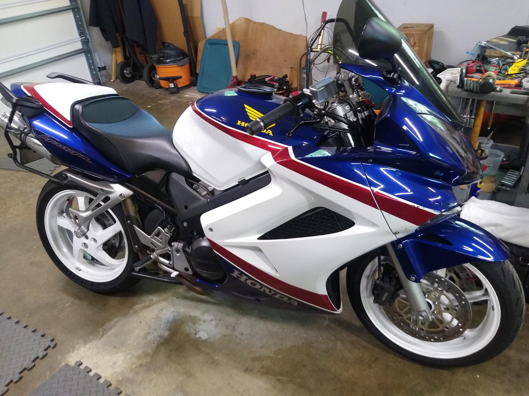

This is the ad:
heli bar risers
Sargent seat
SBK exhaust
new chain and sprockets
LED lights
cruise control
new pilot roads front and rear
New brakes
power commander 5 that was dyno tuned
Jesus Christ.  That windshield could even keep this helmet out of the wind...
  • Haha 3

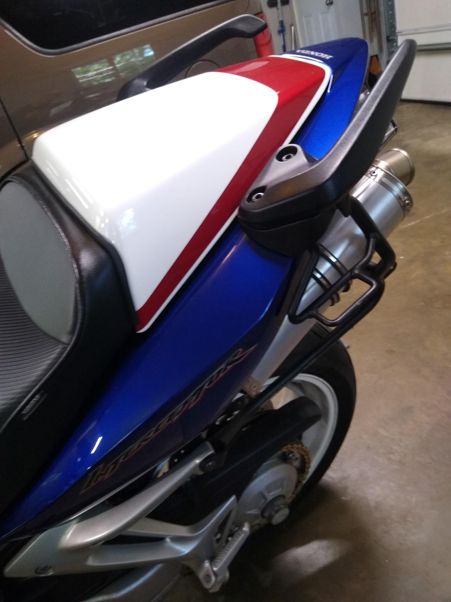

And seat cowl.... nice. Tank ring means a quick release bag at some time. Aftermarket levers too.
Replacement screens are about $30 on Aliexpress and good quality too.
The bike looks good and those are some very nice (and usually desirable) modifications.  I agree with @afinepoint on the maintenance items.  If the seller has records, great, but if not -- and maybe even if they do -- replace the fluids anyway.
The ad says cruise control, but I think they meant throttle lock.
I don't think anyone has said it yet, but on 6th gens, ABS bikes had gold brake calipers, and standard brake bikes had dark grey/black calipers.  Of course, ABS bikes would also have a front wheel sensor, too.  So this bike has the standard brakes.  Don't let that be a deal-killer.  I'd wanted ABS when I was shopping for a VFR, but got a bike without it.  Thankfully, I never needed it to save me.  🙂

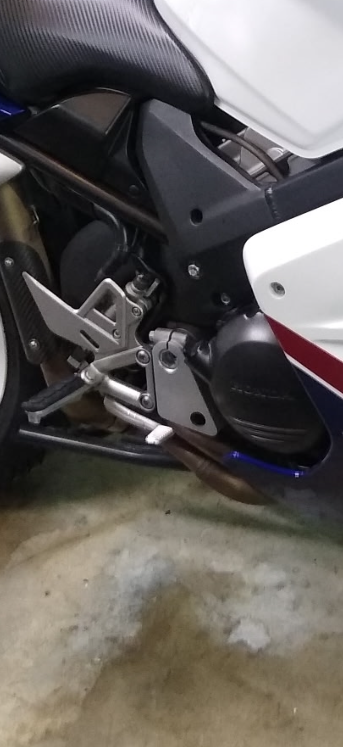

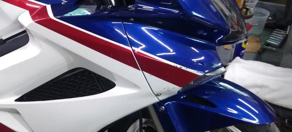

Looks like it may have seen some gravel at some point, and the right cowl got replaced, but not the upper.  Stripes seem a bit off too.

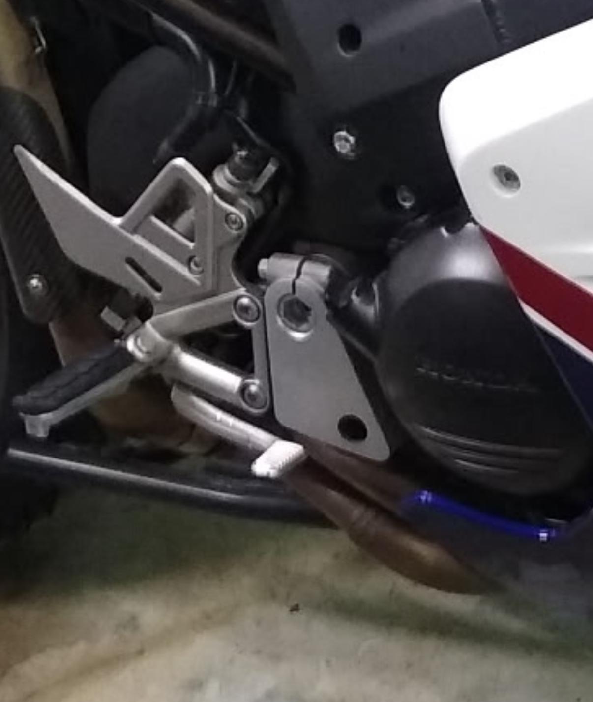

Crankcase cover *may* show some damage too.  Wonder what the end of the brake pedal looks like.
Good eye Capt.  Was going to say look at that side saddlebag but if the side case is scratched, most likely the bad wasn't on it at the time of the drop.
Take a looksee at the brake pedal, bar end and even the passenger peg area for marks.
If was ME, I'd see if the seller would allow to remove the small backside cover and check the condition if the posts on that part of the upper where the mirror mounts.
Just sayin'
1 hour ago, VeeEffArah said:
Was going to say look at that side saddlebag but if the side case is scratched, most likely the bag wasn't on it at the time of the drop.
Could just be reflections on the top of the ridges on the crankcase cover, hard to tell from that pic.  Even if I download the pic to zoom in, it's not hi-res enough.
Fitment of the upper cowl to right cowl around the damage, especially near the leading edge and hardware, looks "off".
Good callouts and I also noticed that. The seller said that those might be scratches but will definitely investigate.
here is a close up of the brake lever and cover. Looks ok to me.

What a weird comment from a seller.  Either they are or not.
Is he brokering a deal or is it actually his?

Apologies. He said they are scratches. I should have re-read my post. He is not brokering a deal, it's his bike (title is in his name) that he is selling due to not being able to use it anymore.

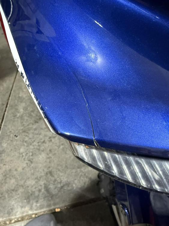

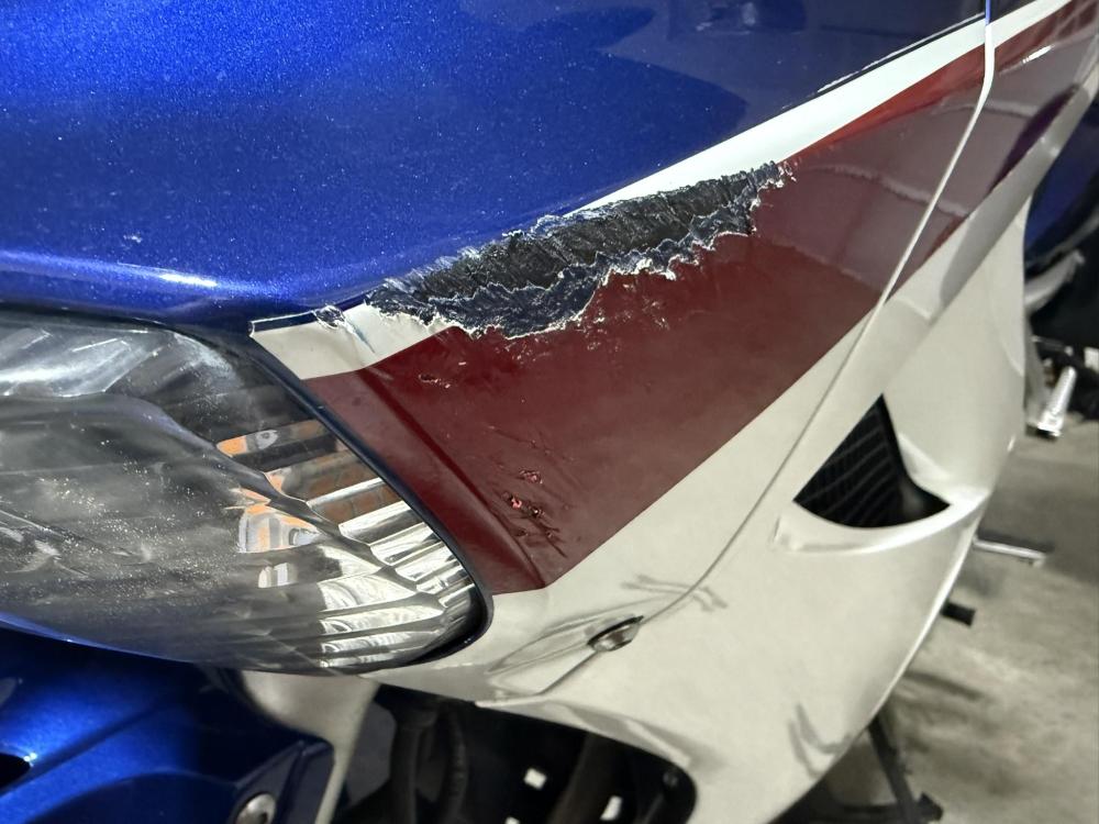

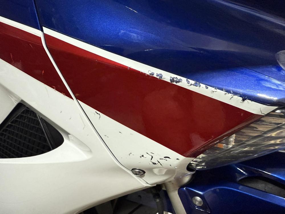

It looks like the front cowl needs replacing as there is a small crack in it. The owner applied some JB weld to the underside of it. The crack is minor and is holding up well. The front cowl however has scratches on both sides that can be probably covered up with decals that he already had but I might look into replacing due to the crack.

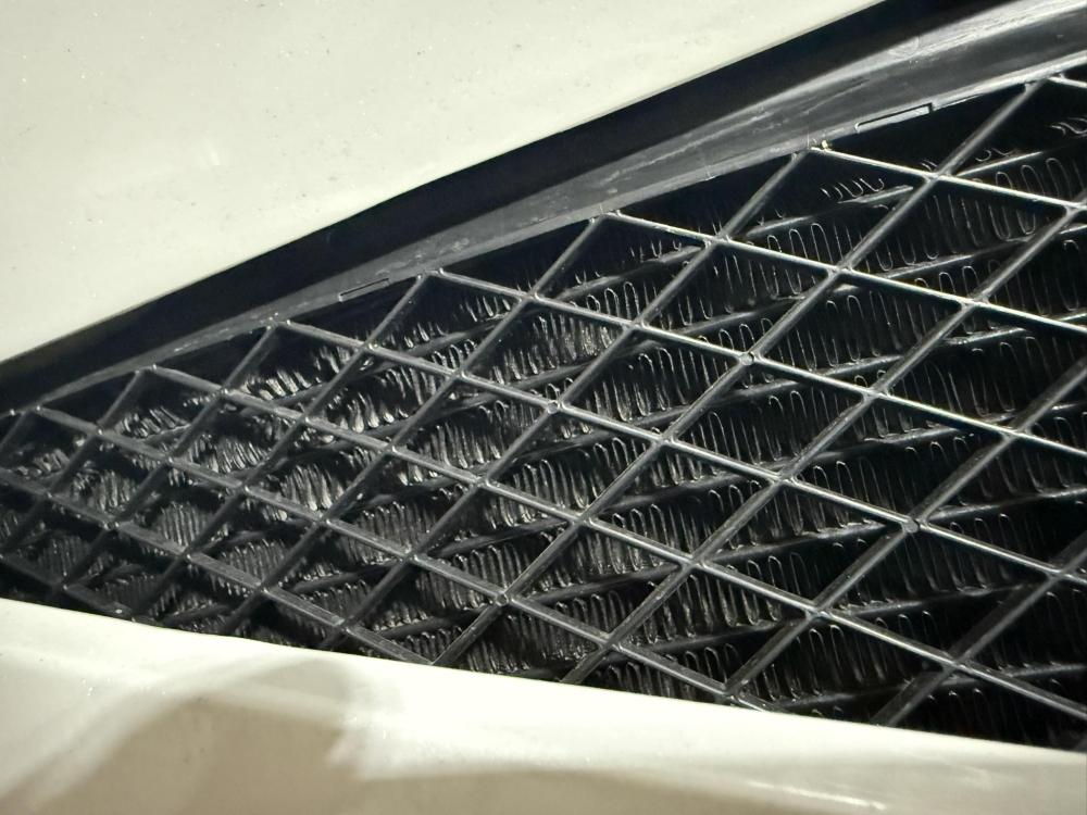

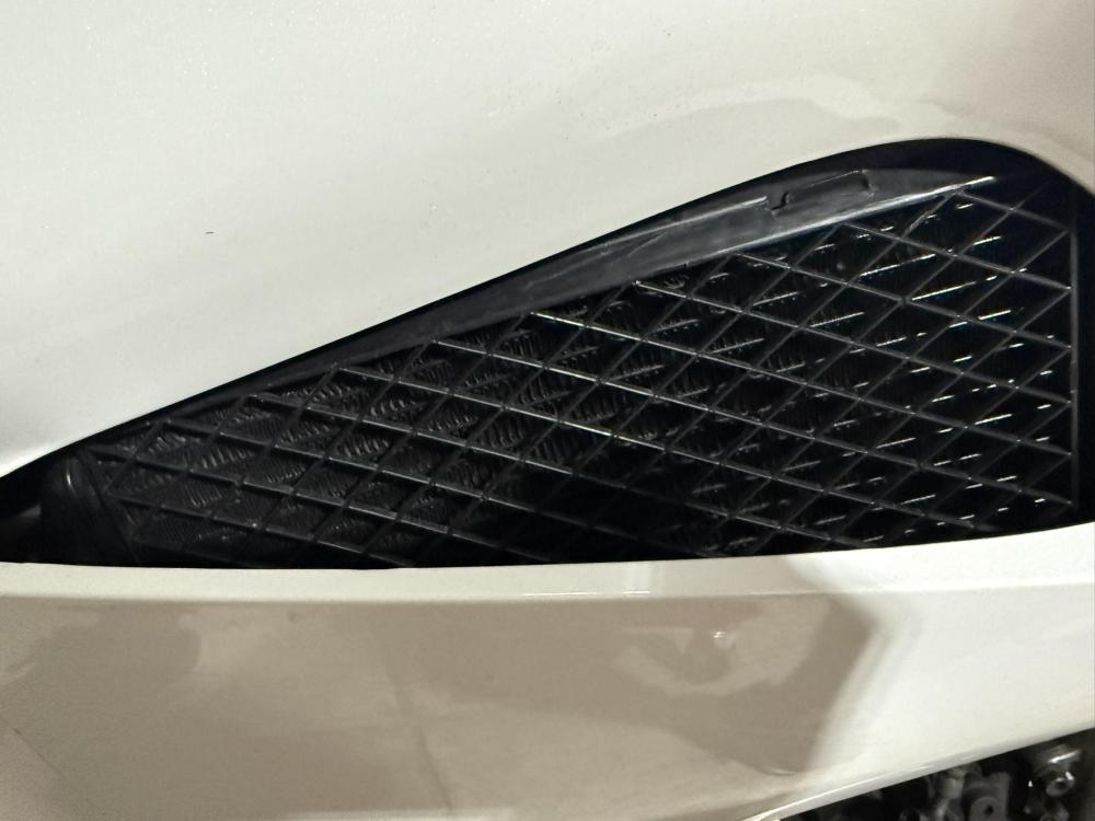

The other item is the right side radiator. It looks like it might have taken some impact but I won't know fully until I get the right cowl off and inspect.

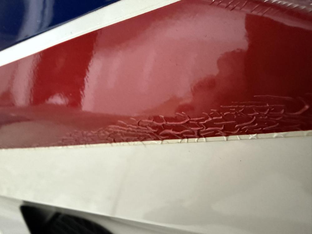

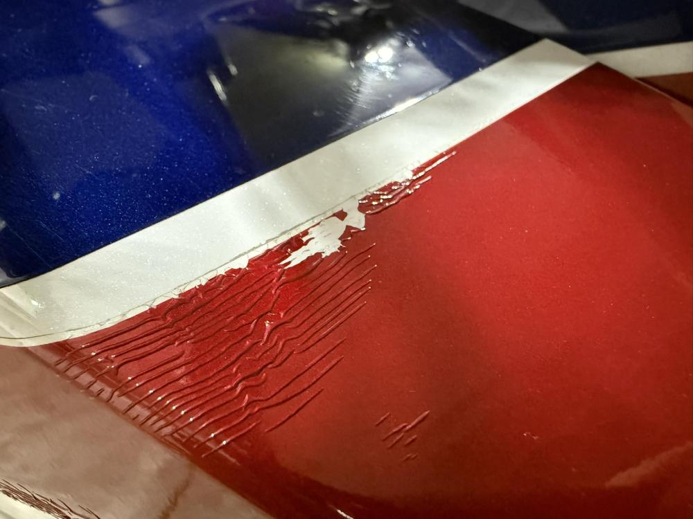

The last thing I noticed was that on the left side cowl, the red stripe has some bubbling in it... not sure what's that all about but probably need to replace that decal as well.
