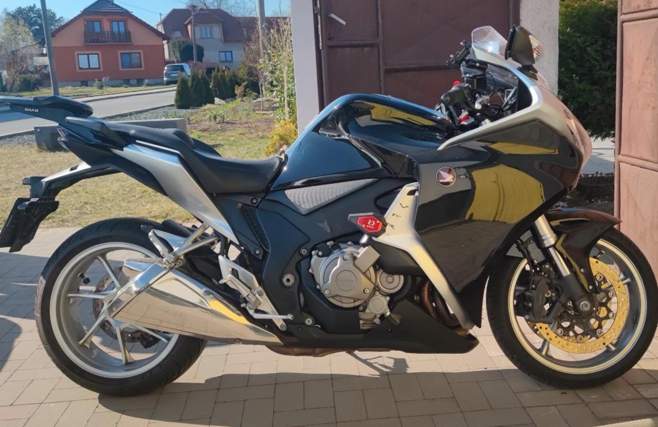

I have a VFR1200FD 2013 in the EU
The only changes I have made are..
Sabsteef ECU flash (well worth it)
LSL flat bars and peg lowering kit (I’m 6ft 4) increased touring comfort significantly) ruined the looks but vanity is not my thing.
Lower screen as no matter what size screen I bought the wind hit me right in the head!
LED light headlamp kit (huge improvement over stock)
