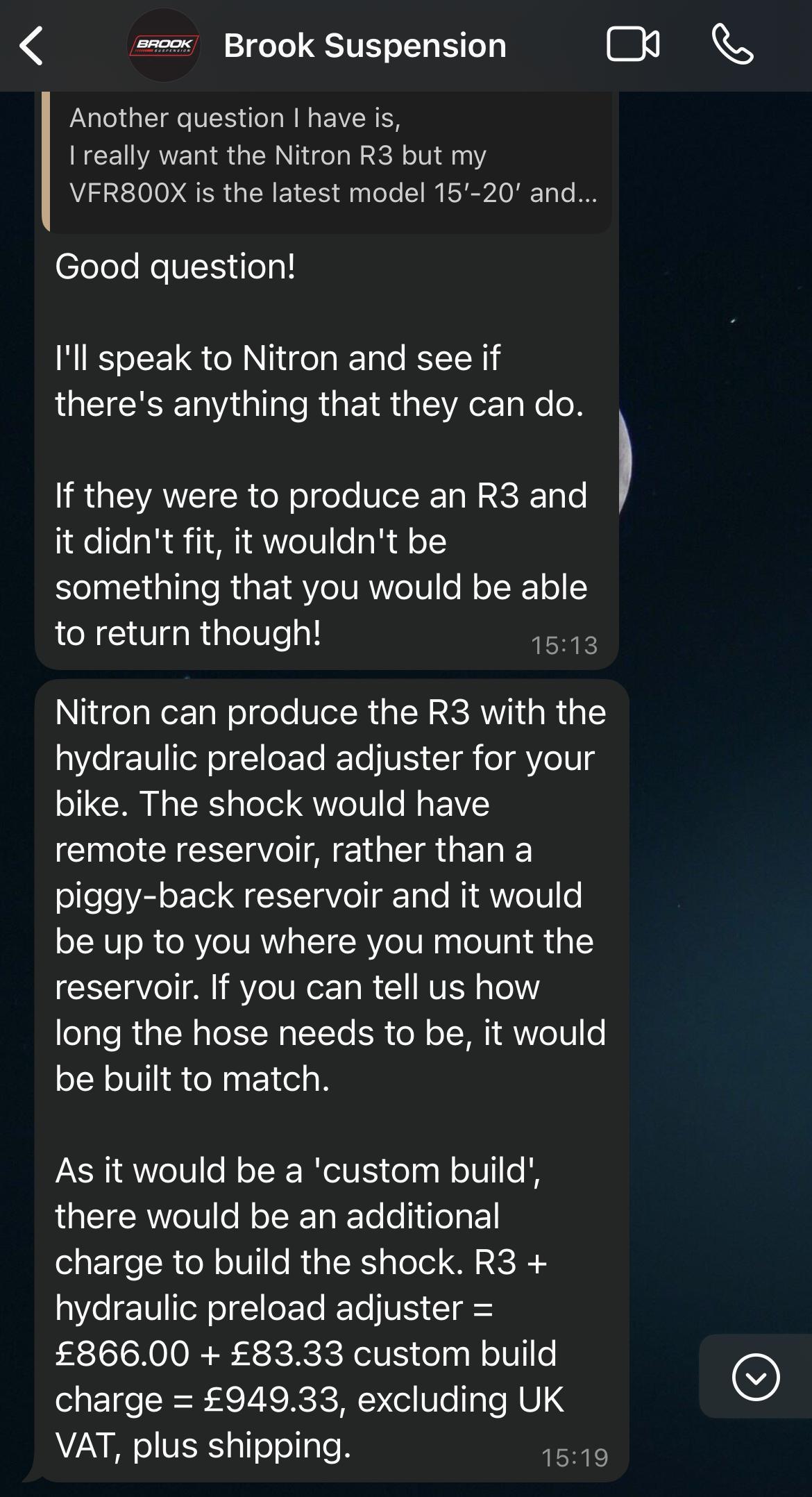

Member Contributer Morados Posted March 6, 2025 Member Contributer Posted March 6, 2025 On 3/4/2025 at 10:01 PM, Sunde said: Indeed thats what i'v gathered aswell, is yours a 2011-2014 model? In that case you can get the more advanced shock that you speak of. For some reason (im guessing room) the 2015+ "only" gets the R1 as an option. I'v also added the remote preload adjuster, a very pricey addition, but lawd i want it haha. I'll post pics once i have it, install seems to be pretty straight forward. I have the latest VFR800X model so the R1 stock option is the only available but I spoke to Brooks suspension and Nitron and they could not get the R2 and the R3 remote reservoir to fit but they could add a lengthened hose for those reservoir if asked , they will charge extra £83.33 for this customization and no return. He did assure me the R1 uses the same quality components like coils, big piston and housing with only missing the separate adjustable high speed / low speed compression and rebound and instead combines it together when adjusting it. Right now I am still hesitating whether to get the much more expensive R2 / R3 or just go with the R1 which is already very good! 1 Quote
Sunde Posted March 9, 2025 Author Posted March 9, 2025 On 3/6/2025 at 5:59 AM, Morados said: I have the latest VFR800X model so the R1 stock option is the only available but I spoke to Brooks suspension and Nitron and they could not get the R2 and the R3 remote reservoir to fit but they could add a lengthened hose for those reservoir if asked , they will charge extra £83.33 for this customization and no return. He did assure me the R1 uses the same quality components like coils, big piston and housing with only missing the separate adjustable high speed / low speed compression and rebound and instead combines it together when adjusting it. Right now I am still hesitating whether to get the much more expensive R2 / R3 or just go with the R1 which is already very good! Really cool info, thank you so much! I'v gone an ordered the R1, i suspect i will be more than pleased with upgrade, even if i am slightly worried about the rebound/compression being a combined adjuster. I hope they get the valving right, otherwise i'll always be chasing one or the other haha. Quote
