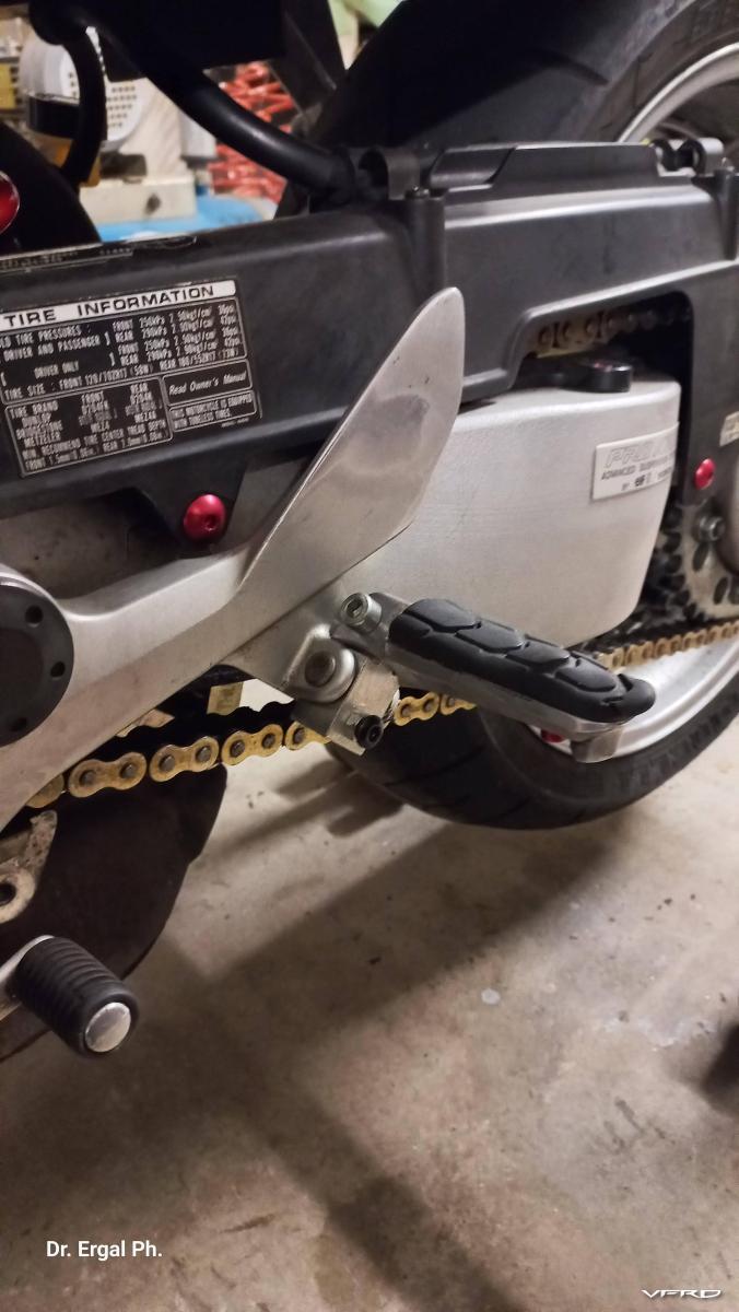

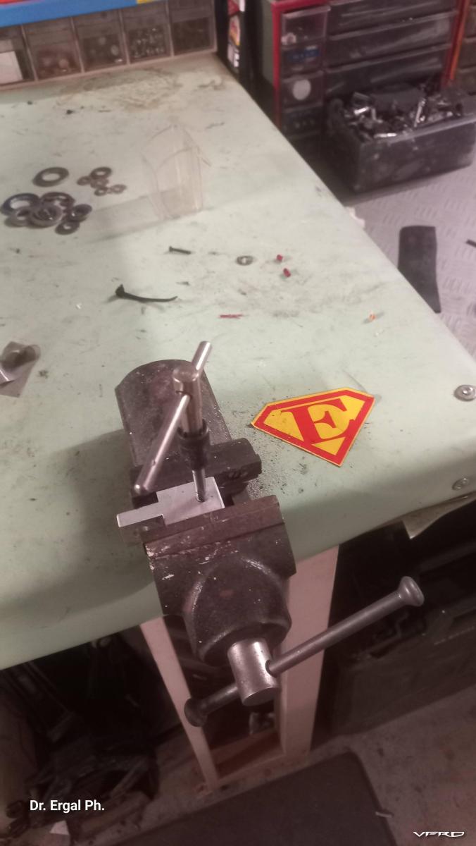

Just as a first experiment, I've made a set of risers to offset the position keeping the standard supports.
large.20250315_131907.jpg.2c96255314e3c1b4cf4ba53fbbc4b5e4.jpglarge.20250315_163909.jpg.f79dcb6e7780f5aabb8b6f08f96f7424.jpg
They're damn UGLY 😅 but it's just to get the feeling (I'm not in search of an exasperate race-style offset). After deliberating the final position, I'll design a monolithic solution as well as I did for my track XX
