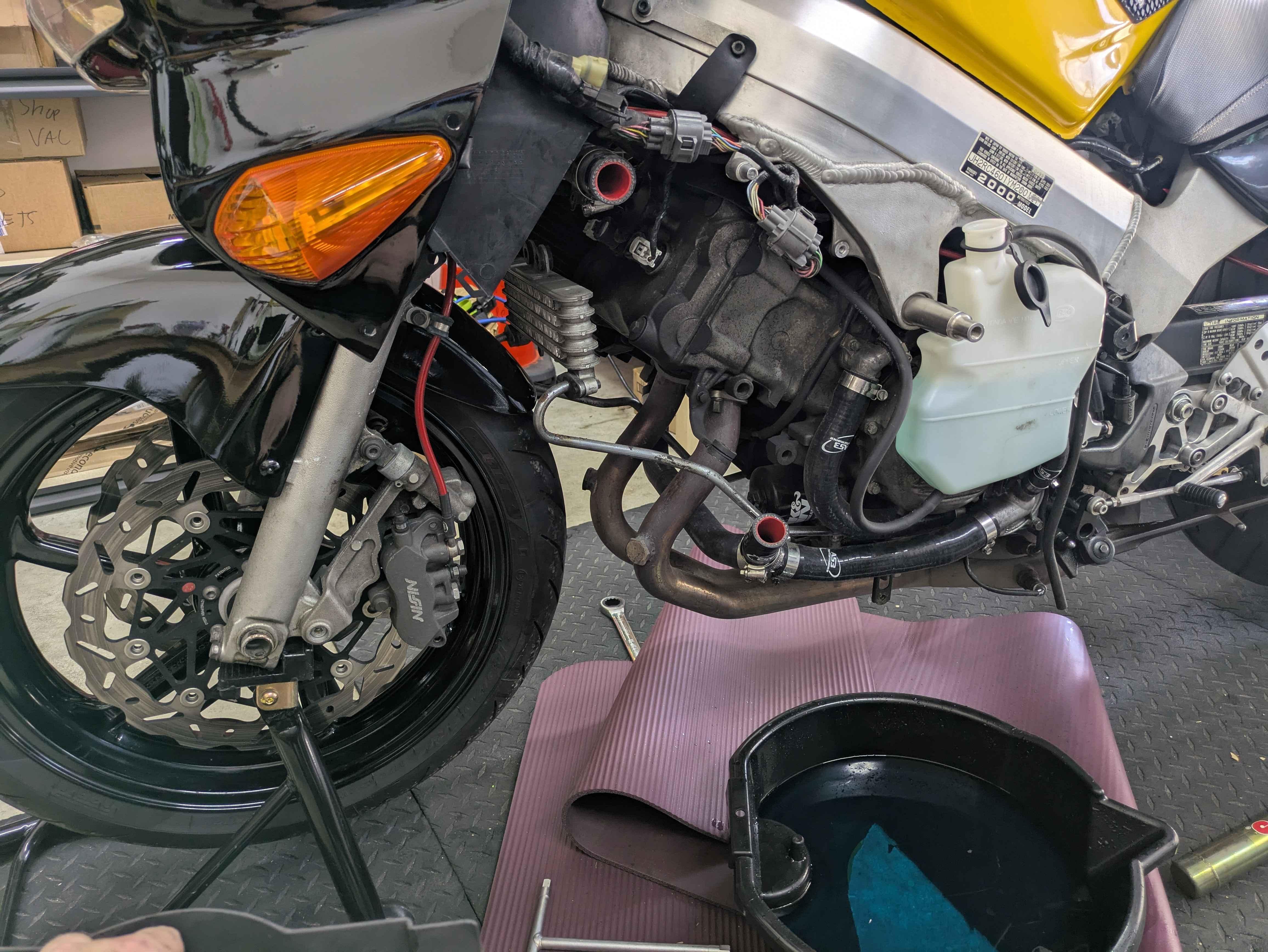

- side plastics removed & coolant drained.

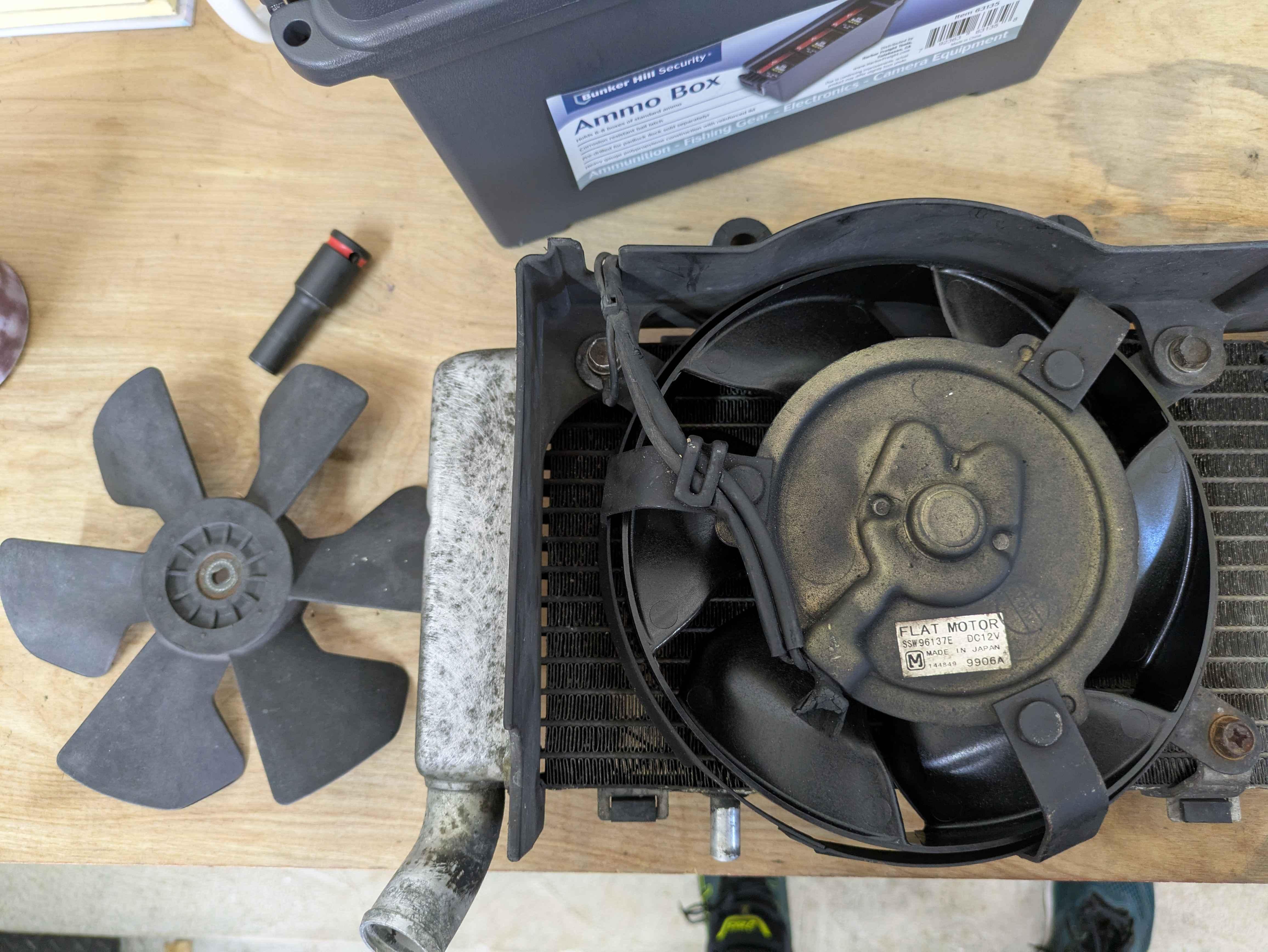

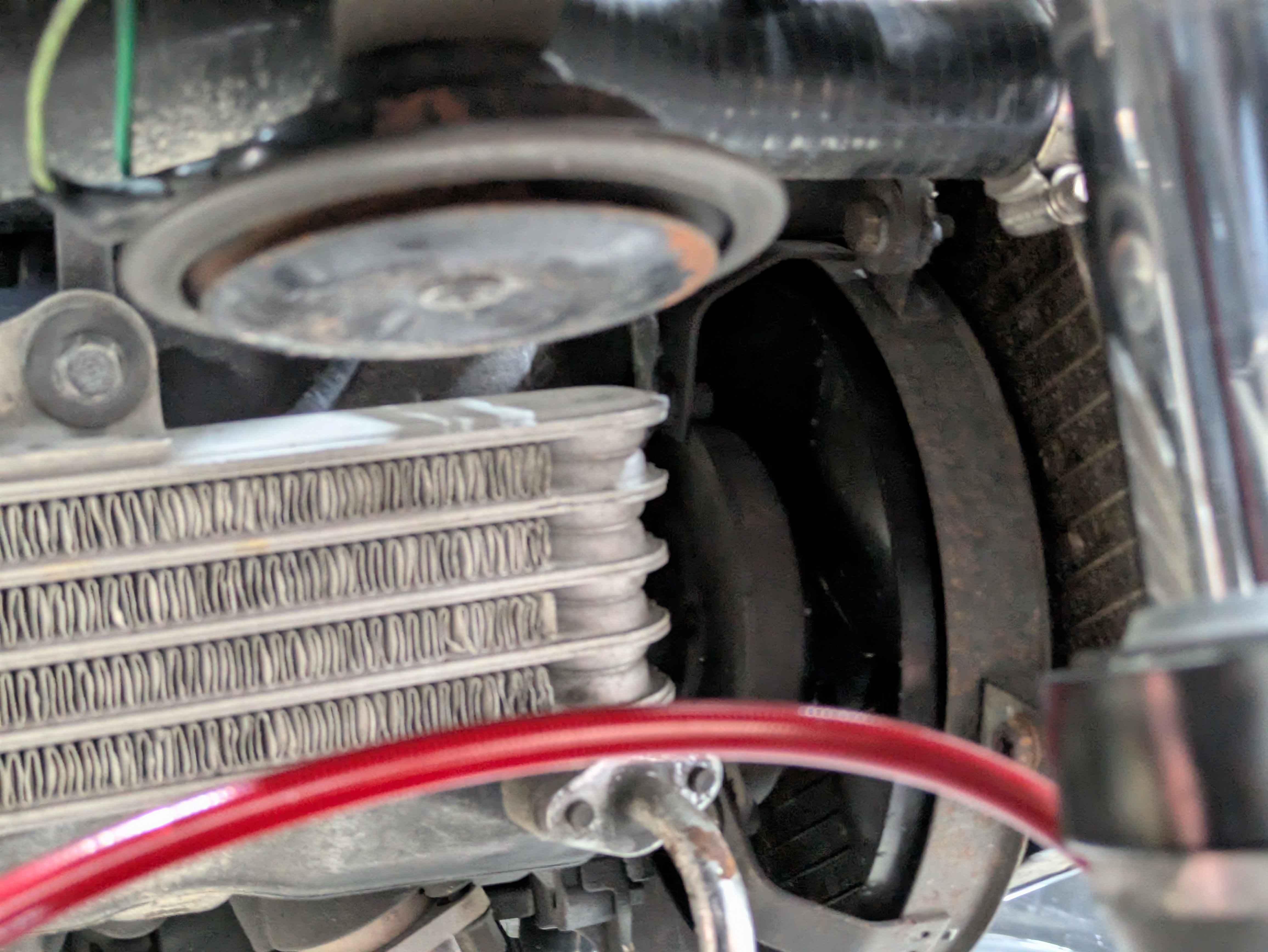

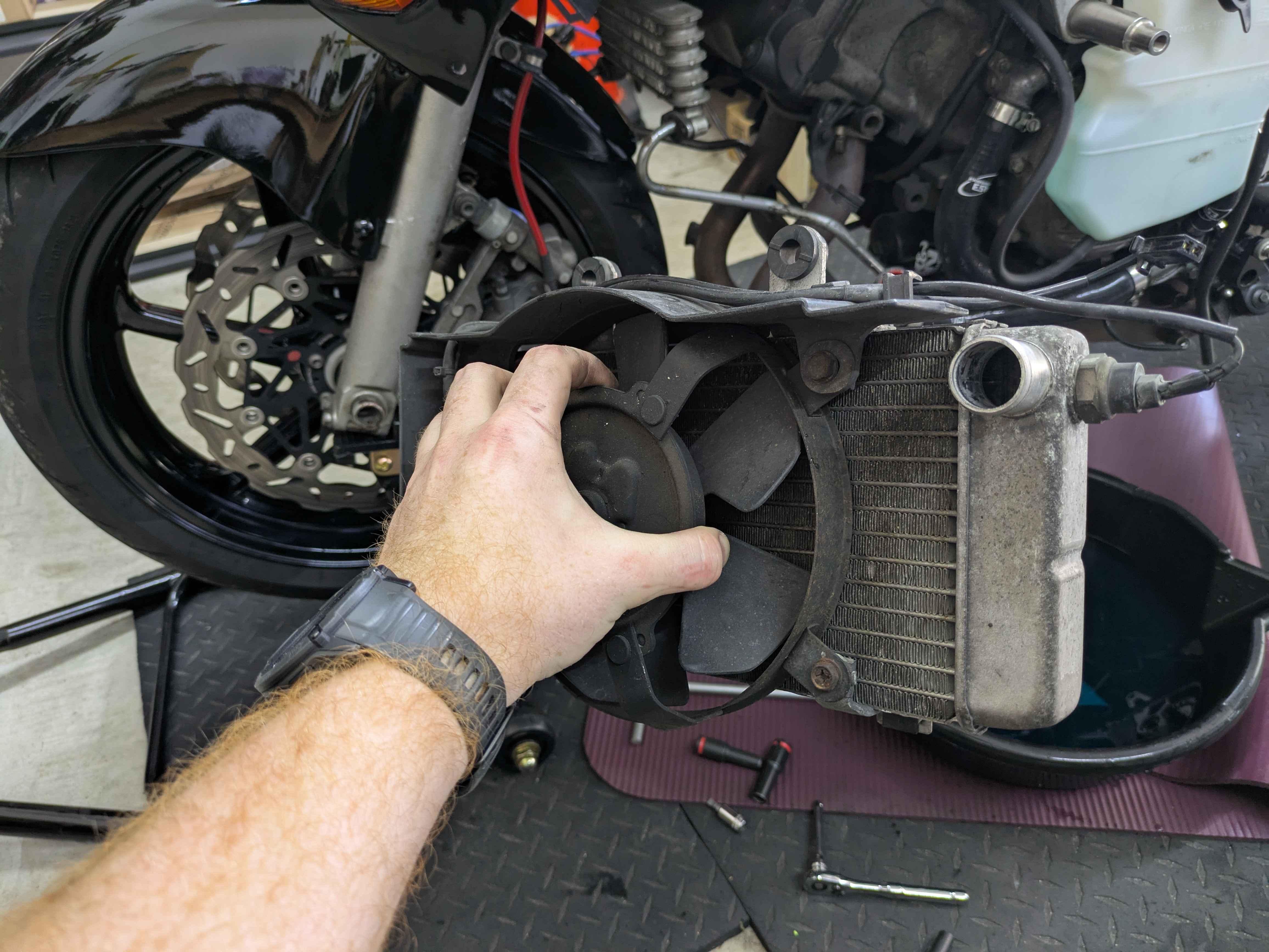

- Popped off the rad. Only one wire running to it.
PXL_20250208_183421967_MP.thumb.jpg.bb01d4a02b940dd593a9bd8e7d0261bd.jpgPXL_20250208_183424678.thumb.jpg.285954919fa3c897c46e1a92d0a8abf2.jpg

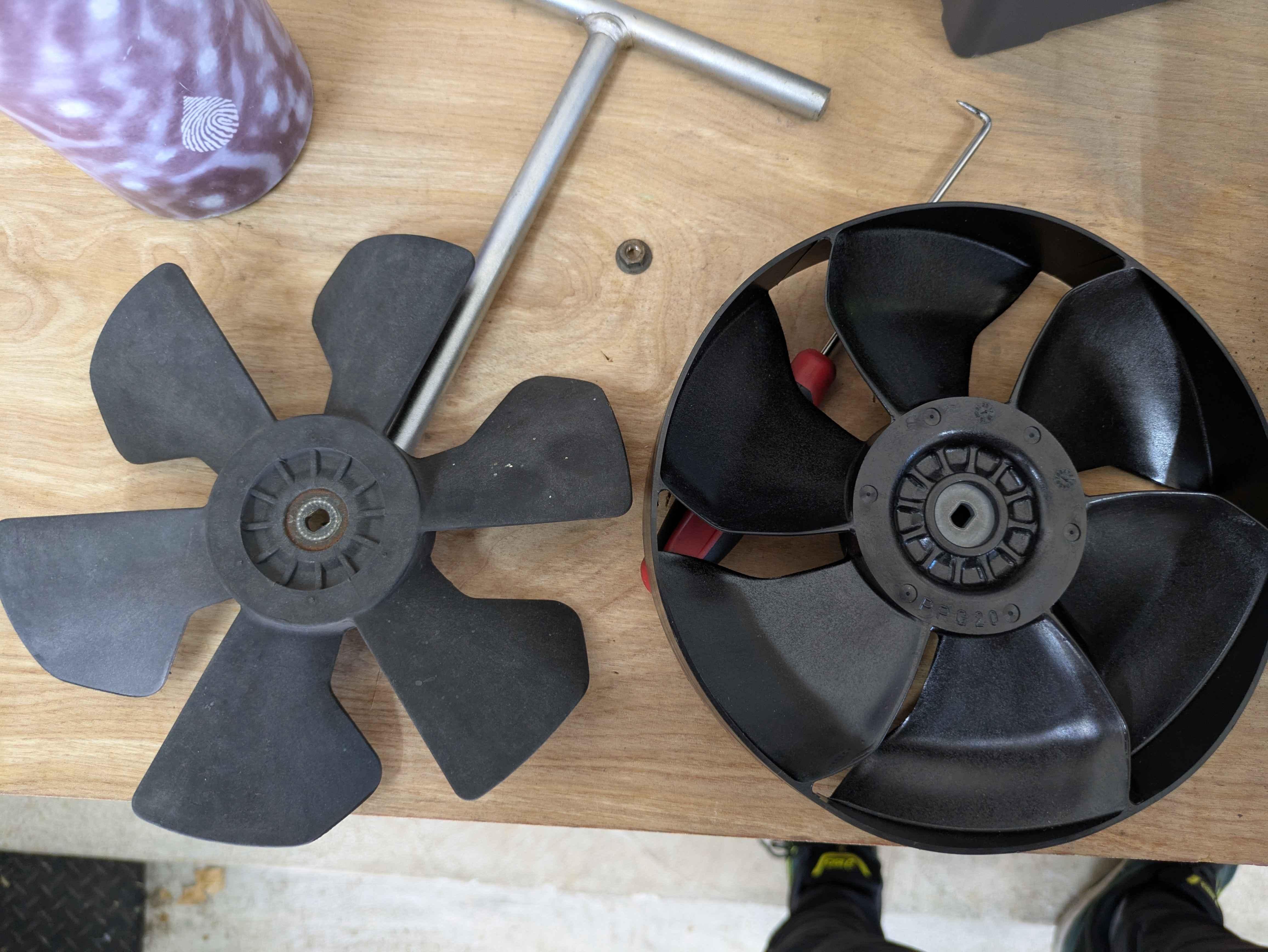

- side to side comparison

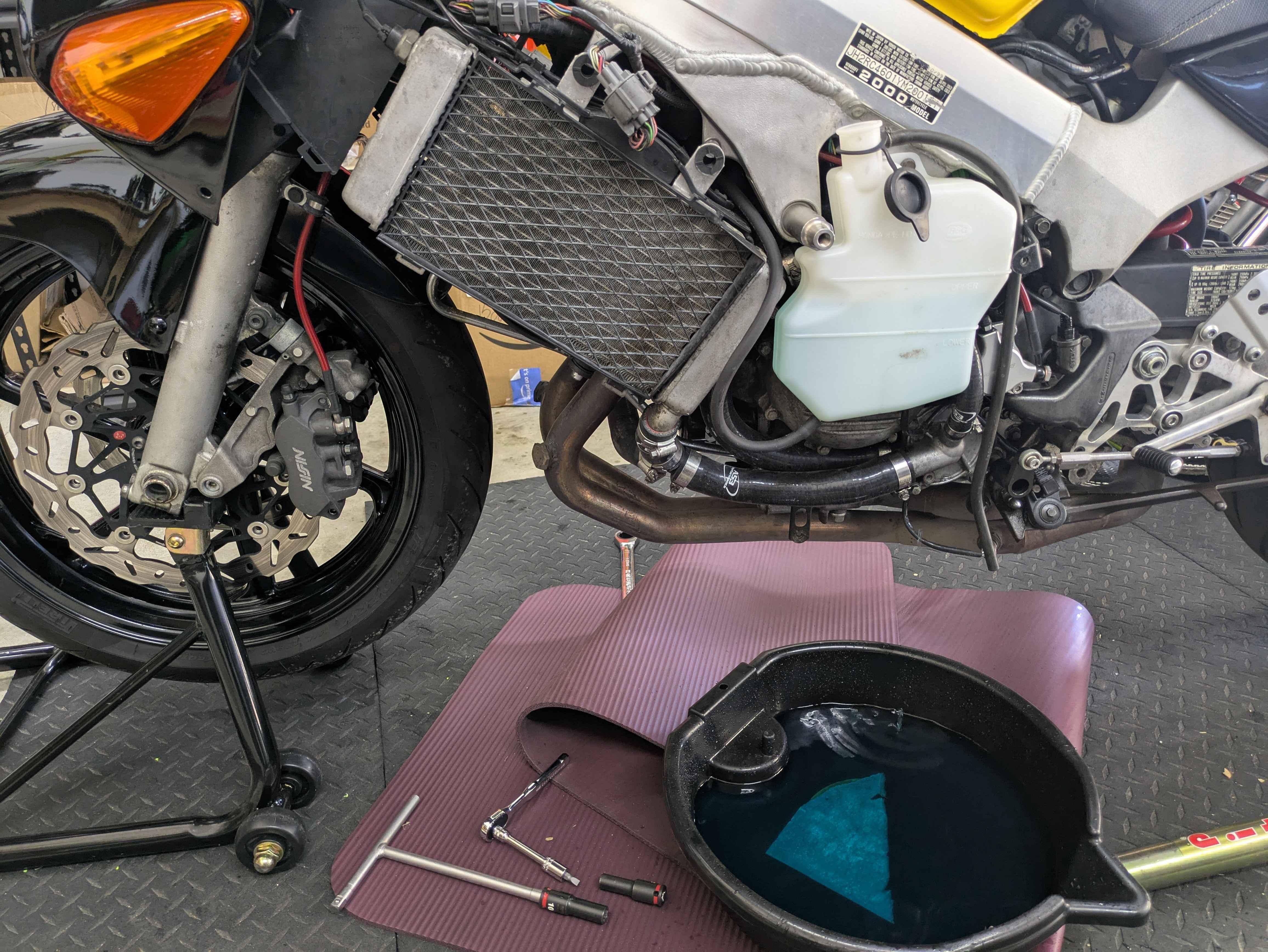

- installed PXL_20250208_185231394.thumb.jpg.b15efcc2478e15baa380de081277a86b.jpg
- and just like humpty-dumpty, it's back together againPXL_20250208_193436729.thumb.jpg.5eb9098cddfbcb664963506ac3deda9c.jpg
